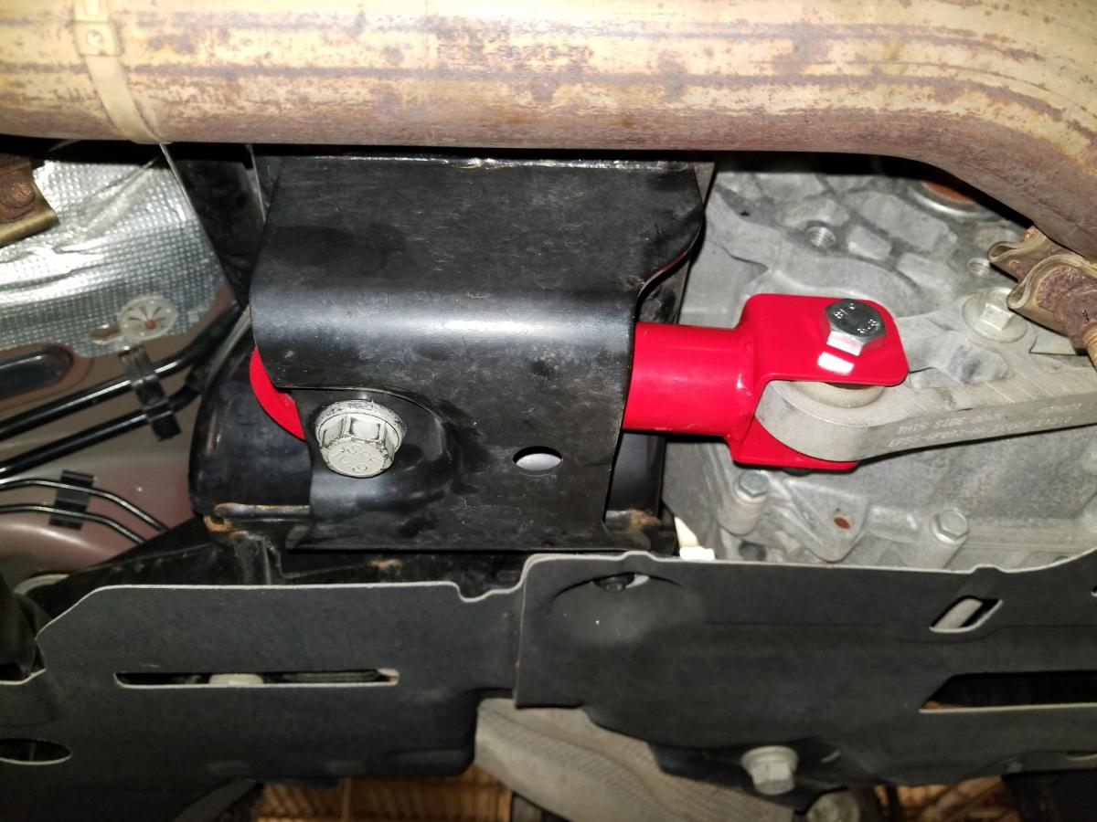

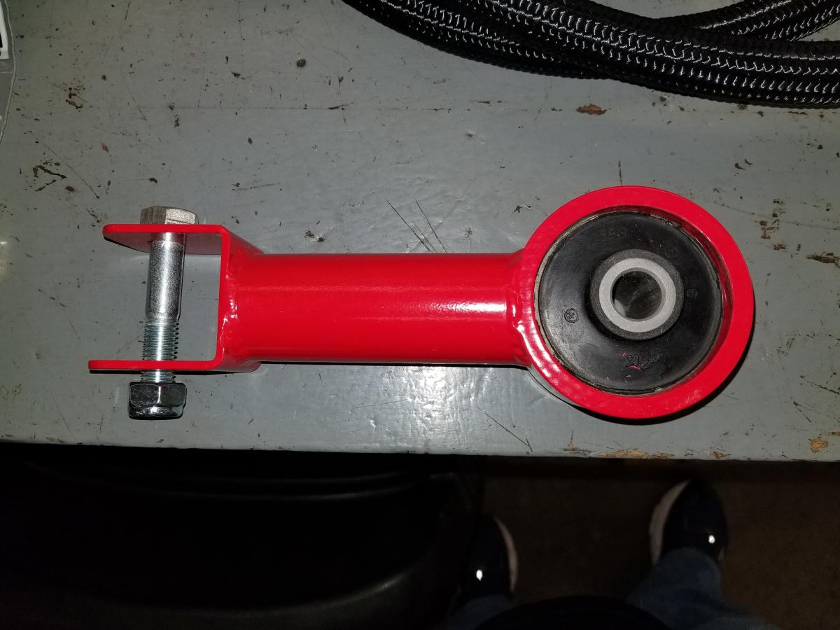

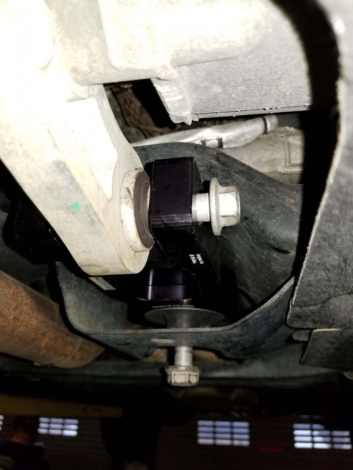

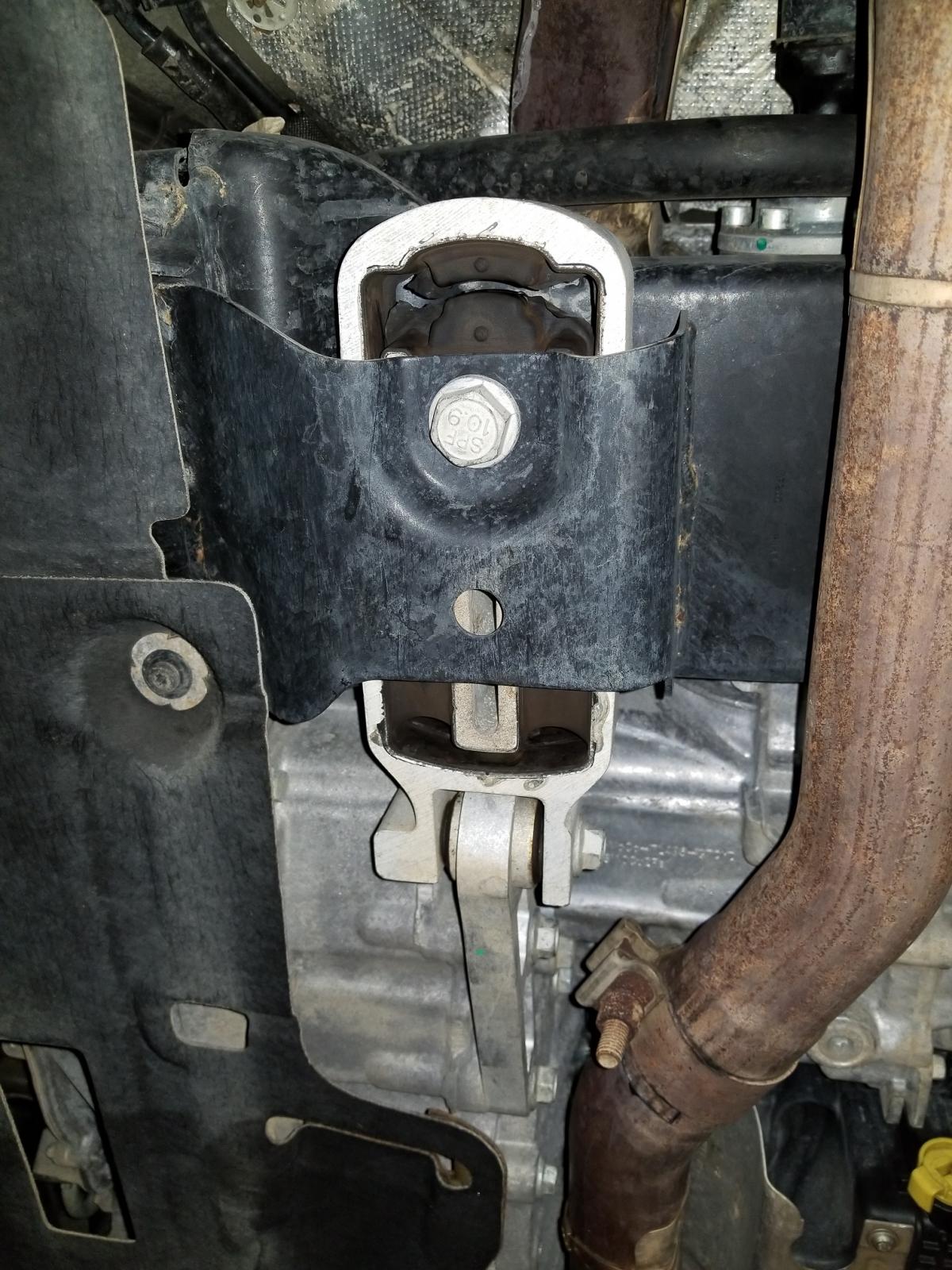

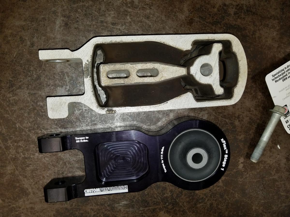

snmjim Report post Posted December 9, 2017 (edited) Contrary to popular belief and for those anxiously awaiting the CPe RMM it's finally available! :happy feet:It is true that CPe made the statement in the past that they weren't making any Edge Sport specific parts however, they've agreed to work with us to R&D any potential Fusion Sport parts that could be shared with minimal customizing, we are finally on the CPe radar... We completed fitment without an issue and are in the break in process using a 2016 Edge Sport AWD. It's an 80 Duro bushing and so far there's more vibration (NVH) being fed back to the passenger compartment as would be expected over the stock RMM.http://cp-e.com/shop/fordhttp://cp-e.com/shop/product-category/ford/ford-edge-2-7tt-15-18/There's no need to do a "How To" for this since it's only two bolts and it's as simple as the Pics show... Pics:- Stock mount- CPe mount- Comparative of the two- Installed Pics- Ultimate Performance RMM (red) used by BishopUpdates: - NVH was resolved with CPe by updating the RMM with a 60 Duro bushing. The 60 Duro bushing gives a pleasant positive power train connection along with a comfortable NVH factor. A major positive difference from the 80 Duro. CPe claims their RMM is currently used on vehicles with over 1000 hp of which we'll never see on this platform. This concludes our RMM study. Sig Line: There's a point at which you have to realize that the pig is enjoying the mud wrestle... Edited May 27, 2018 by snmjim 2 Share this post Link to post Share on other sites
