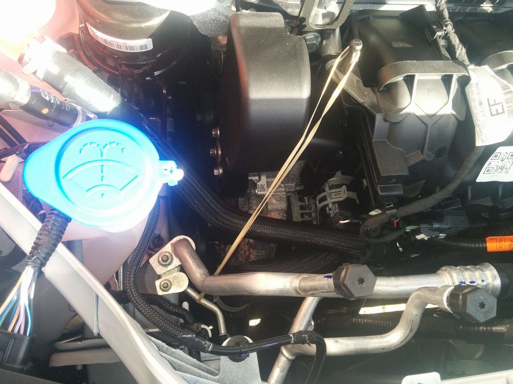

I did however get a rubberband ??? which was put on prior to the trans cooler line being connected.. ..see the pix.. I see the engines are made in Spain. so it might be a Spanish thing..
They have been eliminating the appearance cover on various Ford models since at least the 2017 MY.  Not surprising your 2019 does not have one.  Why?  IDK.  Cost cutting probably, or too many warranty claims from people breaking them off during removal LOL.
