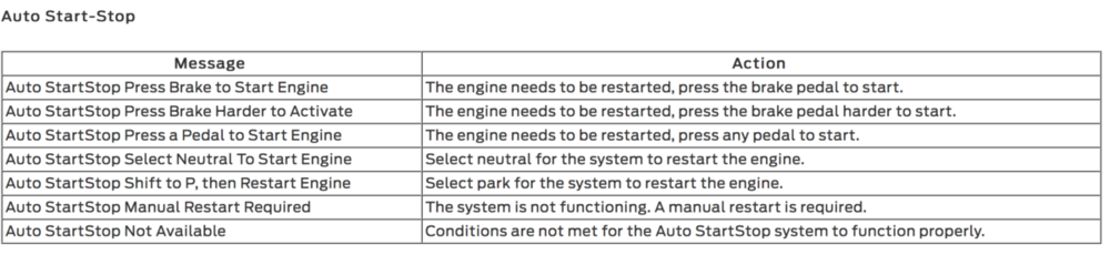

I find that with low outside (or cabin) temp, Start/Stop doesn't 'work'. It is working just trying to get the cabin warm. I will turn off the Climate. If you are curious to the reason, use the left display screen and go to the Fuel Economy screen (last in the listing).
Here are the possible messages.

Auto Start / Stop solved.
There is a screen accessible from the Fuel Economy selection on the menus on the left side of the dash display that is specifically for Auto Start / Stop.   When I accessed it, and stopped at a light, a message popped up that the engine was on because the power point was in use.
The power point in this case is the 110 volt power point, which I have the laptop charger plugged into.   Unplugged it, and sure enough, auto start / stop worked as it should.
