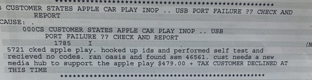

They said I need a media hub which is $400
Effin ridiculous! Order the USB hub and install it yourself. If you do not feel comfortable doing it, try a car stereo shop.  I cant see a car stereo shop charging more than $50 for the installation and thats asking a lot!
1 hour ago, HockeyShot39 said:
Just picked the car up form ford and he said it’s more than the USB - he said it’s a whole computer?
Most probably got that answer back cause the search/inquiry in the oasis system is based on the Car VIN and as built info, which would have indicated Sync 3 not being installed on the vehicle.
Since you've done the upgrade yourself, you just need to get the USB HUB and do the swap

27 minutes ago, jmr061 said:
OP said he has a 16 Edge Sport...those all came with SYNC3 from the factory.  The software just needs to be at 2.0 or higher and the hub installed.  $479....wtf are they smoking.
Third post in this thread he mentioned, unless he meant Sync 3 V2.0 upgraded to Sync3 V3.0
On 8/19/2019 at 8:53 PM, HockeyShot39 said:
No I just bought the car. It was in sync 2.0 and I upgraded it, but has no apple car play
In any case, the SSM quoted by the tech says that V 2.0 is required for it and  not V3.0 - but it does mention an update to APIM could be needed.
Sync 3 V 2.0 was release July 2016 and was the first version of Sync 3 to support Apple Carplay and Android Auto
SSM 46561 - May 3 2017 4769 - 2016 Ford And Lincoln MKX - SYNC 3 And Navigation - Apple CarPlay And/Or Android Auto - Customer Pay Upgrade Available
Some customers with 2016 Ford/Lincoln vehicles with SYNC 3 and Navigation may request an upgrade for Apple CarPlay or Android Auto. In General settings and about check if v2.0 is present. If V2.0 is present no software update is needed. Apple CarPlay requires a new Media/USB hub to be installed. Refer to GSB for Apple CarPlay Android Auto upgrade. Follow WSM, Section 415-00 to update APIM if needed. After Installation Complete pop-up, follow PTS instructions and perform a complete ignition cycle by turning the key off for 5 minutes which is critical for a successful installation. The software and hardware upgrade is customer paid as it is not a warrantable repair per the Warranty And Policy Manual, Section 3, Warranty Coverages – SYNC.
