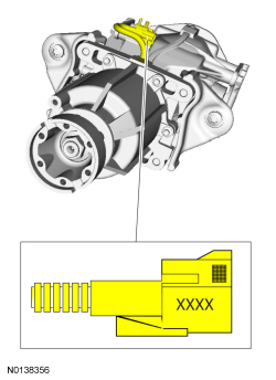

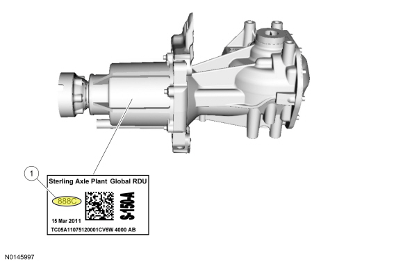

Haz Posted September 9, 2022 Report Share Posted September 9, 2022 From the 2013 Edge Workshop Manual... AWD Bar Code Identification The AWD system on this vehicle is equipped with a bar coded ATC solenoid to reduce the tolerance of electrical current to torque delivered to the ATC solenoid. The active torque control coupling solenoid bar code can be found etched on the active torque control coupling solenoid wire harness connector protruding from the top of the rear drive axle. The PCM uses this bar code information to match the clutch characteristics of the active torque control coupling solenoid with the desired output torque. If the bar code information does not match the PCM information, driveline damage or driveability concerns can occur. Therefore, if the rear drive axle needs to be replaced, the PCM will need to be configured with the ATC solenoid bar code information. Carry out the AWD Drive Cycle. Item Description 1 ATC solenoid bar code AWD Drive Cycle Carry out the AWD drive cycle after downloading the ATC solenoid bar code information to the PCM. NOTE: Always drive the vehicle in a safe manner according to driving conditions and obey all traffic laws. Carry out 3 accelerations from 0-48 km/h (0-30 mph) in a straight line. Perform this procedure at low, medium and full accelerator pedal position. Verify that there is no perceived front wheel slip. On dry pavement, drive the vehicle at 8 km/h (5 mph) in a fully locked turn. Verify that there is no driveline binding. And... Automatic Torque Coupling (ATC) Configuration NOTE: This procedure only applies to vehicles built after 7/30/2012. NOTICE: If the ATC bar code information is not correct, RDU damage or driveability concerns can occur. Using the scan tool, under the toolbox icon select Powertrain then select ATC Barcode Entry. Follow the instructions displayed on the scan tool. For an aluminum cover Rear Differential Unit (RDU), enter the 4-digit numeric bar code found on the label located on the side of the RDU. The scan tool verifies the digits entered are valid and displays a message if the information is not valid. For a steel cover RDU, enter the 4-digit numeric bar code found on the label located on the harness tag. The scan tool verifies the digits entered are valid and displays a message if the information is not valid. Carry out the AWD drive cycle. Good luck! 3 1 Quote Link to comment Share on other sites More sharing options...

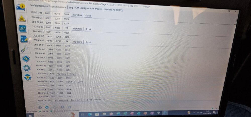

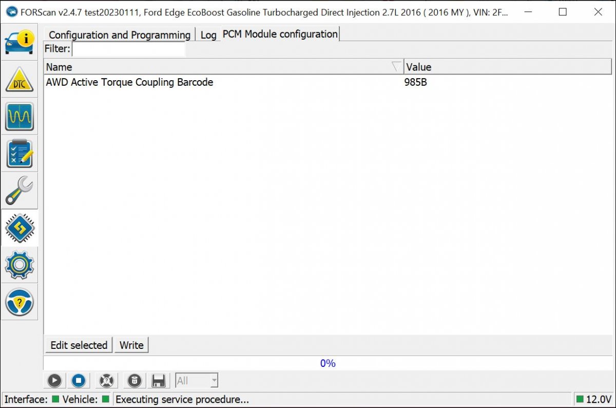

omar302 Posted February 18, 2023 Report Share Posted February 18, 2023 So, I got some screenshots from ForScan to show where to program the rear Axle Code (Automatic Torque Coupling (ATC) Configuration). It is under PCM "Module Configuration". 1 1 Quote Link to comment Share on other sites More sharing options...
Trickynick7 Posted February 29 Report Share Posted February 29 Looking for suggestions. once I enter the new differential code into Forscan it gets to 99% and then gives me a incompatible configuration error. anyone else have this problem. I'm entering the 4 letter code on the new differential. Quote Link to comment Share on other sites More sharing options...
