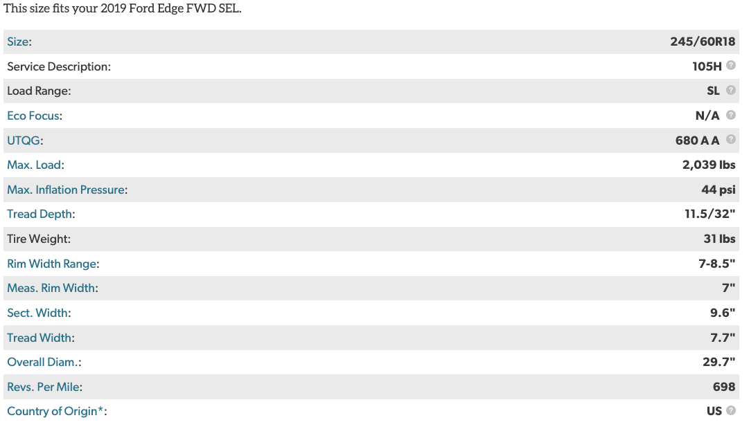

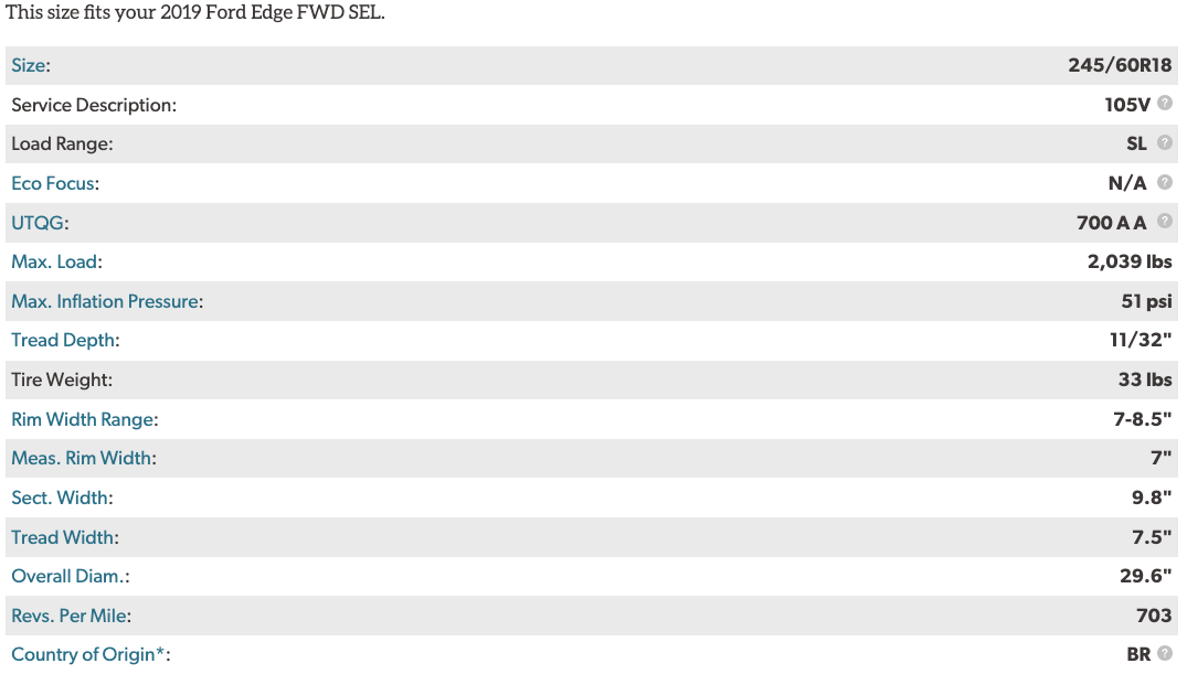

dabangsta Posted January 17 Report Share Posted January 17 They are not all the same! There are some many factors. While diameter is important, what that diameter does, how many revs per mile, is sometimes easier to see the differences. 2 randomly picked tires that tire rack shows the actual specs for (not the generated from published sizes). I don't think you understand section width versus tread width, and how that can affect the ratio (that 60 in this example which is a percentage). 1 Quote Link to comment Share on other sites More sharing options...
