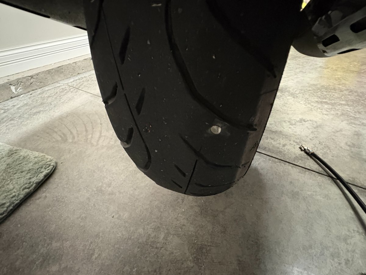

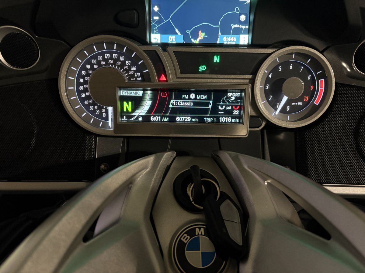

1004ron Posted July 28 Report Share Posted July 28 What a coincidence - this morning as I pulled off my driveway onto the road I got a Tire Pressure warning - pulled back into my garage and found a nail embedded in the rear tire. Switched to my Edge for the drive to work and will repair the bike tire when I get home. 1 Quote Link to comment Share on other sites More sharing options...
