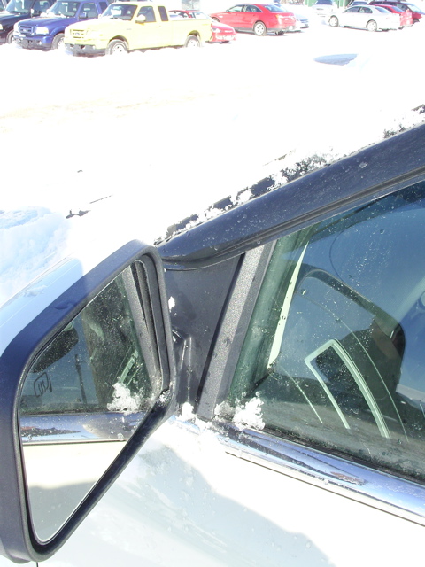

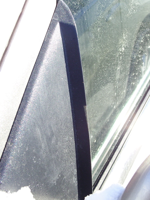

RE I would like to see the differences between the mirrors/bumps, the diferrence is that the bigger "bump" appears to have the same width, height, profile and location as the smaller one(picture), but it runs from the top to the bottom of the mirror mounting plate
Edited by Theakerr
Stopped by my dealer again today and found that model year info I was given re the protuberance is wrong. Correct data are as follows:
2011 Edge - No data Would appreciate some from the thread participants
2010 Edge - Blind spot mirror Small protuberance as per my previous photo. 3 vehicles
2008 Edge - NO blind spot mirror. Full length protuberance 3 Vehicles
2007 Edge - NO blind spot mirror - NO protuberance 2 Vehicles
Salesman calls the protuberance an air deflector.
Attached pictures of the 2008 full length protuberance (just for nextime). Could not get pictures of plain mirror mount on 2007 (my poor camera skills)

My 2011 AWD Limited Edge has a "protuberance" but it does not run the full length from top to bottom. It takes up the middle 2/3 of the mirror mount

Dealership just replaced my driver side mirror with one from a edge they had on the lot. I'll give an update tomorrow once I get a chance to drive it. Dealer also did confirm that the plastic piece on the mirrors where added for 2011 to reduce noise. Quality guy took car for a drive with me and also determined the wind noise to be coming from the mirror. Hope it works.
