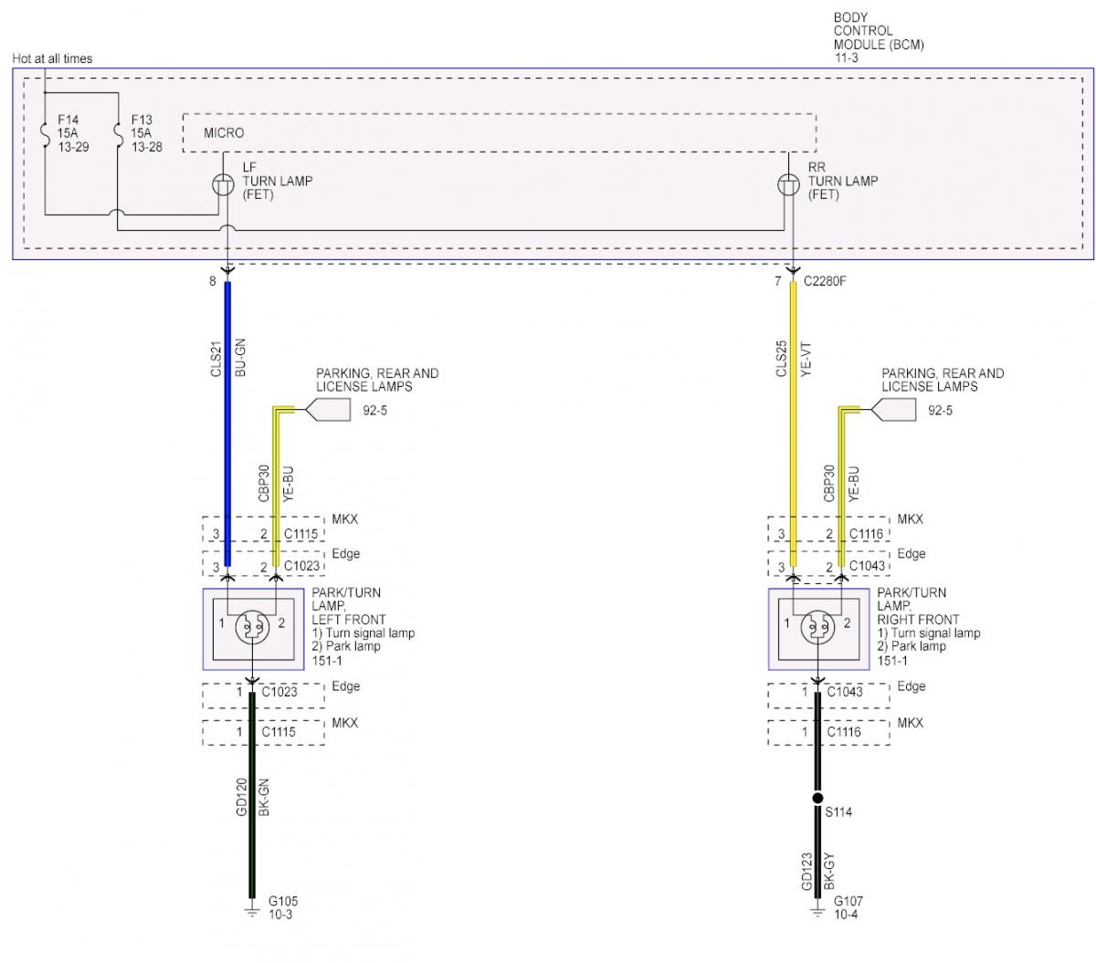

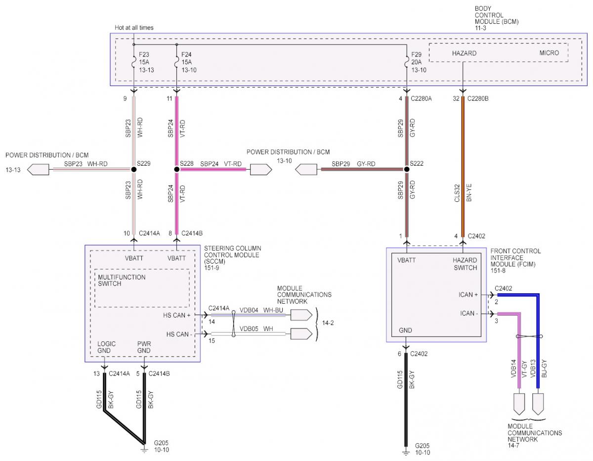

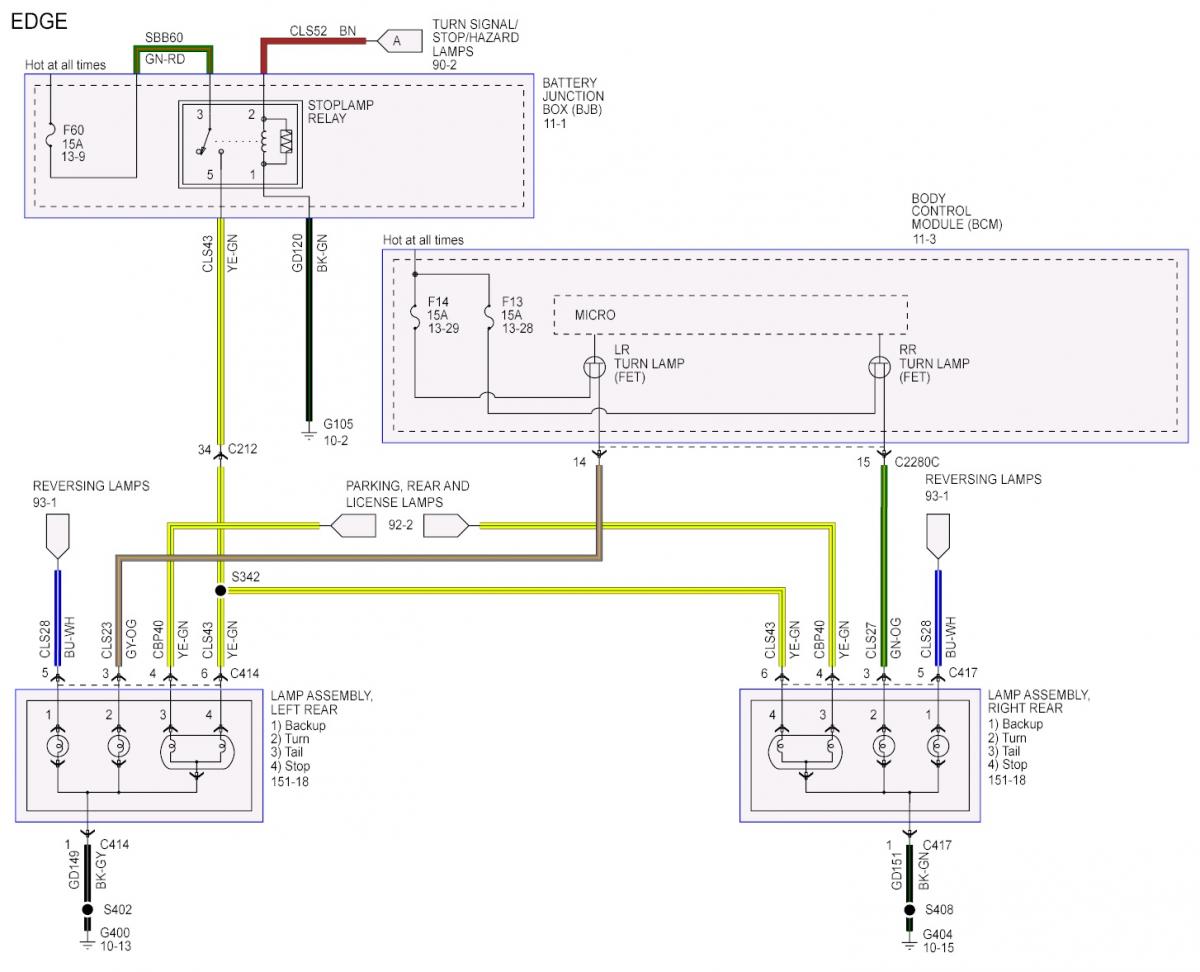

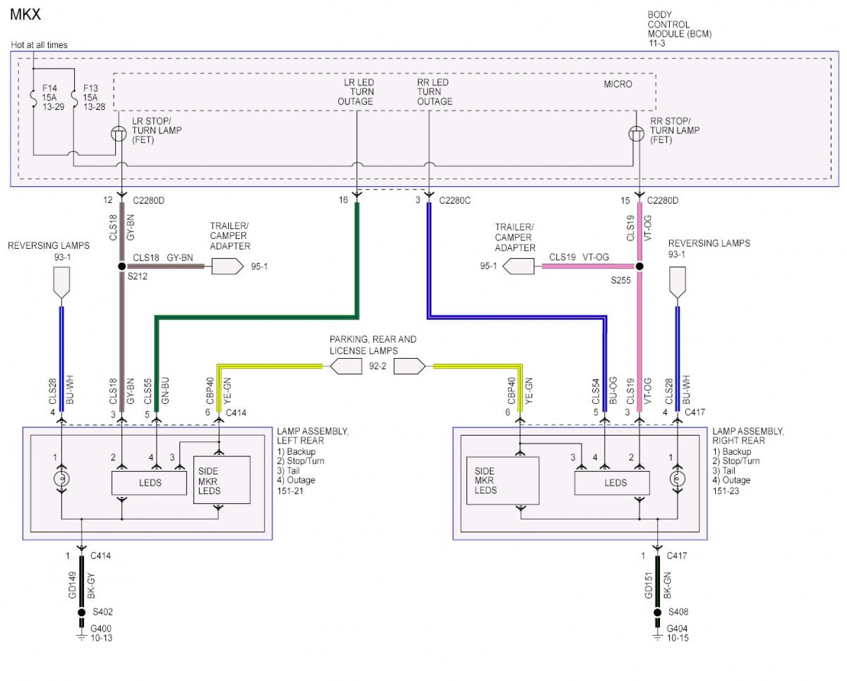

Hazard button doesn't work?
WWWPerfA_ZN0W replied to wes8398's topic in Audio, Backup, Navigation & SYNC
Fuses 13 & 14 in the passenger compartment panel are for the right/left stop lamps & turn signals. Might work with 1 blown fuse, but not if both are blown. Wiring diagrams for 2011 here: http://content.chiltonsonline.com/content/images/WD/Ford/1071/WD_Ford_1071128.pdf http://content.chiltonsonline.com/content/images/WD/Ford/1071/WD_Ford_1071129.pdf http://content.chiltonsonline.com/content/images/WD/Ford/1071/WD_Ford_1071130.pdf http://content.chiltonsonline.com/content/images/WD/Ford/1071/WD_Ford_1071131.pdf http://content.chiltonsonline.com/content/images/WD/Ford/1071/WD_Ford_1071132.pdf -
