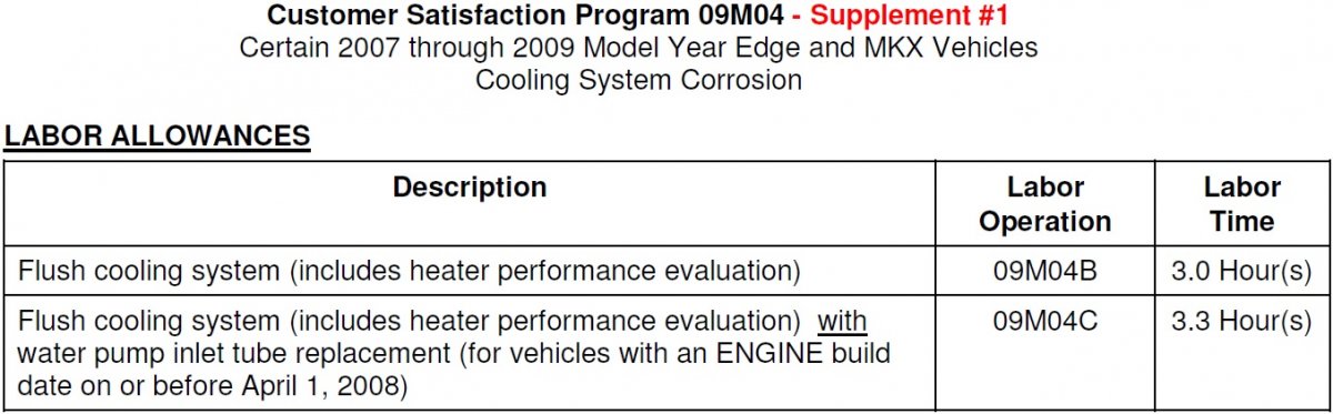

What coolant - Gold or Green
WWWPerfA_ZN0W replied to chotabeam's topic in Interior, A.C., Heat, Interior Trim
basically, the recommendation to change over to spec green was a result of this field service action from Ford 09M04 09M04-S1 Certain 2007 through 2009 model year Edge and MKX Vehicles - Cooling System Corrosion.pdf -
While the Gold is spec'd for early MYs of the Edge/MKX, it is NOT recommended anymore due to possible issues with the coating in the coolant crossover tube. This becomes a risk for a clogged heater core, which is an expensive job if you are not DIY'ing. -

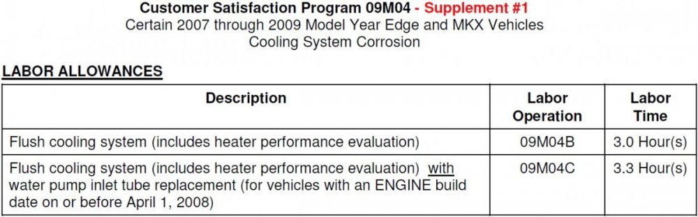

Motorcraft Specialty Green for any 2007-10 Edge/MKX. -
