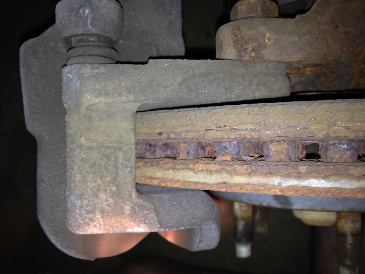

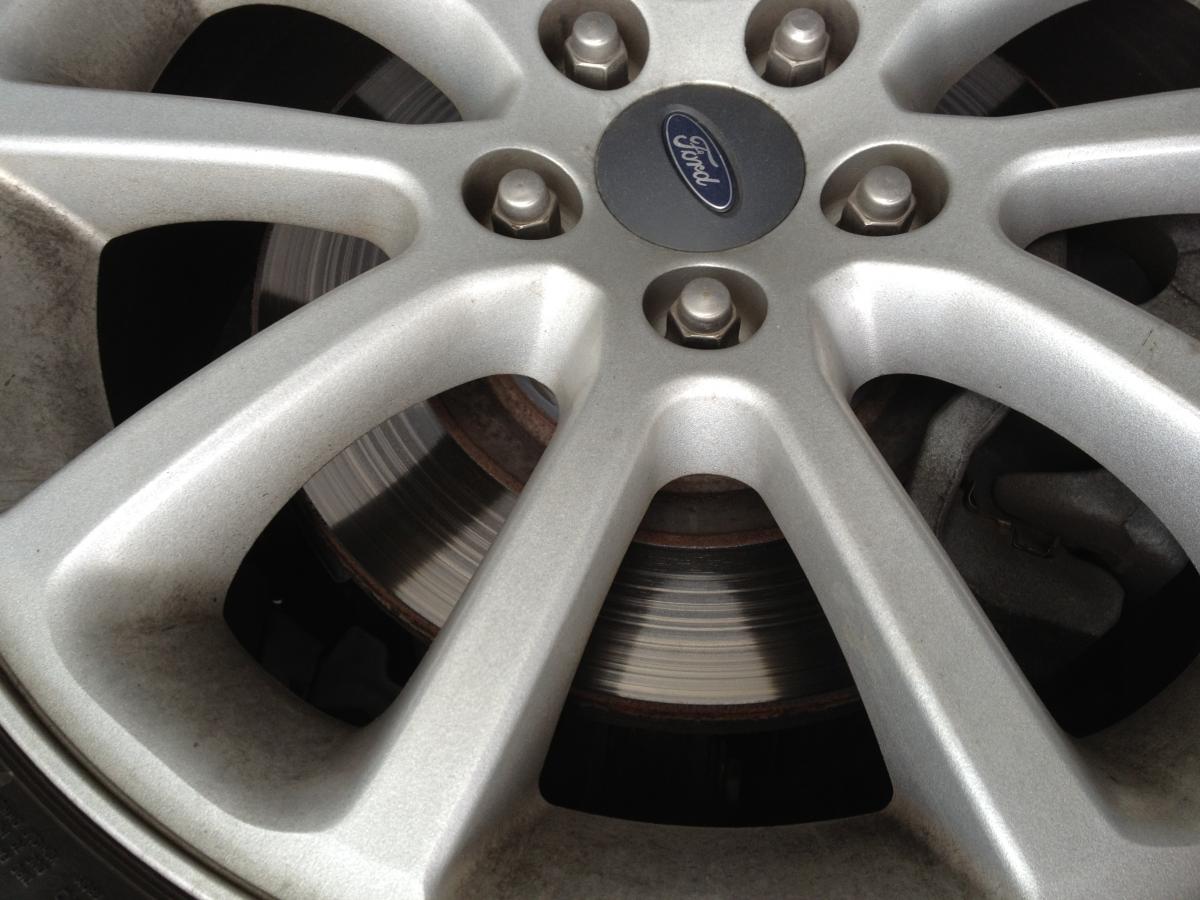

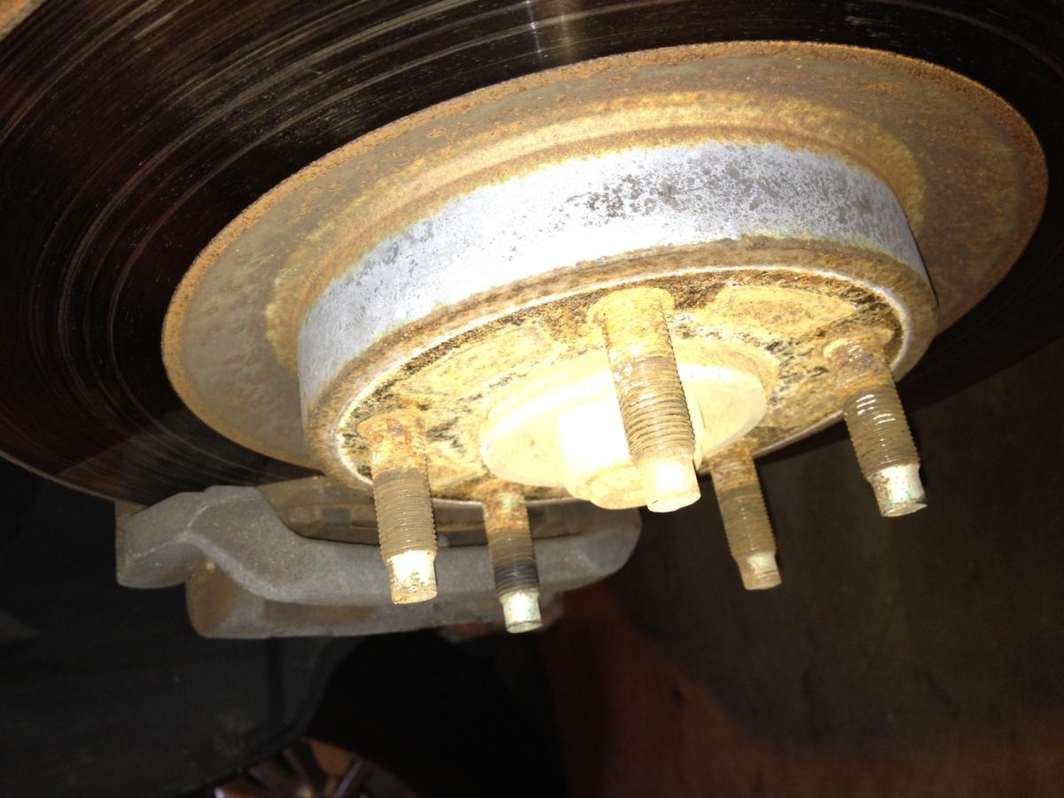

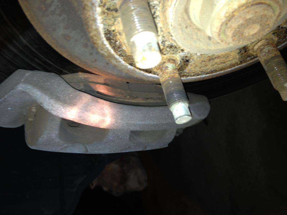

I've attached a picture of my front brake rotors on my 2007 sel. I noticed that the front rotors seem to have concentric rings on them, almost scratches, while the rears do not. Is this bad or does this mean it's time for replacement? Is there an easy way to tell if the front rotors or pads need replacement?

Run your fingernail across it - if it catches then it's a deep scratch that might need to be fixed. Otherwise it's normal cosmetic stuff. Pull the wheel and check the thickness of the pads inside the calipers.

Your pads look good. The rotors look like they were not turned the last pad change, no biggy, if you are not getting any grinding or shake in the front end. Looks like the Chicago salt is doing its thing on the bare metal. Probably normal for the area. A lot of brake jobs require new rotors now, when the pads are gone. I guess it is the price we pay for good pad material and stopping 4000 lbs. Yours looks like normal wear. Keep driving. Brakes usually last something in the neighborhood of 50 to 70K miles. If you are on the upper end you are doing well, just keep an ear out for the grinding sound.

Thanks for the help guys. While I'm in there changing my pads and rotors, is there anything else I should do which will increase the life of the system, such as greasing or lubricating anything? Maybe some anti-seeze on some of the bolts?
Do not apply anything to the bolts. It will screw up the torque.. You can add some grease where the wheels meet the rotor hat to avoid any corosion. Sometimes the wheel will stick.
