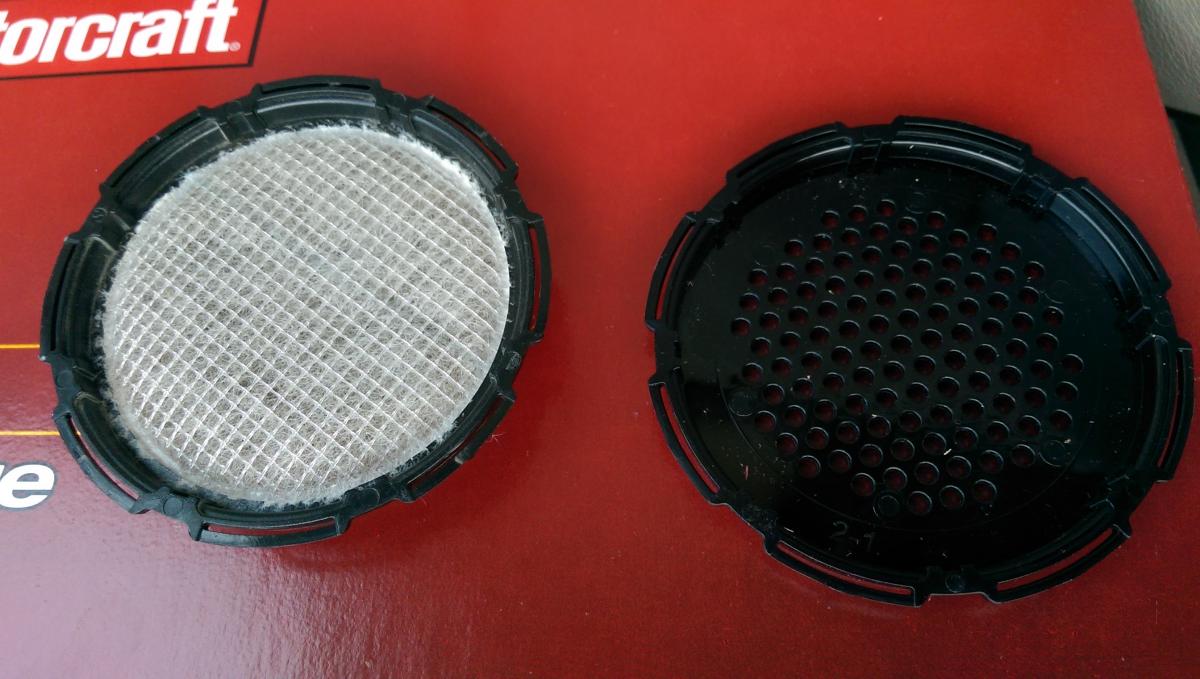

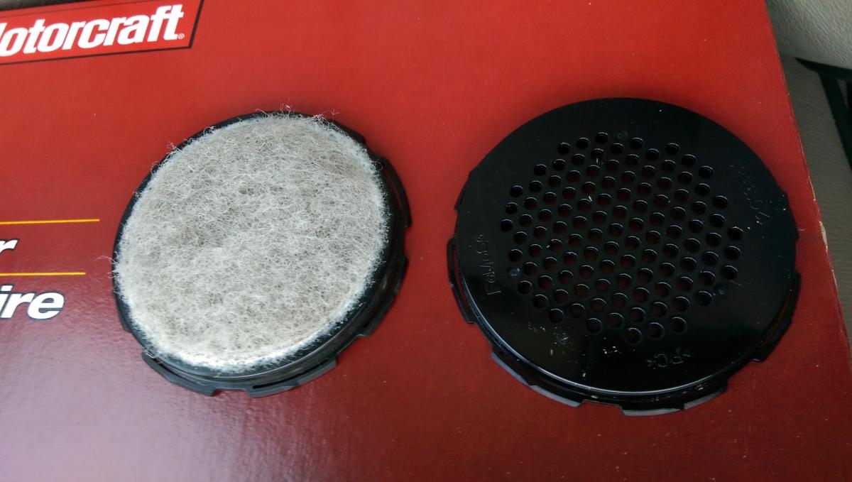

omar302 Posted May 26, 2015 Report Share Posted May 26, 2015 Yesterday I purchased a replacement filter for the cooled seat & was surprised that it is no longer a filter! It is just a plastic piece with holes in it (assuming to protect from larger items to enter).Searching online, I found it was indeed a Motorcraft/Ford design change, but couldn't find any technical reasons for it.http://www.f150forum.com/f38/oem-seat-filters-missing-element-288462/You can see the Old vs. New pictures attached.Front:Back:Reading in several 2015 Ford Owners Manuals such as the 2015 Edge's, it seems they are "Lifetime Filters"! Climate controlled seat air filter replacementYour vehicle is equipped with lifetime air filters that are integrated with the seats. Regular maintenance or replacement is not needed. Anyone know of an official reason for the change or inside info? I am no Expert, but looking at how older cars never had Cabin Air Filters & with their climate control systems working for many years without problems, I wouldn't expect any problems from these "replacements". Also, note that the replacement "part" is made out of sturdy plastic that is hard to bend, while the old filter was very flimsy & just had "nylon net" holding the filter element. Theoretically, I think the older design could have allowed damage to the fan (which is just behind the filter) if someone were to "stuff" something under the seat. Quote Link to comment Share on other sites More sharing options...
WWWPerfA_ZN0W Posted May 26, 2015 Report Share Posted May 26, 2015 Probably cheaper to manufacture (1 piece instead of 3 piece)? Doesn't seem like they are a filter so much as a screen. There might be a run on the older design filters on EBay! Quote Link to comment Share on other sites More sharing options...
Waldo Posted May 26, 2015 Report Share Posted May 26, 2015 The only reason for the filter at all would only be to protect the fan, there's no "purification" of air going on since the air coming in ends up in the same place as the air going out anyway. So my guess would be Ford decided that the new filter is "good enough" to protect the fan and it is probably cheaper, doesn't need to be changed and probably even provides better airflow meaning faster heat up/cool down times. In fact it make me want to go out and get a couple of the new ones for my MKT since it always takes forever for the seats to heat up in the winter. Quote Link to comment Share on other sites More sharing options...
omar302 Posted May 26, 2015 Author Report Share Posted May 26, 2015 Actually, comparing the 2, the new one feels more expensive except for the missing filter element (which does feel very cheap anyway). Quote Link to comment Share on other sites More sharing options...

enigma-2 Posted November 30, 2017 Report Share Posted November 30, 2017 Call me dense, but where are these seat filters located? I have a 16 Titanium with the a/c seats. Was not aware of a filter. I have looked but cannot find. Thanks.Its a round part about 3" in diameter. It's located under the seat, slightly forward of center. Somewhat difficult to get off, they just press on. The old ones (like on my MKX) have a thin filter element, the new one just have a plastic grill. I doubt the you will see any difference between the two. The filter material is very thin and offers little obstruction to air flow. I've used both and the filter type offers a slight advantage as it filters dust/dirt from entering the fan motor. But in all honesty there's very little dirt under the seat to get sucked up anyway. I suppose it may have a slight advantage when considered over several years. Quote Link to comment Share on other sites More sharing options...
enigma-2 Posted November 30, 2017 Report Share Posted November 30, 2017 Yesterday I purchased a replacement filter for the cooled seat & was surprised that it is no longer a filter! It is just a plastic piece with holes in it (assuming to protect from larger items to enter). Both are still available. The FS-104 has a filter, the FS-106 has the guard. Either will work. Quote Link to comment Share on other sites More sharing options...
WWWPerfA_ZN0W Posted November 30, 2017 Report Share Posted November 30, 2017 just be prepared to find that neither has a filter anymore. has happened to quite a few people already. in case you would want to return, make sure there is a good return policy BEFORE you buy. Quote Link to comment Share on other sites More sharing options...
jasoneg Posted February 13, 2018 Report Share Posted February 13, 2018 They removed the filter due to poor air flow. People were complaining that the a/c seats didn't have enough air coming out of them. At least that's Fords official response.... 1 Quote Link to comment Share on other sites More sharing options...
