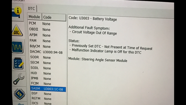

Any electronic gremlins with your XSport? Then definitely look into the battery's condition. Many of these codes are communications related and do not affect actual function. I would reset them, see if they come back. If they come back, perform a KAM reset and see if they come back. If they come back, verify the battery operating condition & replace if needed.
