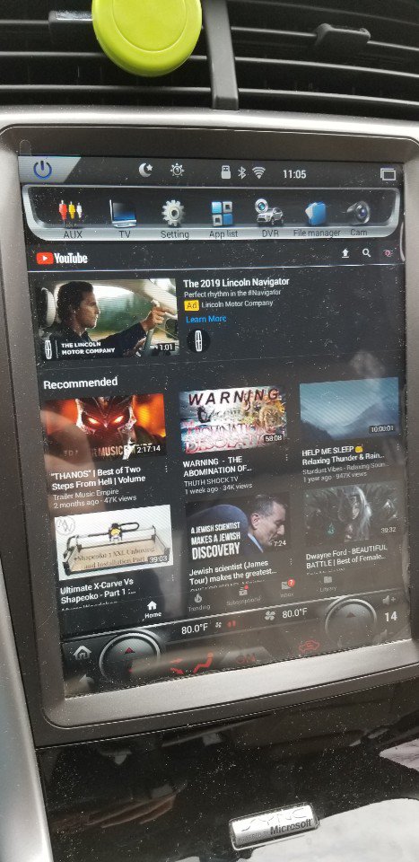

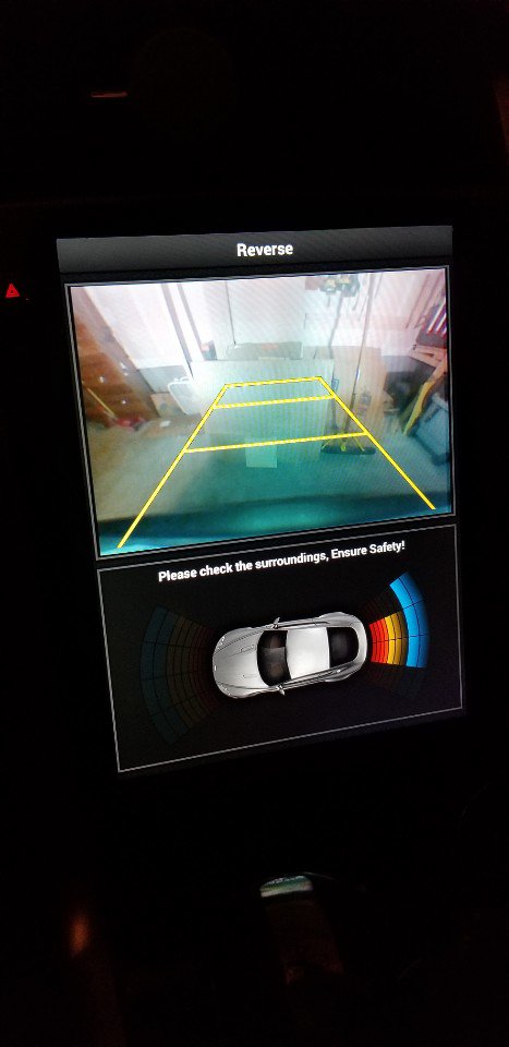

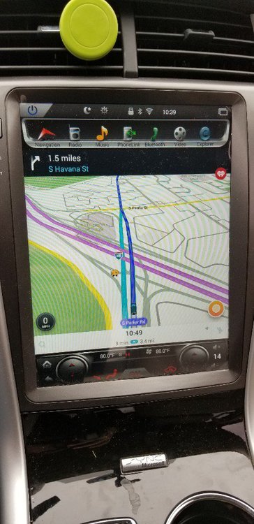

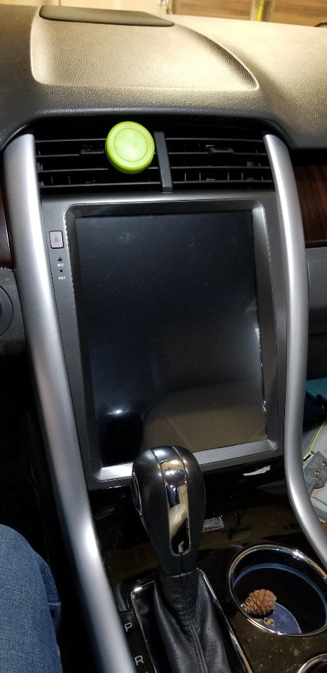

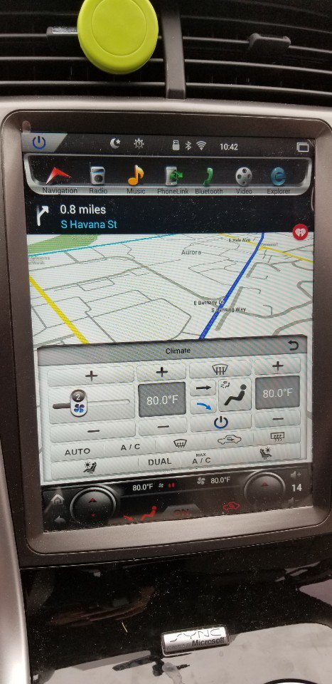

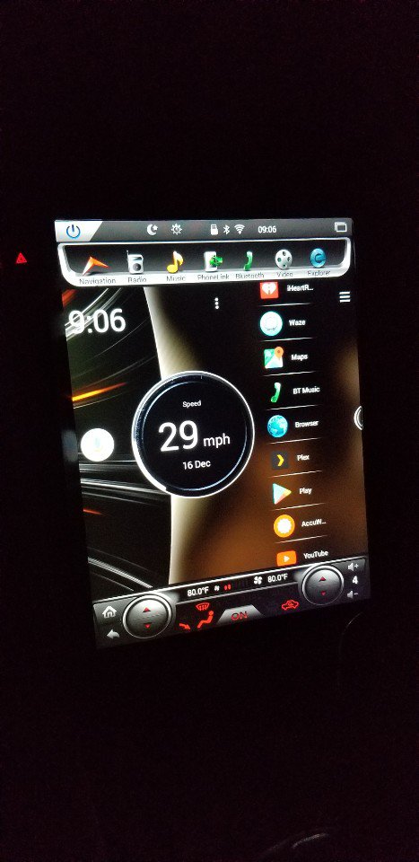

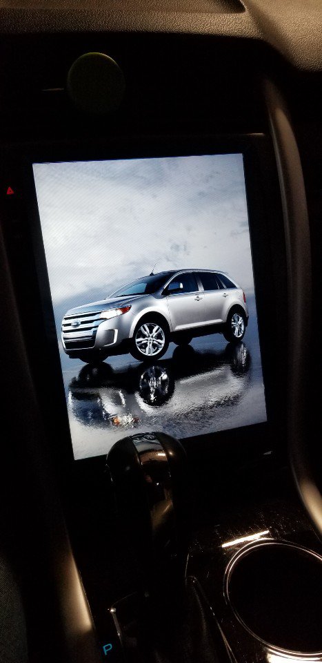

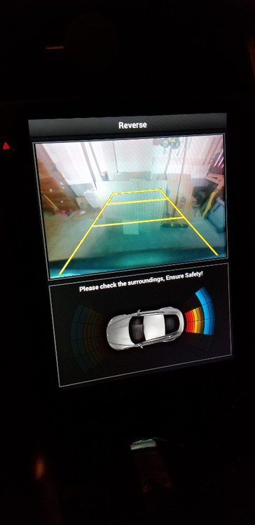

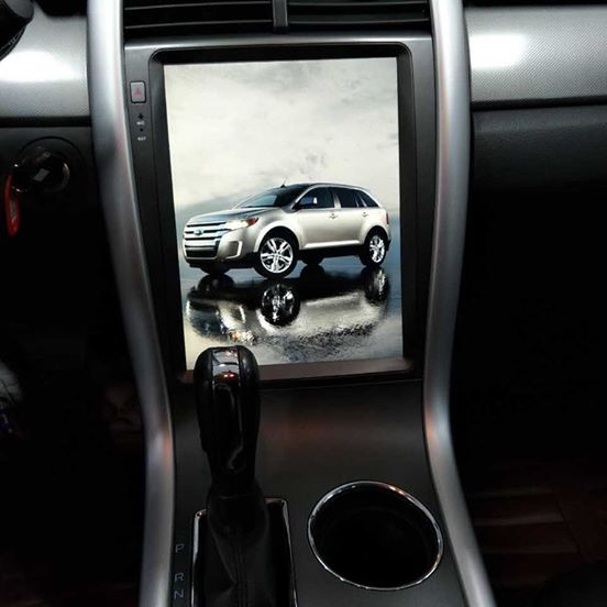

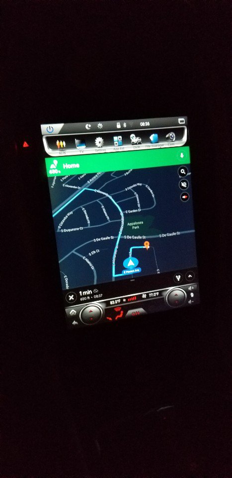

Hey everyone,
So I have had the Tesla style radio in my Edge since Thanksgiving now and I have really grown to like it.  However, there are some quirks with it.  I attached some pics of it in my Edge.
Quirks:
1. Navigation is slow to engage with satellites.  Sometimes it takes 10 mins or so for the navigation to kick in....frustrating, but I know my way around and I can wait.
2. The infotainment LCD in the cluster panel is now useless.  The only one that displays information is the climate screen.  You cannot control anything with it, but it will tell you what everything is set at.
3. No more sync functions.  You can no longer talk to your car.
4. Climate control takes some getting used to.  For some reason, the recycled air is not working.
Honestly, this huge screen and its capabilities are good enough for me to not go back to OEM.  I can connect to the internet with it, through my phone, and pretty much run any app I want.  I have Waze, google maps, youtube, iheart radio, etc.  It runs off android so I have access to the Google Play store.
I have loaded a skin over the operating system because the stock UI is terrible.  All controls for your climate are now digital and it works pretty well. As a bonus, there is a push button for your hazards.

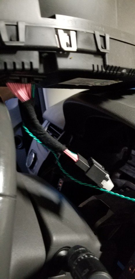

All-in-all, I am very happy with the purchase.  I think I paid $520 for it and installed it myself.  Even had to take out the instrument cluster so I can plug a cable into the back of it.
Cheers!
