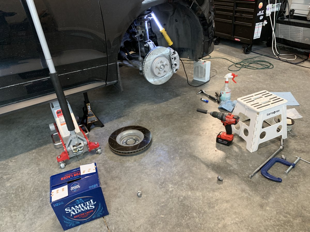

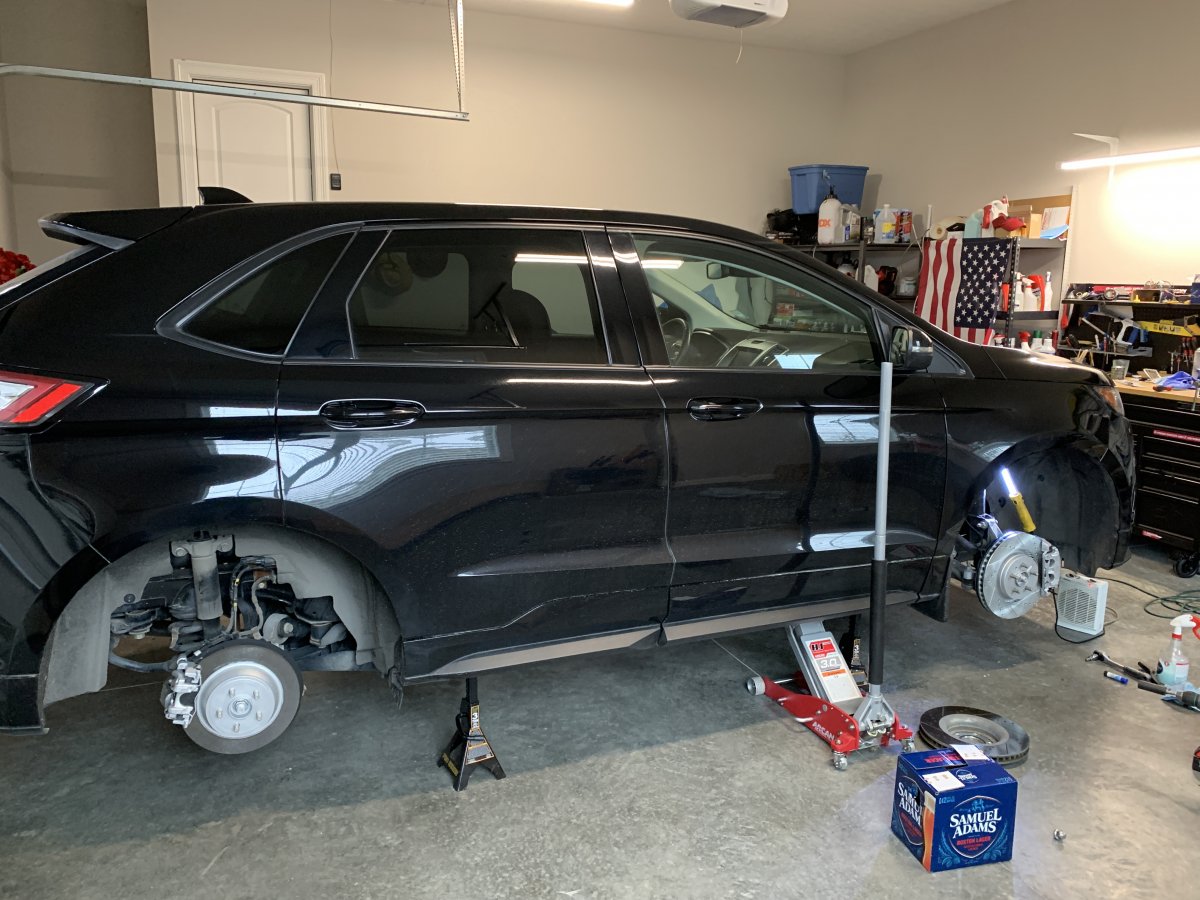

1004ron Report post Posted March 16, 2020 4 hours ago, 14AWD3.5 said: So where do you jack up the front from? What suspension component do you use with a floor jack to raise the front up? I think I did the transmission drain with it on ramps. Just this past weekend I had it up on stands to rotate tires and replace the front brakes - the position of the floor jack lifts it level. 1 Share this post Link to post Share on other sites
handfiler Report post Posted March 17, 2020 And the Samuel Adams keeps the owner level 😆 3 Share this post Link to post Share on other sites

1004ron Report post Posted March 17, 2020 1 hour ago, handfiler said: And the Samuel Adams keeps the owner level 😆 I added that to show a friend that I got "paid up front", .......by myself. LOL Damn good beer. The rotor laying on the floor is the 8 month old 9K mile Power Stop that started making a growling noise and slight vibration at low speeds - they promptly sent a complete new kit, but will go with solid rotors next time. Share this post Link to post Share on other sites
