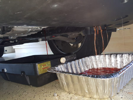

And finally, replacing your transmission fluid is as easy as changing engine oil.  You'll remove the driver's side under panel (4 screws and a plastic clip), slide a catch pan under the car and remove the drain plug.  When the ATF fluid is drained, replace the plug and the panel.  Done!  Here's the rub, you have to do that three times to get all of the old fluid out since about half is trapped in the torque converter when you do the drain procedure.

Finally, changing fluids isn't difficult, especially after you've done it a time or two.  A system develops like this two-fer..transaxle and radiator draining under my '16 Edge:

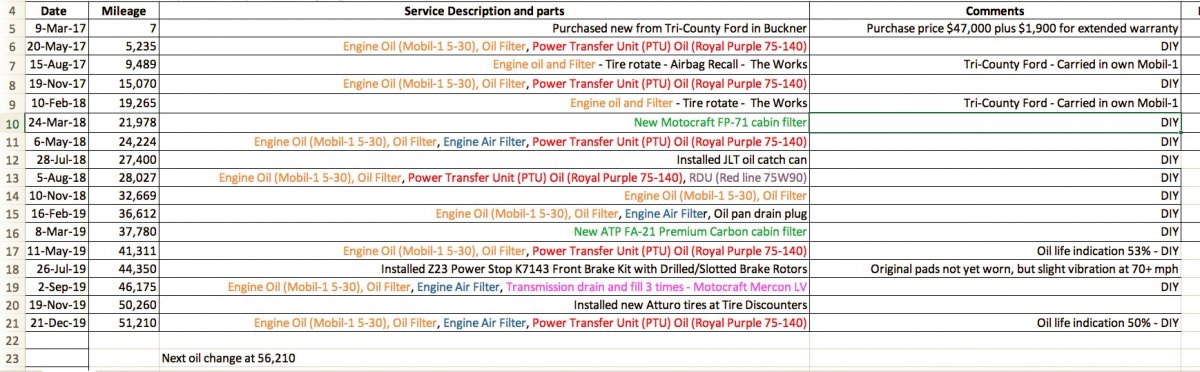

The only Motorcraft fluid I've used is the transmission Mercon LV
I believe my choice of Engine, PTU and RDU fluids are superior to Motorcraft.
Changing the transmission filter on these means removal and splitting of the trans, so agree, don't consider that as required maintenance.
Edited by 1004ron
Thanks guys.  I had the dealership flush tranny and coolant before I ever picked it up.  I changed the oil myself and added a Fumoto valve.  Last thing left is PTU change with Motorcraft fluid.  I bought a new jack and jack pad, just need to find a good place to put the jack stands in the front and then find the time.  ?
