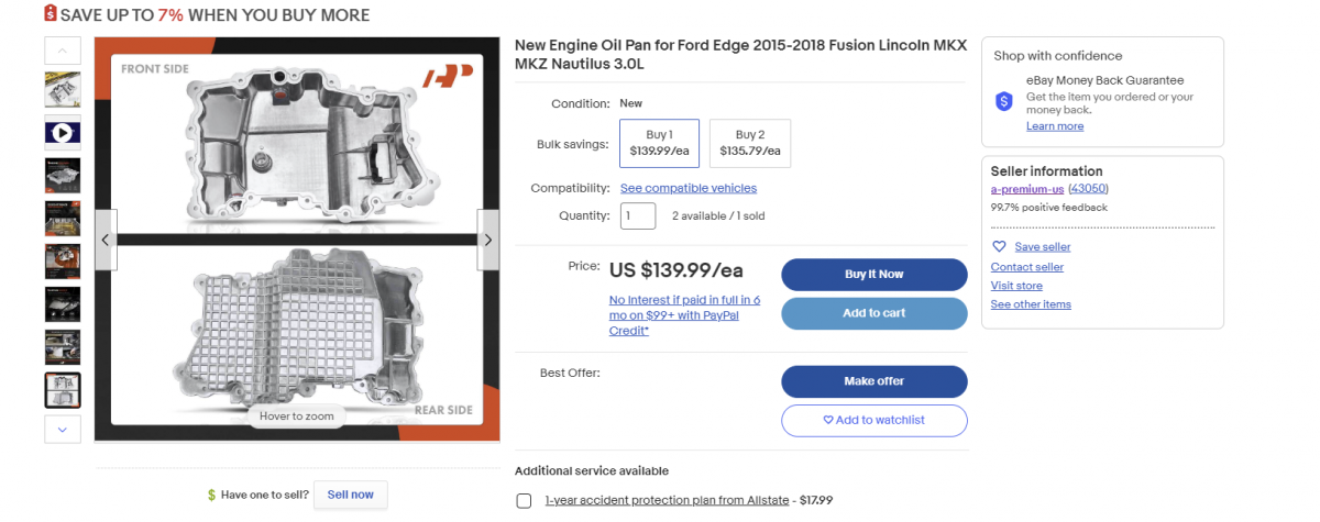

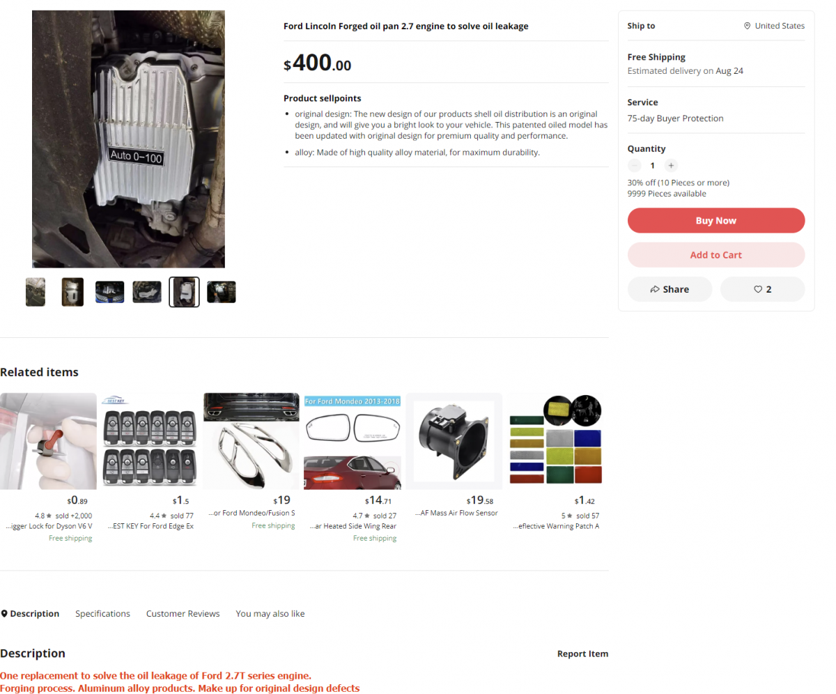

Musketeer Posted August 16, 2023 Report Share Posted August 16, 2023 I am plagued with the dreaded oil leak. I have the ebay gasket waiting to be put on a new oil pan. I came across these alumnium oil pan on ali express and ebay. Has anyone seen or used these products? https://www.aliexpress.com/i/3256801712267930.html?gatewayAdapt=4itemAdapt https://www.ebay.com/itm/165955245815?hash=item26a3b416f7:g:UdYAAOSwn8BkhrPH&amdata=enc%3AAQAIAAAA4G7hAjNbZX5VB7p6kXLDTENFu%2Fwl47BZC2VT3TR6n6hCpR0AzwI7nUzfUO%2BZ2VEWe5GPl06FoEQiAa5N4S4ffuzzNeqZRo1b5%2BrkQn9R8vixYXAGZ%2F8k%2BlZHS%2FcTO7x7XYC3QFNQ8OyDgnbJCaFQKQVSrnyeO68sT7pFidImFpKISmdRdEd6%2F%2B2esQfxuUobmJ95%2BT5j9HMchLY9RbQScvmyWqEf8vfdIwTuW2K4HlRG9KxXzxqzMK1Jh2nzNk6cFtz5QvyxNO1RMk6bo1T7TURiFWASzTG95rbSo5vS9GAk|tkp%3ABFBMrvjNhMBi https://www.ebay.com/itm/125814640685?hash=item1d4b23102d:g:9zMAAOSw-QlkgaFG&amdata=enc%3AAQAIAAAA8NGWf3oFXW%2BADMsTd%2FWh4IKN0lKJQB0bbeur3tsniDNspBY%2BFdcriFlQVsFKun9kCJaGX6ZrAQrcKfbr8nbNOEmmFO7pkUTxDiuP0znzUcVR2JEaCEo5sZOd%2FbGJsKffBW6vFayWpAyM%2B96e40DYKG2Etfxx8EZzSTf3ZpfVla%2Fhcx69u9qwvtQGLdYsaLSgrssyg4RPI51RtwdKKwIkxqGfyiTUKPYUnOverYKvHERWGkD2MSUCW7HojBpvHlE0QortumxnFucUJVLBdGiAqfK4Qg75xBXVXneNMEBpCBqICj6Hu4Nu4eEs3HHPnxXZkw%3D%3D|tkp%3ABk9SR96DhIXAYg Quote Link to comment Share on other sites More sharing options...

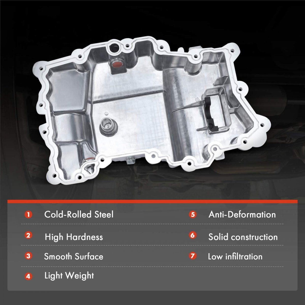

handfiler Posted August 17, 2023 Report Share Posted August 17, 2023 They lost me at "Cold-Rolled Steel" Quote Link to comment Share on other sites More sharing options...
Musketeer Posted August 17, 2023 Author Report Share Posted August 17, 2023 (edited) aliexpress is horrible on desktop. try mobile instead if it does not show up https://www.aliexpress.com/store/1101579396?spm=a2g0o.store_pc_saleItems.pcShopHead_6000362899763.0 Edited August 17, 2023 by Musketeer Quote Link to comment Share on other sites More sharing options...

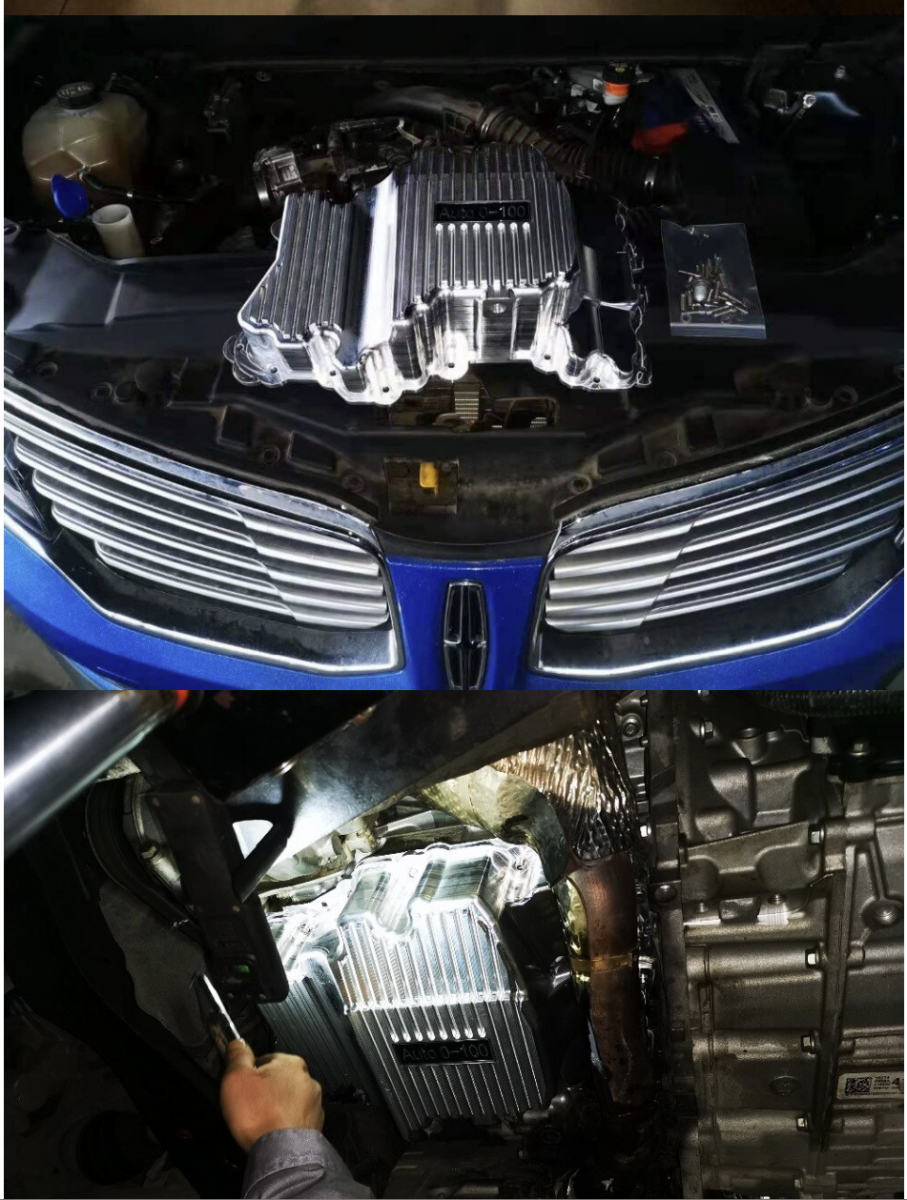

Musketeer Posted August 19, 2023 Author Report Share Posted August 19, 2023 21 hours ago, enigma-2 said: I read over in the 150 forum that the aluminum pan does NOT fit the 2.7 ecoboost engine. From everything I've read, it's the quality of the aftermarket silicon gasket job that in question. Apparently the trick is to get both mating surfaces spotless. No oil. Means spraying with brake clean then wiping down with clean towels. Then leave everything sit for an extended period for cure. From what I've read over the years they were trying to swap the metal pan from the 3.5l and it's a no go. These pans are specifically for the 2.7t. I am just now finding them online but have periodically searched and never seen any. Now they are all over ebay. I wonder if overseas the 2.7 is finally getting some love. On aliexpress that's a mkx w/2.7 being used. I have the same vehicle Quote Link to comment Share on other sites More sharing options...
enigma-2 Posted August 19, 2023 Report Share Posted August 19, 2023 Well, the talk over there is the aluminum pan doesn't fit, seems I read some time back that someone tried it. Maybe there's a difference between the truck version and the CUV version? If I were you, I'd wait to find someone who's actually tried the install. I don't remember anyone successfully doing it, but I haven't really followed the subject too carefully. Perhaps if you talked with the local Ford Garage Service Manager? These guys are really knowledgeable on the basic problems and if anyone has done this, they may know about it. Never hurts to stop by and ask, I've done it probably too many times; got a reputation for questions, questions, questions. But I've found that my local SM loves to answer questions, including going to the area rep and even Ford Engineering, for answers. He has so much knowledge and no one ever asks him what he thinks. Another way to go, is to make certain the Ebay seller specifically states In the listing, that it will fit your exact engine (again, in writing) & that you can return it, if it fails to fit. I wish the best for you, i hate oil leaks, but it seams to me, that a good due job, on the existing plastic pan, is what's really required. If it was my car, I'd have the Lincoln Garage do the job and get a warranty on it. But for the cost of a 12 hour repair, it would have to be a lifetime warranty !!! Quote Link to comment Share on other sites More sharing options...
Musketeer Posted August 19, 2023 Author Report Share Posted August 19, 2023 12 hours ago, enigma-2 said: Well, the talk over there is the aluminum pan doesn't fit, seems I read some time back that someone tried it. Maybe there's a difference between the truck version and the CUV version? If I were you, I'd wait to find someone who's actually tried the install. I don't remember anyone successfully doing it, but I haven't really followed the subject too carefully. Perhaps if you talked with the local Ford Garage Service Manager? These guys are really knowledgeable on the basic problems and if anyone has done this, they may know about it. Never hurts to stop by and ask, I've done it probably too many times; got a reputation for questions, questions, questions. But I've found that my local SM loves to answer questions, including going to the area rep and even Ford Engineering, for answers. He has so much knowledge and no one ever asks him what he thinks. Another way to go, is to make certain the Ebay seller specifically states In the listing, that it will fit your exact engine (again, in writing) & that you can return it, if it fails to fit. I wish the best for you, i hate oil leaks, but it seams to me, that a good due job, on the existing plastic pan, is what's really required. If it was my car, I'd have the Lincoln Garage do the job and get a warranty on it. But for the cost of a 12 hour repair, it would have to be a lifetime warranty !!! I bought the truck during covid from an out of state subaru dealer with a mediocore warranty. But it was enough to get the oil pan done and replace my front camera and wire harness. warranty company sent me to bmw dealer who did the pan and sent it to ford for the harness. took them 4 months to do. oil pan leaked within a year from that ? Quote Link to comment Share on other sites More sharing options...
