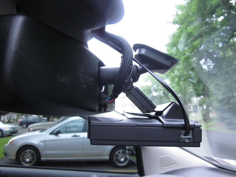

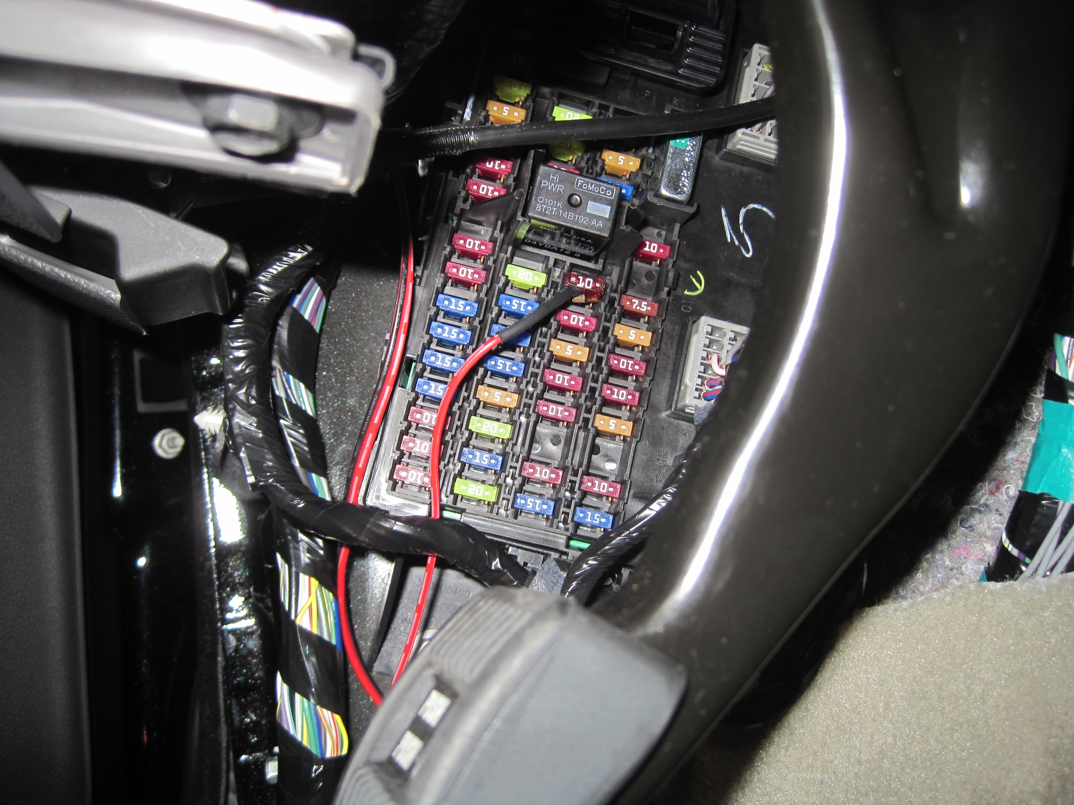

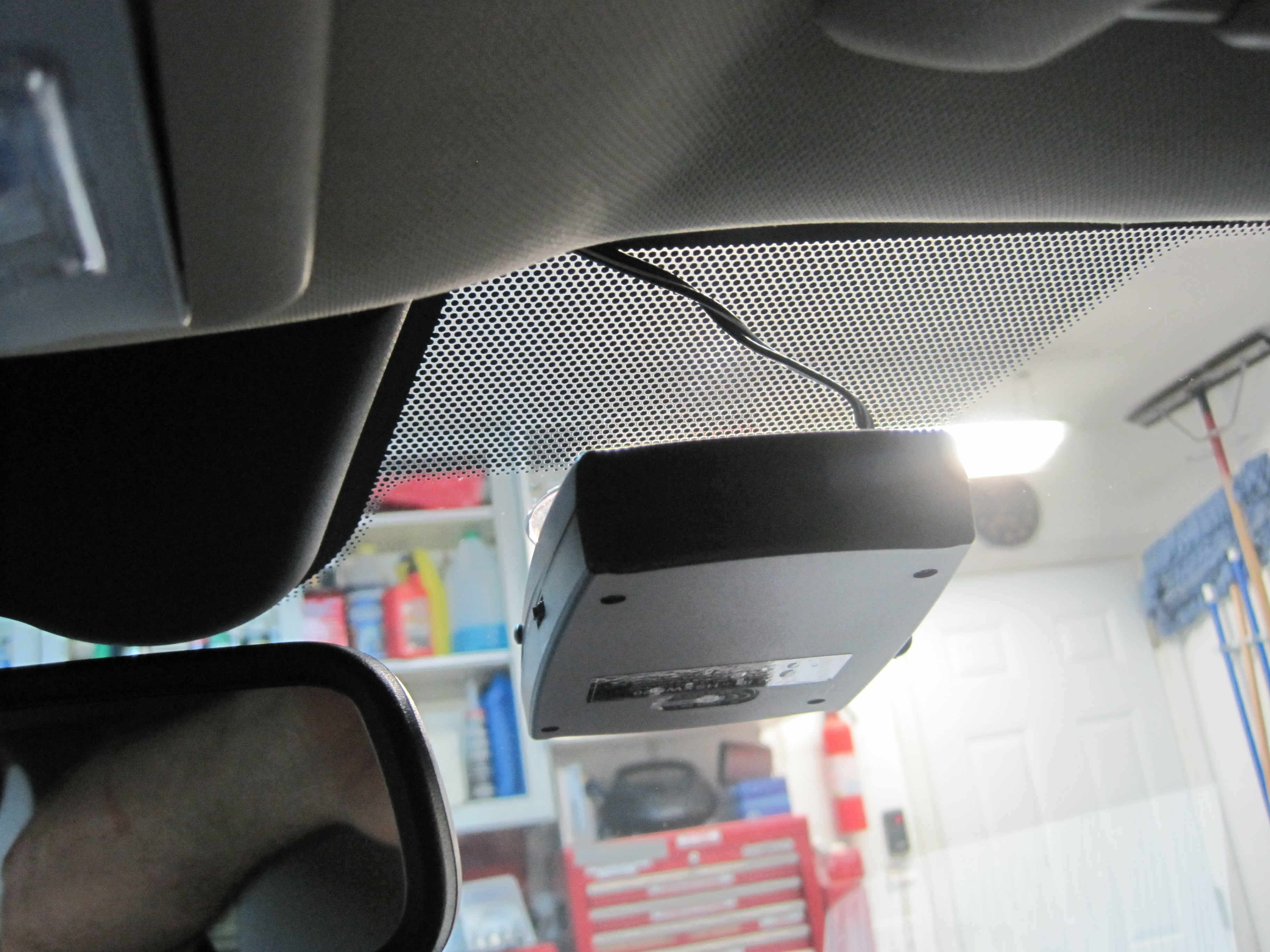

Here are some pictures that show how I hard wired our radar detector into the fuse (#35) panel.I used a mini fuse with a tap and then attached the ground to an existing bolt that already had other grounds connected to it. It works perfectly and turns on the car is running and off when it's not. Entire job took me less than an hour and I was in no rush at all.
Good Luck,
TR

Fuse 34 is for the reverse sensing system
The proper fuse to tap is # 33, a spare.
All from the Ford "Owner's Guide" for the 2011 Edge, that comes in the zip document holder. worship.gif
