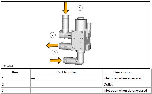

  4. NOTE: The temperature control valve directs warm coolant to the transmission fluid cooler/warmer mounted on the transmission during transmission warm-up and allows the coolant to bypass the warmer when the transmission fluid reaches normal operating temperature. NOTE: At 38°C (100°F) ambient temperature, amber arrows indicate temperature approximately 82°C (179°F). only affects transmission warmup afaik. not a big deal if you don't live in a wintry state. may set a code or two.
