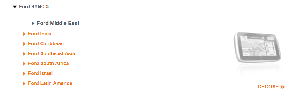

You didn't mention where on the planet you are. The site you mention isn't the official Ford site for North America map updates, this is: https://syncnavigation.com/ford/home Updates for your year are $109 for the download. If you live in one of the countries shown in the download section of NaviExtras (screen grab below) you should have been told 'before' the download there would be a fee. If you're in North America the download shouldn't have happened after you entered your VIN and Sync info.
