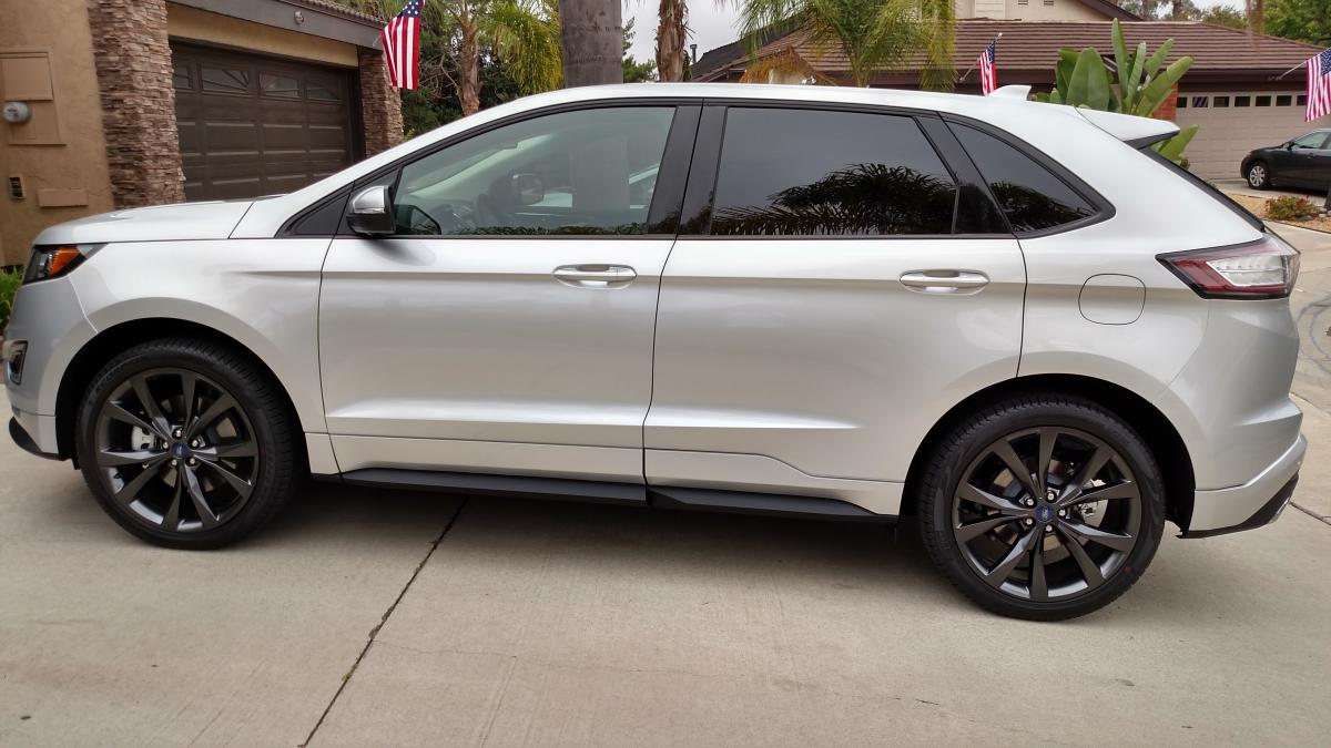

Just got my Edge back from the dealer on Thursday. Live in San Diego, so car has never been in rain or suffered any water intrusion. They sealed all of the areas around the A pillar. Not the prettiest, but hopefully I never had an issue from the get go. Also had them tighten my hood latch( loose), readjust the hood from unevenness near windows and had them center the rear hatch that was completely off. Dealer gave me a 2014 Edge SEL as a loaner. The 2015 Edge sport is 100x nicer and more upscale than last year's models. I did tint all the windows and next will be an HID conversion.
Looks like mine will be in next week for similar repairs. My rear door is soooooo of center.
Love your wheels. Are those factory?
Very poor quality control at the factory. Pretty sad that Ford couldn't even put a hood on flush or center the rear liftgate. Those are the factory 21" wheels that was one of my main deciding factors in buying the Edge. I test drove a sport with the standard wheels and noticed a much firmer and sportier ride with the 21's. I really like this vehicle so I hope all of the little bugs have been sorted out. BTW, my dealer has been great getting everything fixed to my satisfaction. Good luck with your fix!!
