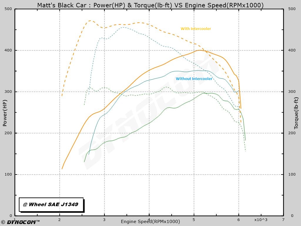

The fight for colder, denser air is always worth it when done right.  And a performance intercooler is a big step forward.
