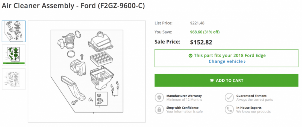

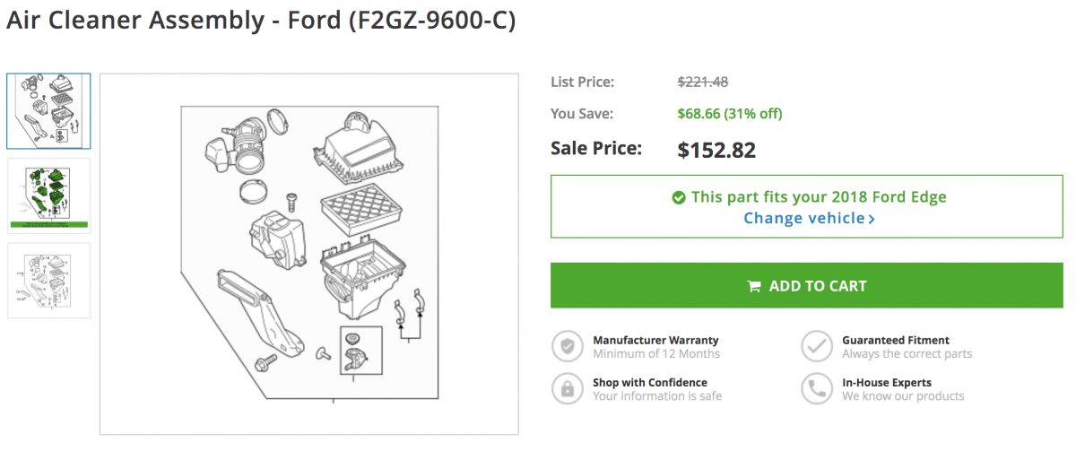

Try checking the wrecking yards there have been more than a few edges sold from 2015-18 with the 2.0l. A stock air box from an SE to Titanium with a 2.0L should work fine, if you hadn't considered it.
If no one wants to trade with you, and you can't find a used one from a yard.  A new complete assembly is available for $152.82:
https://parts.levittownfordparts.com/oem-parts/ford-air-cleaner-assembly-f2gz9600c?c=Zz1lbmdpbmUmcz1haXItaW50YWtlJmw9MSZuPUFzc2VtYmxpZXMgUGFnZSZhPWZvcmQmbz1lZGdlJnk9MjAxOCZ0PXRpdGFuaXVtJmU9My01bC12Ni1nYXM%3D

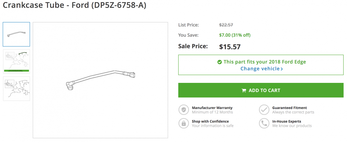

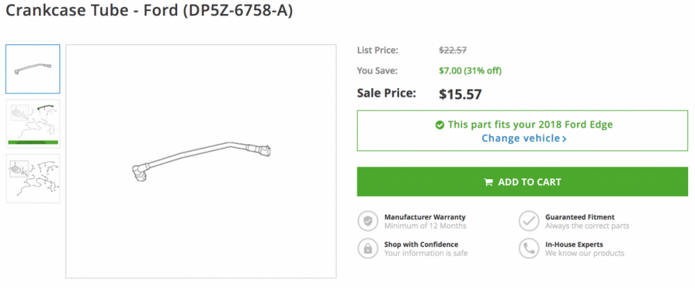

So in my endeavor to go back to stock, I need to find out what other parts or hoses, tubes, etc. that I need to replace? You mentioned the "clean side PVC" and MAF housing, both which I have no idea what they are? Can you see in the pic, or is there a place where I can find a "parts list" and exploded view of the  whole system to not miss something?
Thanks for all your knowledge and help!
I am not totally familiar with the 3.5L NA engine in the Edge but I do know that you will need the entire air intake (including filter) and the hose you see in your pic.
It is kinked and looks like one of the connectors was removed to attach it to the K&N.
As far as the MAF (Mass Air Flow Sensor) I was referring to the K&N intake's MAF housing was capped off providing evidence that it was not meant for your engine.
These pics are from the links provided earlier. Maybe talk to your dealerships parts department to confirm the part numbers and start shopping for deals.2126869786_ScreenShot2019-07-30at7_04_48PM.thumb.png.c63c8c0ab0fca58445c1686691690001.png1130823260_ScreenShot2019-07-30at7_05_02PM.thumb.png.2afef74fb7481109f9784ee693987aa4.png
