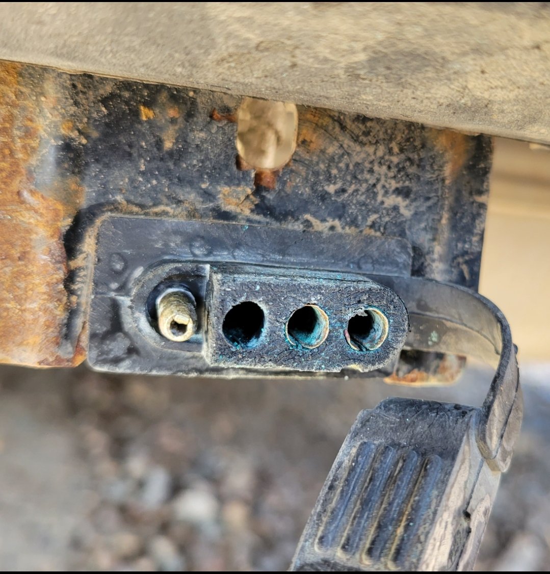

I have noticed a few times while towing different trailers that the the lights on the trailer will randomly come on and stay on for awhile even with the Edge off and not being used. It has the keyless entry and start. I hooked up a trailer to go to the landfill the next day and later that night the trailer lights are on (clearance lights). Lights for the trailer have a light-up connector that tells you what lights are getting power etc and that will light up at the same time the clearance lights turn on.
Edge is off, no lights on the Edge. Doors are locked. I noticed this when the Edge was fairly new, month or so and under 4k kms. Now its 6 months old and 17k kms and the 4 pin terminal is badly corroded... it has been covered when not in use.

 I have not towed a trailer in 2 years. Today when I need to the plug is right corroded! Cap still on. The clearance light receiver is completely gone! I am mad!!
