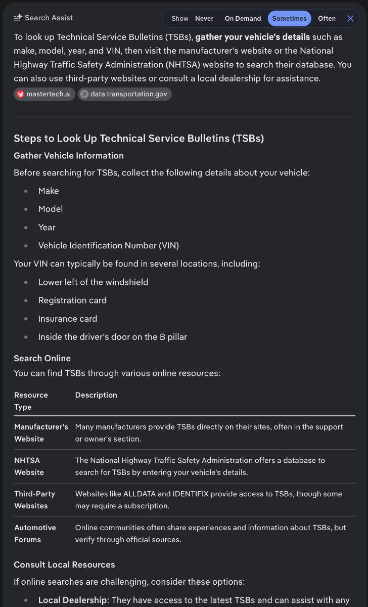

Samurai Edge Posted October 29 Report Share Posted October 29 (edited) Having a rear main seal go unfortunately is not uncommon but it does happen. Most of that estimate is labor because there is a lot of work for removal / reinstall. In U.S. dollars, that comes out to $1716 which is a good price. If you have ever looked under your car, you will see why the transfer case / PTU / transmission needs to be removed. It's very tight in that area under the car. It's hard just to stick your hand up between the motor and the PTU case. Oil Service - check AC Service - check ; they probably need disconnect the lines Seal Replacements - check Subframe Removal - uncertain but, again, probably needed to lower the motor for access I have never had this done on my Edge but similar work on others cars I used to have. You can look up TSBs for your car. A TSB is not a RECALL, just FYI, so unless you have warranty coverage, you will pay out of pocket. Edited October 29 by Samurai Edge Quote Link to comment Share on other sites More sharing options...
