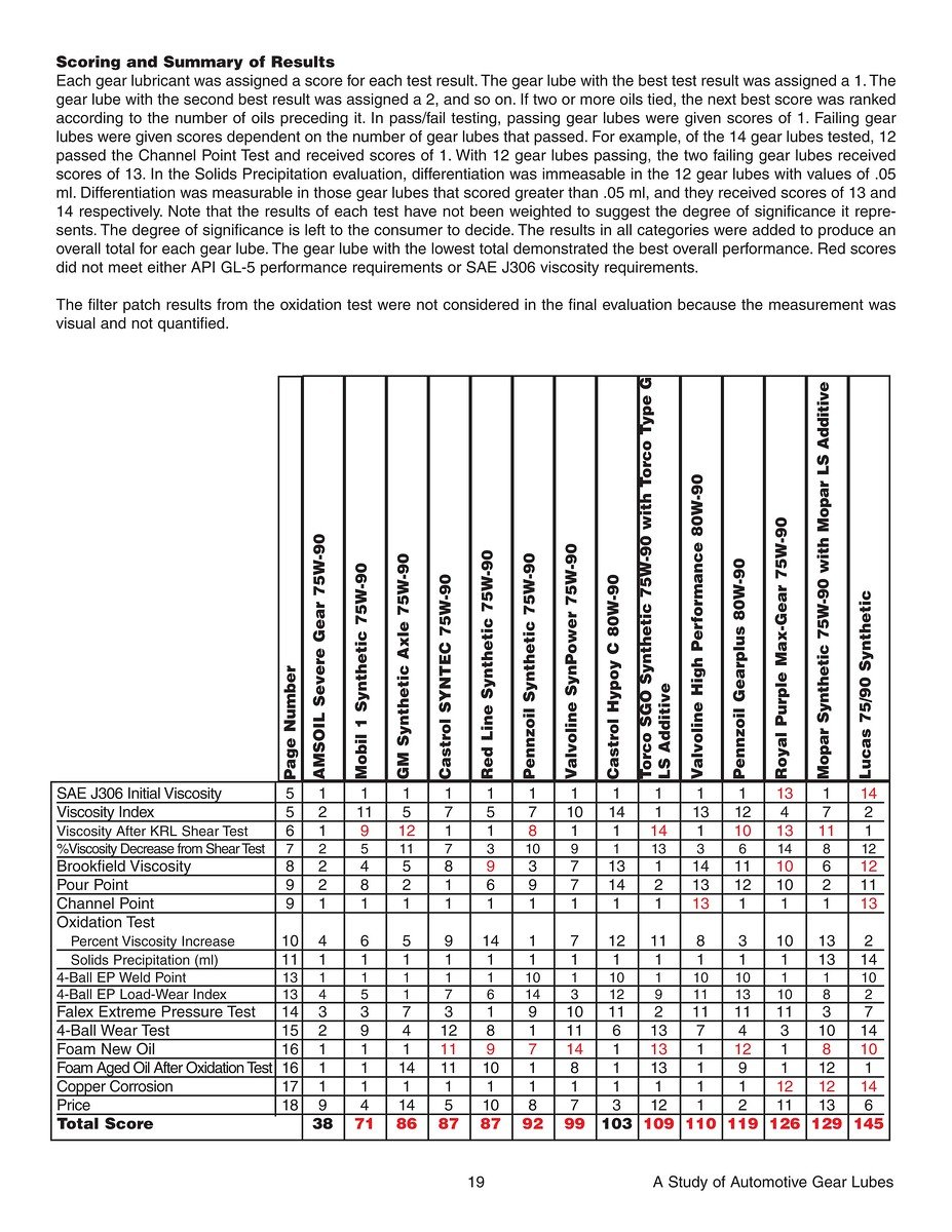

30 minutes ago, flymore said:
So what do you use? Redline, Amsoil, Motorcraft, Valvoline, Royalpurple?
For the PTU I would go for one of the top rated ones in the below list, which is for 75W90, but still a good guide for 75W140.
I've been using Royal Purple and Redline but considering a change to Amsoil, oil Mobil-1
