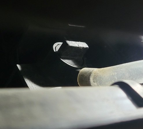

Considering coolant drain and fill 2018 3.5l over to yellow

This is a timely thread as I too will be changing my 3.5 over to the "new" Yellow. I wondered what was involved. I also was a bit concerned about how many "partial" cycles it would take to do a complete change over, then whether or not I should get a vacuum refill so all the air gets pulled out of the system. I also wondered about what motorcraft uses in the 50-50 pre-mix? I bet it's not distilled water! Flymore did you get that drain valve opened?

It was way to hard to use my fingers, so I tried pliers. That's when it looked like it may break off! Now have the radiator petcock socket tool for next attempt.
