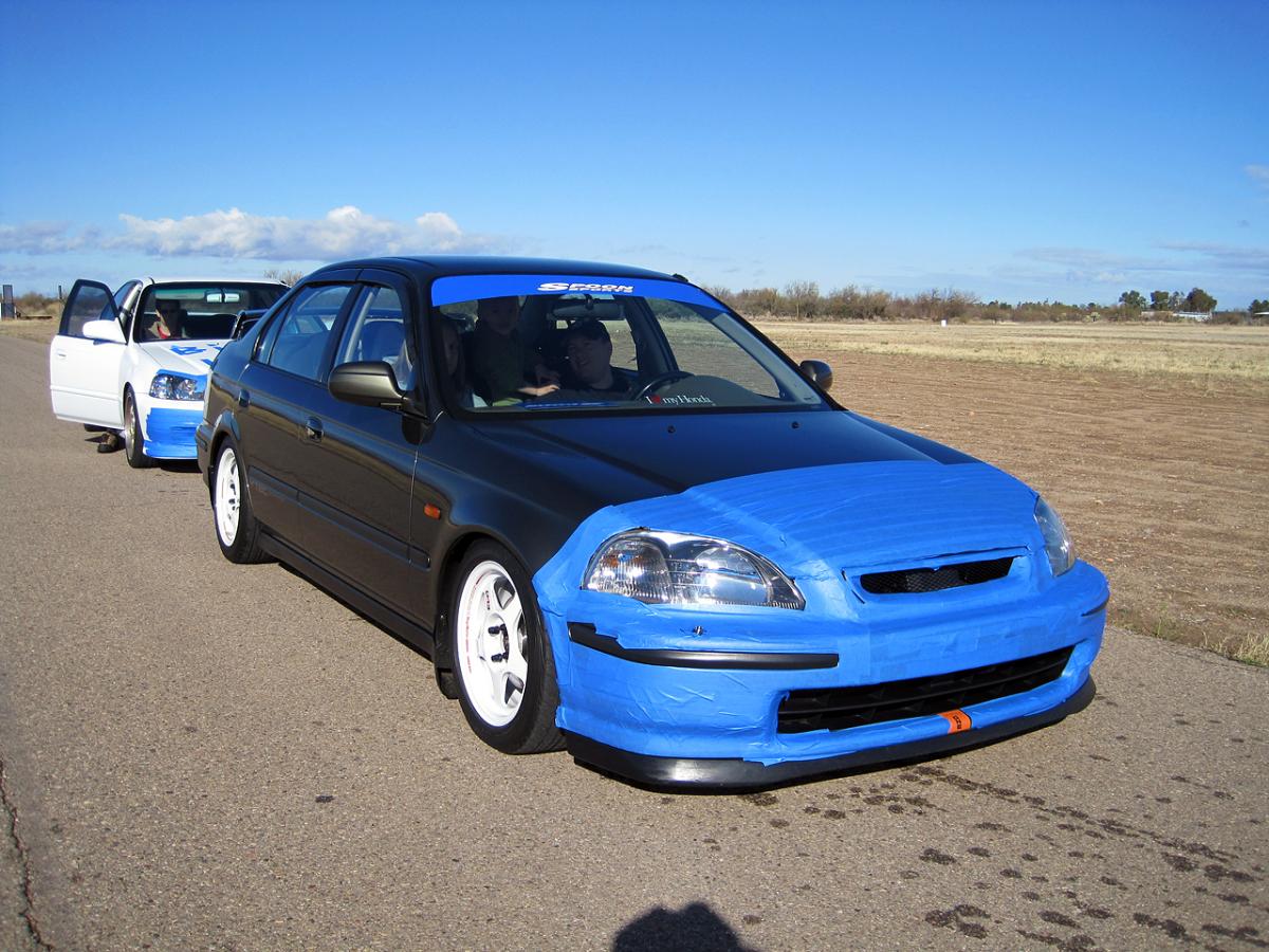

mooshin Posted July 23, 2012 Report Share Posted July 23, 2012 (edited) We use the 3M Blue Painters tape all the time when we transport cars to auto events/shows. Usually we cover the front half of the car and mirrors. We usually only do this when we are taking cars across the desert from Phx to California events. Never considered doing to my Edge Sport, but then again, I've never taken it on a road trip yet. Edited July 23, 2012 by mooshin Quote Link to comment Share on other sites More sharing options...

Edgieguy Posted October 12, 2012 Report Share Posted October 12, 2012 Tape it. You'll be glad you did when you're getting your clear bra installed, And just like Blankster did, put a layer of duct tape over the lower valance. We tape up the front of our MR2 when we take it to Watkins Glenn and our front lower valance looks as nice as the rest of the car. Over 2000 miles there's plenty of time for a few rocks to beat up your new vehicle. Quote Link to comment Share on other sites More sharing options...

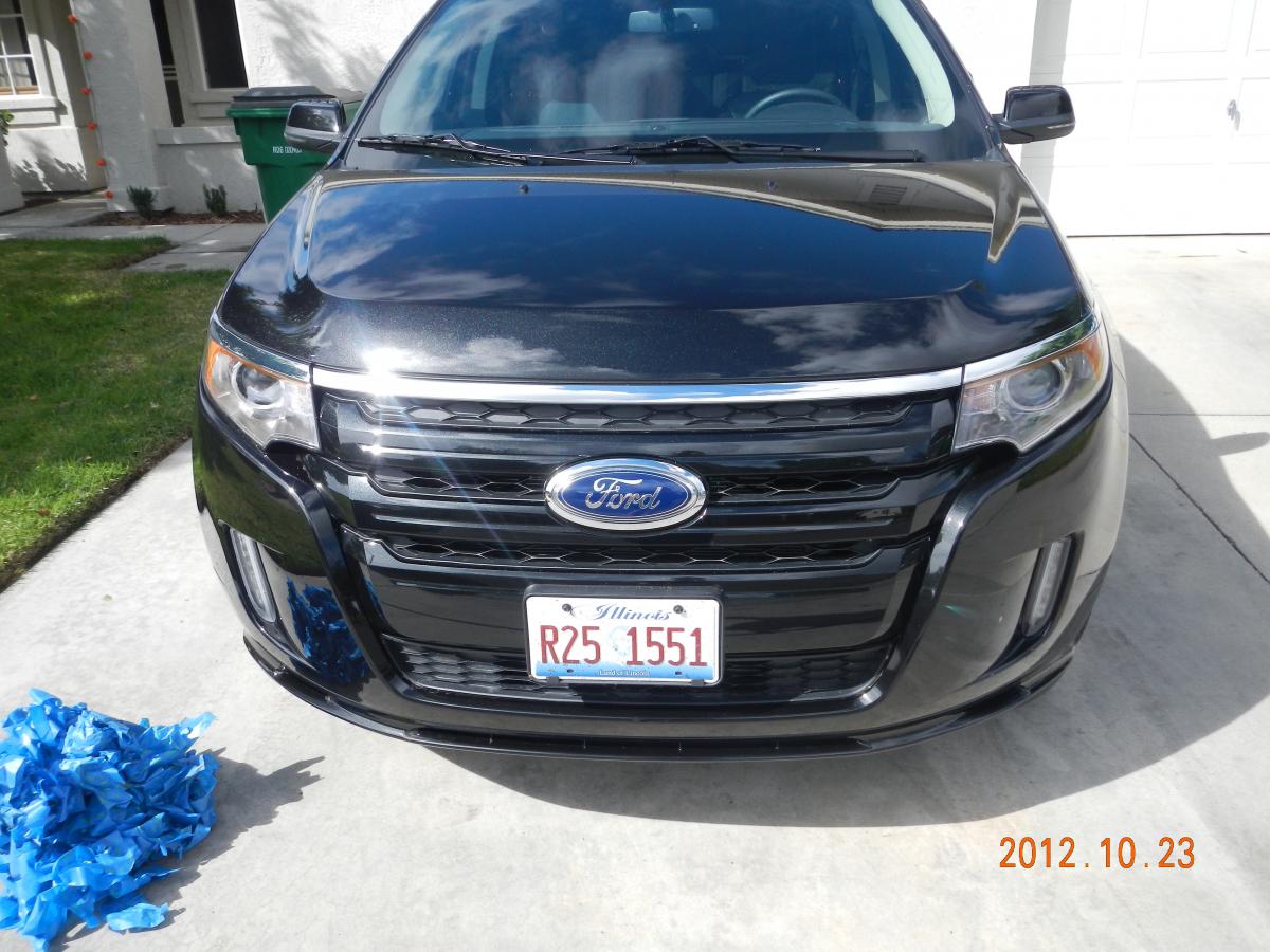

Lowery89 Posted October 31, 2012 Report Share Posted October 31, 2012 Ok I did it! It took almost 3 hours but i took my time and did it right so i didn't have to deal with any coming off over my 2000 mile journey. It took 2 and barely starting a third roll of the scotch 3m painters tape. Very easy to remove left no residue at all. Best part and you can see from a few of the pictures, I didn't have to scrub any bugs off anything but the windshield. The a- pillars had maybe 2 bugs on each of them. No scratches, chips, or bugs to ruin my new paint and now i have the Xpel ultimate clear bra every where there was blue tape plus the rear bumper guard in the film. I'll post a picture of that on the clear bra thread. Highly recommend both the clear bra and 3m tape for a long trip if you don't have that. Any Questions fire away! The finial pictures were 20 mins after i made it to my driveway and said hello to the wife, temperature ranged from 94 degrees in Las vegas and 23 degrees at 0 dark thirty in Colorado with a little moisture on the roads, the tape stayed on strong everywhere no issues. 1 Quote Link to comment Share on other sites More sharing options...
WWWPerfA_ZN0W Posted October 31, 2012 Report Share Posted October 31, 2012 Good work! Now if only they made painter's tape in matching colors (or see thru) :D Quote Link to comment Share on other sites More sharing options...
cmillz1331 Posted October 31, 2012 Report Share Posted October 31, 2012 Good work! Now if only they made painter's tape in matching colors (or see thru) :D That would be awesome Quote Link to comment Share on other sites More sharing options...
akirby Posted October 31, 2012 Report Share Posted October 31, 2012 And it's so stylish to boot! Quote Link to comment Share on other sites More sharing options...
