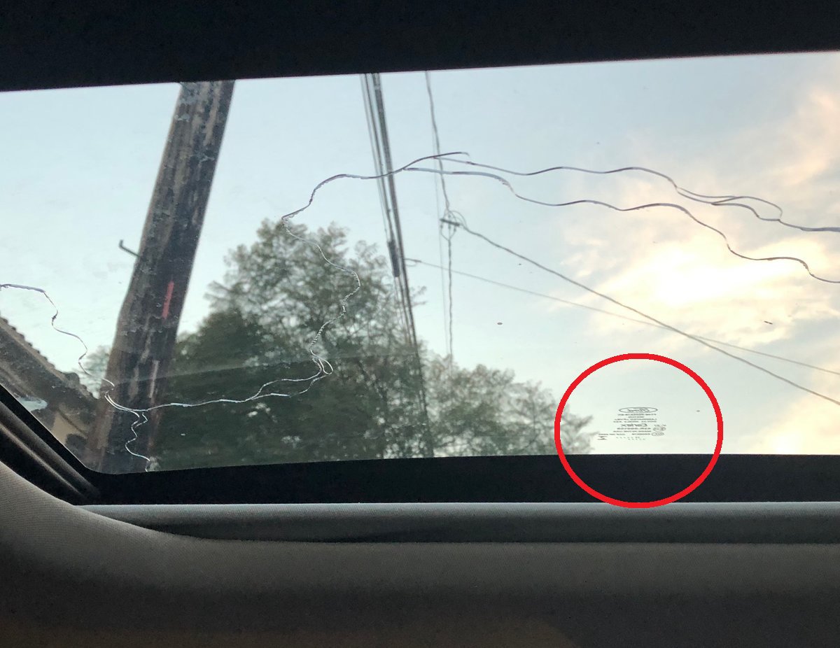

2018 Edge Sunroof Whistle
WWWPerfA_ZN0W replied to Kane's topic in Glass, Lenses, Lighting, Mirrors, Sunroof (BAMR), Wipers
A couple of questions from people I asked: Can you feel the fractures? If so, are they both outside/inside, or which side is more easily felt? Also, can you please grab a closeup pic of the labeling on the glass? Might be able to figure out something from that. -
Don't think I have come across a report on this particular issue. Very likely that if you open it up fully, you will be able to find a loose rubber strip or two. It only happens when closed, right? Or does it happen in TILT, or fully open modes as well? -
Does not look like an impact issue to me, but I would get it looked at by 2 or more independent parties. I dunno if there is a workaround to involving the insurance company, since coverage has elapsed (1 year/12K miles IIRC). But if Ford is pushing back, you can as well - pending confirmation from said parties that impact is not the issue. People should not be required to have glass coverage when purchasing vehicles with BAMRs, it is not even suggested in the warranty or owners manual anywhere. On a side note, this issue with glass is usually at low mileages/first couple of years of vehicle production. Literally as if the glass needs time to "set" in place. So it is possible that the frame is "settling", leading to stress fractures. Much like house windows. Just a theory. Not a Ford-only issue for sure.

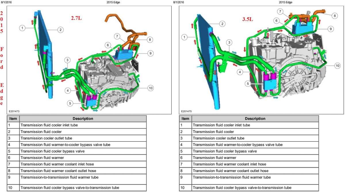

2016 Edge Transmission Hard Shifting
WWWPerfA_ZN0W replied to Maverick's topic in Recalls, TSBs & Warranty
Could also try Valvoline MaxLife instead of Motorcraft LV. I think they have started putting an active warmpup for the transmission, but have to dblchk which transmissions it applies to - 6f35/50/55. The transmission fluid cooling system consists of the following: An oiltoair transmission fluid cooler integrated with the A/C condenser A transmission fluid cooler bypass valve If equipped, a transmission fluid warmer Tubes to all fluid to flow to the various components The transmission fluid flows from the transmission to the cooler bypass valve. When the transmission fluid is below normal operating temperature, the bypass valve directs the flow back to the transmission. When the transmission fluid is at or above normal operating temperature, the bypass valve directs the flow through the transmission fluid cooler, which transfers heat from the fluid to the air passing over the cooler. The transmission fluid then returns to the transmission. The transmission fluid warmer optimized transmission fluid temperature. The transmission fluid warmer transfers heat either from the coolant to the transmission fluid or from the transmission fluid to the coolant. If equipped, the transmission fluid flows through the warmer. When the coolant is warmer than the transmission fluid, heat is transferred from the coolant to the transmission fluid, warming the transmission fluid quickly to improve efficiency. When the transmission fluid is warmer than the coolant, heat is transferred from the transmission fluid to the coolant, providing additional transmission fluid cooling. -
