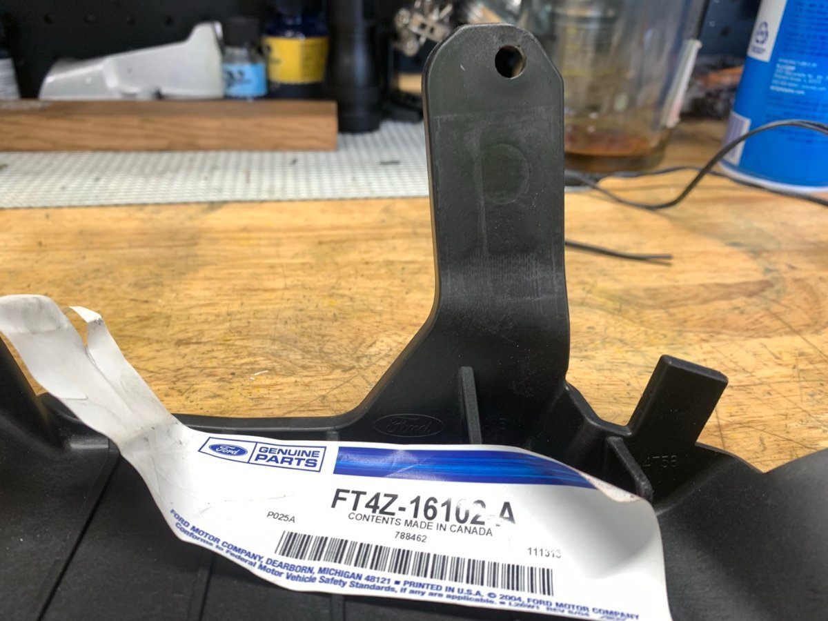

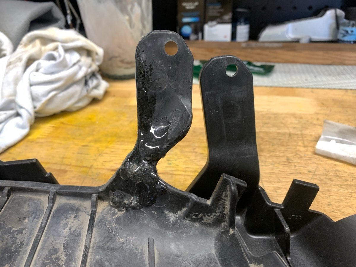

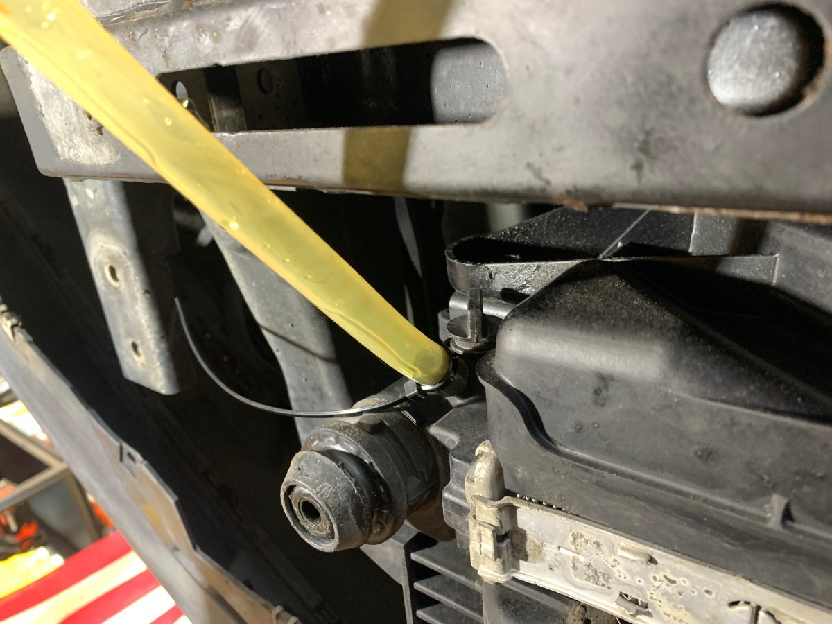

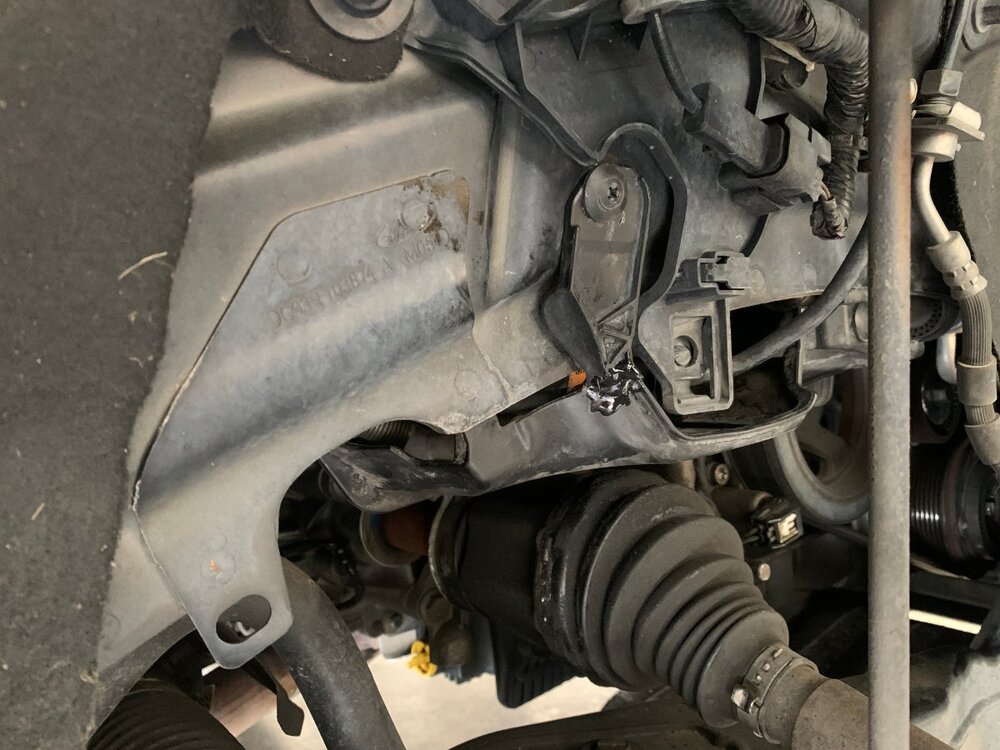

Quite a few weeks back during a monsoon rain I went through some fairly deep water and the flutter/rattle has been there since. Today I found that two of the plastic posts on the left and one of them on the right had popped out the body. Inserted them again and added thin cable ties between the felt shield and the plastic post. The plastic posts seen in the images @Haz posted look significantly different to the ones on my Edge - is there a later version available?- 91 replies
