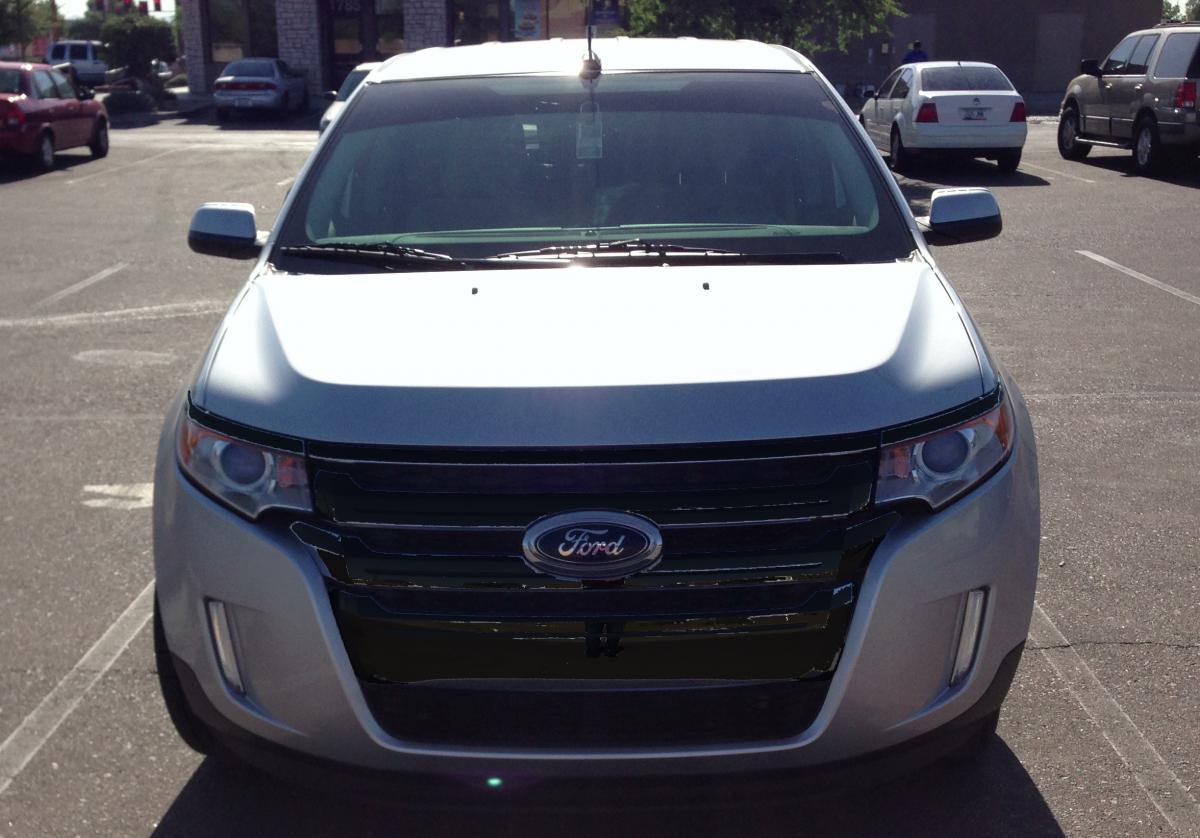

Has anyone done a matte grill and rims on a silver SEL? I'm considering plasti-dip for all the chrome front and back (including door handles) but would be great to see photos if anyone has done it. I did a little photoshop work and I think it looks pretty good.
Thoughts?

Looks good! I'd go for it
