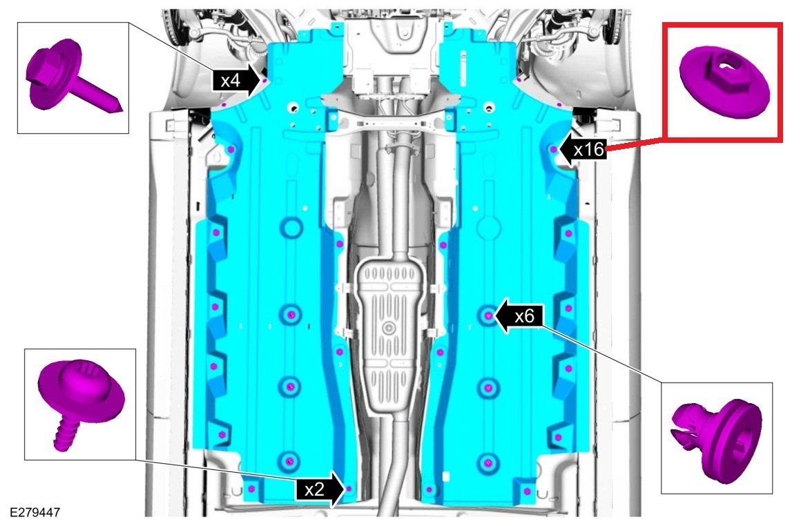

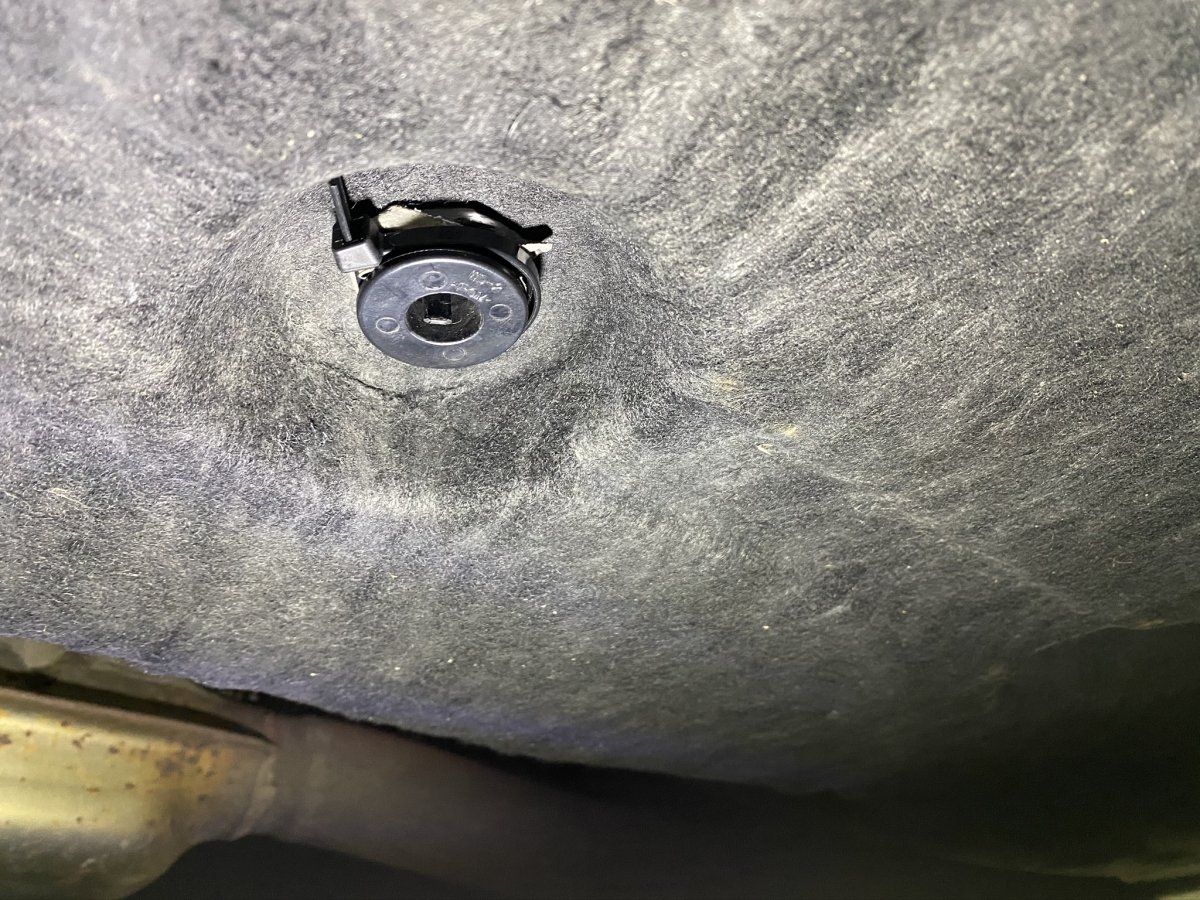

MrHappy Report post Posted February 11 (edited) Hate to revive such an old thread but this has happened to my wife's Edge ST for the second time now. First time was under warranty so the dealer replaced the passenger side. Now it's the back of the driver's side. (And out of warranty) Heard it yesterday, found this thread and expected to install a few zip ties on the plastic bits and be done. Instead, one of the washers and nuts belonging to the back outside metal screws sticking down has come off and is gone. For the life of me I can't figure out wtf size that metal screw sticking down is to get a properly fitting nut (and washer) to reinstall and thread lock. Anyone happen to know what nut is needed? Just to clarify, this the nut for the screw that is sticking downward from the undercarriage toward the ground. (Along the outside, in this case at the back of the driver's side shield just past the front of the rear driver's side door) The others along the same edge have a nut and washer in place (look metal) but are a bit rusty so I'm hesitant to remove them since they're solidly stuck in place and don't want to cause more problems than already exist. Edited February 11 by MrHappy 1 Share this post Link to post Share on other sites
1004ron Report post Posted February 12 (edited) They're pressed steel nuts. Maybe @Haz can identify them for you and where they can be bought. Edited February 12 by 1004ron 1 Share this post Link to post Share on other sites
enigma-2 Report post Posted February 12 "Pushnut" comes to mind. Should be able to find these (or something close) at Advanced Auto in their fastener display isle. Share this post Link to post Share on other sites
1004ron Report post Posted February 12 (edited) No, not a "pushnut" - its one of these: Self-Threading Nuts - Washer Type https://www.amazon.com/Dorman-Help-45384-Thread-Cutting/dp/B000COCTDK/ref=sr_1_3?crid=1P1YYZBZNSRU2&keywords=Thread+Cutting+Nut&qid=1676246531&s=industrial&sprefix=thread+cutting+nut%2Cindustrial%2C121&sr=1-3 Edited February 12 by 1004ron 1 Share this post Link to post Share on other sites
Haz Report post Posted February 13 From the 2019 Edge Workshop Manual... The stamped sheet metal hex nut is also described online as a speed nut. I was unable to pick off the fastener part number from FordParts.com, though a dealership parts staffer will likely find it. On the other hand, providing 1004ron's photo to a local or national-brand auto parts store or hardware store may provide the part quicker and cheaper. Good luck! 1 Share this post Link to post Share on other sites
