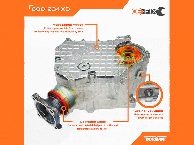

DILLARD000 Posted March 1, 2022 Report Share Posted March 1, 2022 (edited) Dorman now marketing "Upgraded" PTU for Ford AWD Vehicles, with Drain + HeatShield + BetterSeals. Click here for Video. Refering to part# 600-234XD; considering Dorman's reputation for quality is not stellar; anyone installed this & the result? Edited March 1, 2022 by DILLARD000 1 Quote Link to comment Share on other sites More sharing options...
