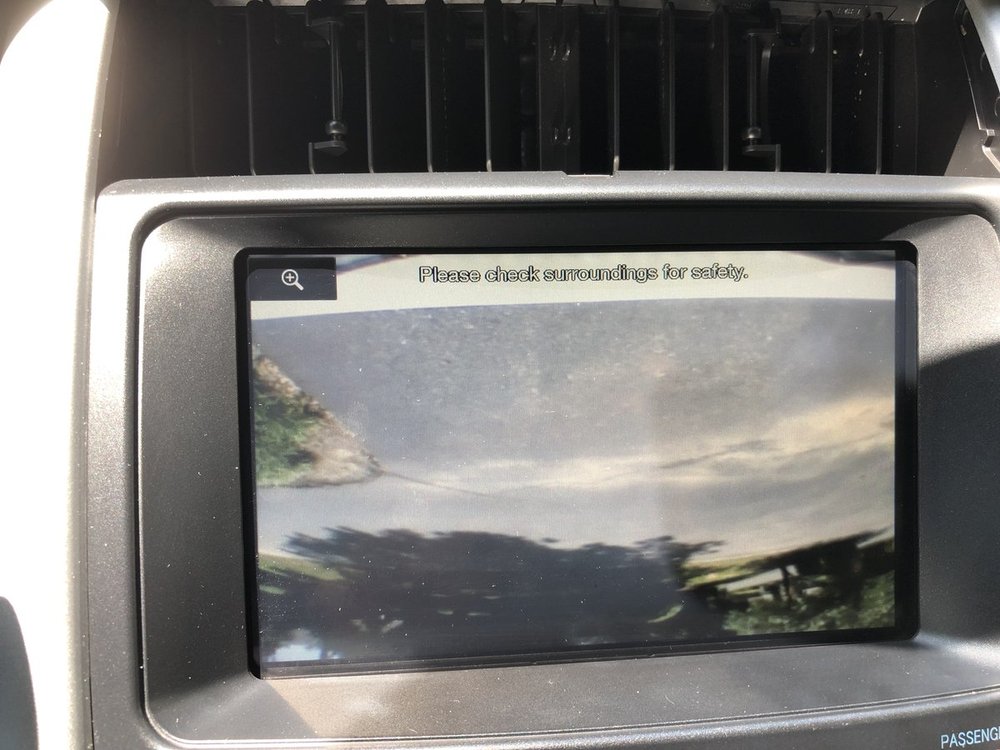

sblasl Posted June 10, 2019 Report Share Posted June 10, 2019 (edited) Hi Folks, Just purchased a 2011 Edge Sport. When the backup camera engages, the video on the screen is upside down (inverted). Every thing else is displayed correctly. Anyone have any thoughts on what is going on here and is there anything that I can do to resolve this without taking it to the Ford dealership? Thanks Edited June 10, 2019 by sblasl Add photo Quote Link to comment Share on other sites More sharing options...

sblasl Posted June 10, 2019 Author Report Share Posted June 10, 2019 9 minutes ago, omar302 said: The camera is probably on its way out. Changing it is the only long run solution. The picture displayed is just fine, it is just upside-down Quote Link to comment Share on other sites More sharing options...

candurin Posted June 11, 2019 Report Share Posted June 11, 2019 It may have been replaced with a non-ford (non-oem) camera. This has been a reported issue with 3rd party replacement cameras. Quote Link to comment Share on other sites More sharing options...
factor99 Posted June 11, 2019 Report Share Posted June 11, 2019 My 2011 has done that about once a year since new. II is the right way around when I restart the vehicle. I consider it due to flaky Ford engineering. Quote Link to comment Share on other sites More sharing options...

2FAST4U Posted July 26, 2019 Report Share Posted July 26, 2019 On 10 juin 2019 at 11:28 AM, sblasl said: Hi Folks, Just purchased a 2011 Edge Sport. When the backup camera engages, the video on the screen is upside down (inverted). Every thing else is displayed correctly. Anyone have any thoughts on what is going on here and is there anything that I can do to resolve this without taking it to the Ford dealership? Thanks The exact same thing happened on my 2011 MKX and unfortunately the only solution was to bring it to the dealer to have the camera replaced... Claude. Quote Link to comment Share on other sites More sharing options...
