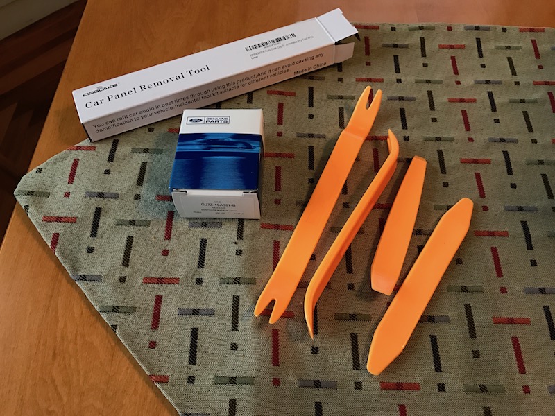

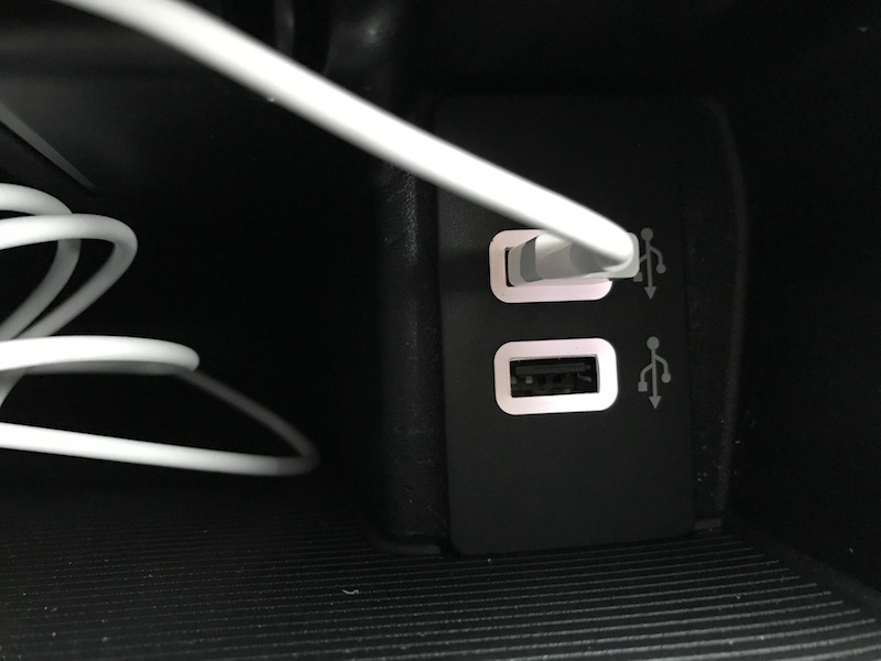

Well THAT (replacing the USB hub in my Edge so I could have Car Play) took longer than expected. Word to the wise who plan to swap USB hubs -- it looks deceptively easy. Pop out the old one, plug in the new one and pop it back in. With new trim tools and detailed advice from this thread and from threads on other forums, I thought I was ready, but that hub is in there really, really tight. I essentially had to destroy the old hub to get it out -- it came out in two pieces. (I'm fairly handy with tools, but I even called a local dealer and set up a Monday appointment to have them do the swap, just in case.) If you don't mind destroying the old hub, it's easier I guess. LOL. Fortunately, no damage to the cubby area, except the two little round bumpers in the front corners came out. Pix attached of the old and busted hub, as well as how the new one looks. Good luck peeps!
Edited by RedEdge16
wow what the heck did you do...remove the rubber mat, trim tool under easily accessible short end, pry it up a little so it pops out just a little then the tougher side since its right up against the edge and pop that edge out and viola comes right out. Probably have to hold the first side that popped out while doing the 2nd side so it doesn't fall back in.
You will have an almost impossible time if you try to pry it out by the long sides.
Edited by jmr061
Hey, jmr061. My mistake was starting with the left side rather than the bottom. The left side really didn't want to pop out, and when it finally did, the top edge seemed to bind. Once the bottom clip let loose, I figured I was good. But it kept slipping back into the socket. I used all kinds of tools, wedges, pliers, etc. to try and wiggle it free. Finally, since I figured I wasn't keeping the old one anyway, I used needle-nosed pliers to pull it loose. The front of the hub came off from the back (though the wires remained attached to the back). Once I unclipped the wires and re-connected things, it took about a minute -- though I did test the new hub before snapping it into place. A couple of bloody knuckles and a few choice words, all was well.
Edited by RedEdge16

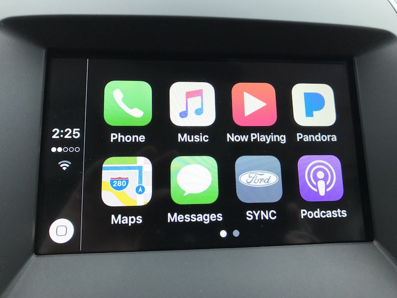

First of all, a HUGE THANK YOU to those who shared the files and helped the community out. I have a Lincoln MKC, and somehow stumbled upon this while searching for Carplay in 2016 Fords. I have the MKC 2016 with Nav, and I loaded the 2.2 update, flawlessly. At first when it comes up, SIRI is not there, nor is the NAV... After about 5 minutes it all reappears again, so don't panic.
I can confirm on the 2016 MKC you do need to purchase the USB ports. I ordered them from Mcsweeney Ford, it was about $62 bucks shipped, I ordered on Thursday and it arrived on Saturday. On the MKC it's very difficult to access the ports because they are inside of a compartment in the front, which makes larger tools difficult to use to try it off. Low and behold, Harbor Freight to the rescue, I found a little pick and hook set for $1.99 (YES THATS RIGHT JUST A DOLLAR NIGHTY NINE!). :)http://www.harborfreight.com/4-piece-pick-and-hook-set-66836.html
I used the little L shaped tool, and pushed it down into the middle center top of the usb and it popped right out. Keep in mind both wires attached to the USB are secured with little locking clips, so you need to use the little pick tool or a small screwdriver to push down on the little lock to release it and then gently pull the cables out. It was a snap, using the L tool, took me like 5 minutes.. Done.
Carplay in my Lincoln MKC, as promised by Lincoln, but delivered by myself, McSweeney ford, and some fabulous folks on this forum for sharing the update. :) Merry Christmas everyone!
Oh, and BTW, Carplay is a bit over rated if you ask me. You can only use Apple maps, not waze or google maps. Fortunately Apple Maps has gotten better. Spotify works as well as Iheartradio and Pandora. The spotify app is decent, but I like the Ford one better because it shows the cover art, the carplay one does not. Overall though, I think in areas where I'm really unfamiliar the apple maps/carplay display will be awesome. For my daily drive around town during rush hour, I will continue to use Waze because it knows which freeway is least congested.
Sounds like the Edge is a royal pain just like the MKC to get to the USB hub. I think if you had these it would have worked better. I originally purchased the larger "plastic" ones from harbor freight so i got these instead:
