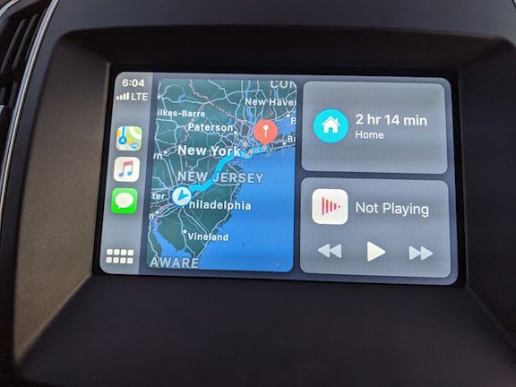

It's my understanding (I haven't actually seen it) that Waze works like a native app when an iPhone is paired with Sync I.E it just appears in the 'Apps' screen along with Pandora, Ford Pass etc.  Android phones (as mentioned) need a cable for that experience.  Ford has promised Android users would also have wire free Waze for their systems so I'd hoped V3.4 would offer that.

Yes, Waze works under Applink (it replaces the sync navigation when connected) which is separate from CarPlay and AA.

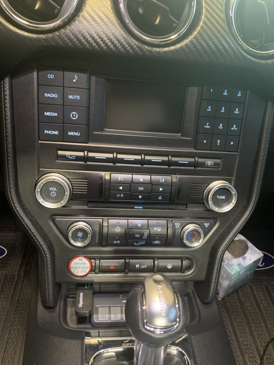

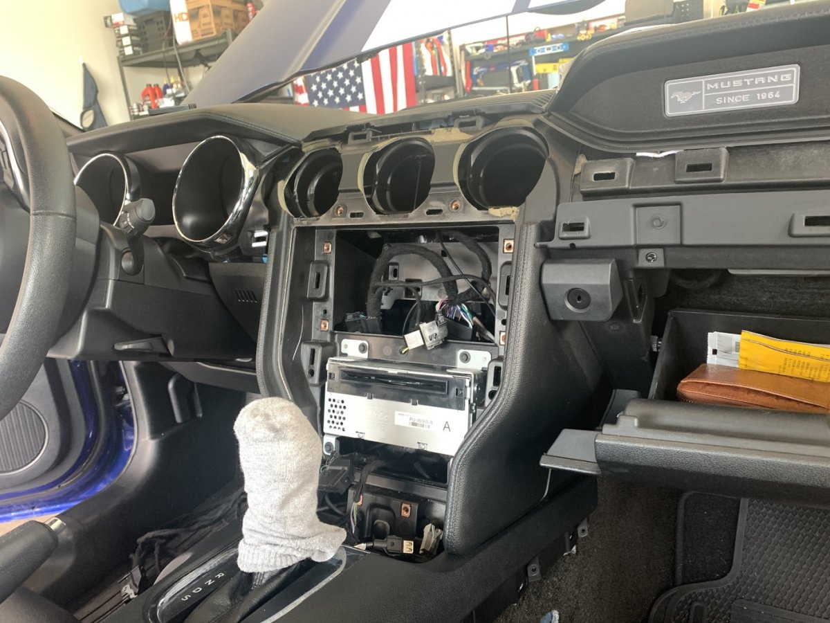

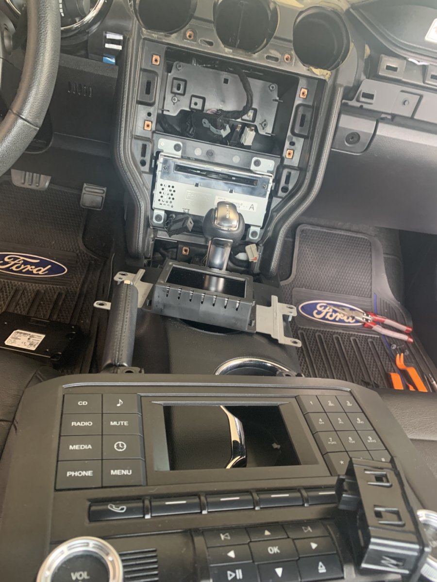

As @onyxbfly said, you'll need a whole more for that upgrade - I'm currently doing this on my wife's 2015 Mustang.
https://www.mustang6g.com/forums/threads/sync-3-swap-its-all-in-here.82973/
Completed the Mustang upgrade this weekend.

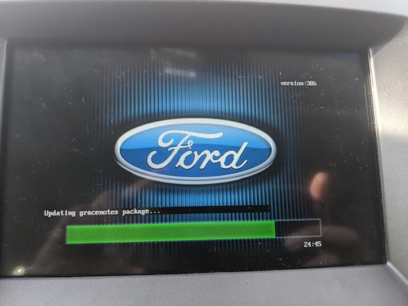

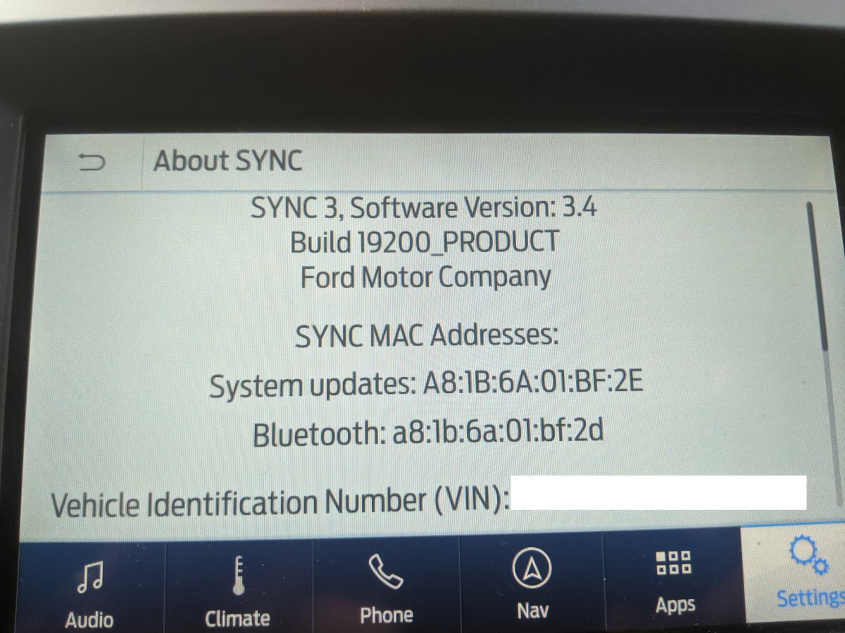

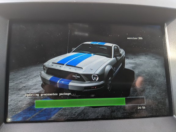

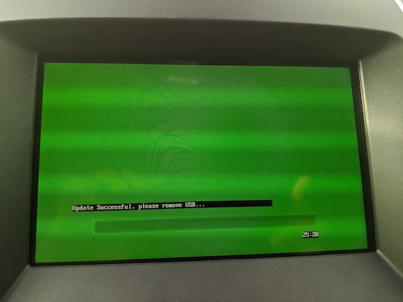

Used that new simple method today and it worked great.
Took about an hour to download and write to the USB drive, and 25 minutes to update the car.
I'm now on Sync 3.4 and maps updated from NA 1 18 to NA 2 20

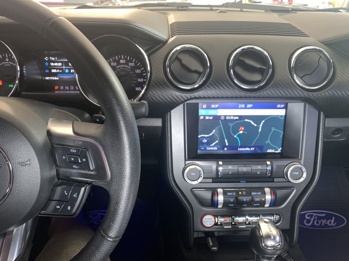

The new NA 2 20 maps need some custom tweaking.
On the ride to work it routed me on secondary roads, very curvy and in places only single car width, so in spite of it selected to "quickest route", it added 8 minutes to my work commute.
Still haven't found the selection to avoid the secondary roads - suggestions welcome.
