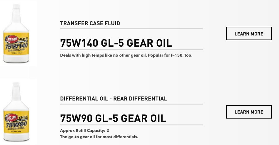

todd92 Posted October 9, 2020 Report Share Posted October 9, 2020 Redline recommends 75W-140 GL5 Gear Oil for the PTU, NOT Lightweight Shockproof. I ignore his videos. Quote Link to comment Share on other sites More sharing options...
WWWPerfA_ZN0W Posted October 10, 2020 Report Share Posted October 10, 2020 He does have Blackstone Labs test the used fluids, if that is any comfort. Also, get on the phone with Redline, see what they have to say. You won't get the full story any other way. Quote Link to comment Share on other sites More sharing options...
1004ron Posted October 10, 2020 Report Share Posted October 10, 2020 The product manufacturers web site specifies 75W140 GL-5 Gear Oil for the specific model discussed here. https://www.redlineoil.com/find-products-for-my-vehicle 1 Quote Link to comment Share on other sites More sharing options...
todd92 Posted October 10, 2020 Report Share Posted October 10, 2020 Why would I call Redline? Do you think they will say "ignore what we recommend, and use this instead'? He has no idea how to interpret oil analysis results. Quote Link to comment Share on other sites More sharing options...
WWWPerfA_ZN0W Posted October 10, 2020 Report Share Posted October 10, 2020 Just a suggestion If you like gathering data, you can then decide for yourself if it is information to you or garbage. No worries. Quote Link to comment Share on other sites More sharing options...
1004ron Posted October 10, 2020 Report Share Posted October 10, 2020 Lets not get personal - the OP may have a legit reason for his choice. Quote Link to comment Share on other sites More sharing options...
macbwt Posted October 10, 2020 Author Report Share Posted October 10, 2020 Apparently the video was not viewed and some respondents completely missed the FORD Gear oil recommendations. The 2019 Edge PTU is not the same PTU as all of the previous PTU's Ford Reduced the gear oil viscosity needed for the PTU. I posted this in the video directly from the Ford Ownership manual in the video. Please look before you leap other wise you may hurt yourself. Oh an I have tested the gear oil as my expense. I test both used and new gear lube. I have also personally had written and verbal communications with Phillips/Red Line oil company. So what you say my just be an opinion vs my facts and data. Every one has an opinion some good some bad. Shrill voices tend to eventually be ignored. 2 Quote Link to comment Share on other sites More sharing options...
todd92 Posted October 10, 2020 Report Share Posted October 10, 2020 Redline has an error for the 2019 Edge only, they are still specifying 75W140 GL5 Gear Oil. Redline specifies 75W85 GL5 Gear Oil for the 2020 Edge, and this should be the recommendation for the 2019 Edge also, as this is the year the PTU was changed. To be clear: 2015-2018 Edge 75W-140 GL5 2019-2020 Edge 75W-85 GL5 I'll just leave this comment from Redline on the the use of their ShockProof Oils: "Red Line ShockProof™ is designed for use in competition differentials and transmissions." Quote Link to comment Share on other sites More sharing options...
