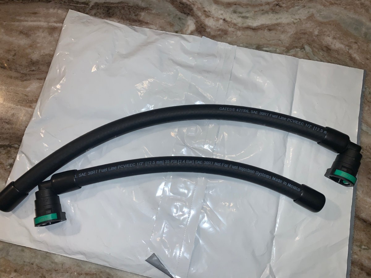

Hi, I figured out the gas odor. I was actually the JLT catch can hoses. I talked to JLT and they were great. They explained some people have that issue and they sent me a new set of a different type of hoses for free. I installed them and no more smell.

I sent JLT an email last night and had a reply early this morning. also a phone call -  they offered to send me a new set of hoses - amazing response from JLT.

Replacement hoses and fittings are on their way to me - I'll report back after I install it this weekend.

My replacement hoses were shipped on Monday and received them yesterday - they're installed but of course too early to confirm that its taken care of the smell.
