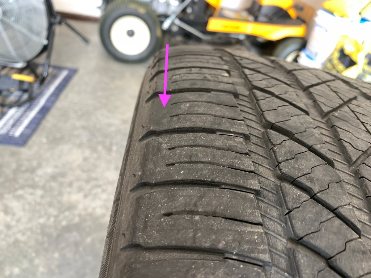

Reviving an old thread because the description is similar to what I've noticed on my 2017 Sport.
I haven't rotated tires for quite some time and this past weekend I notice wear in the inboard edge of both front tires - other than that all four are wearing very evenly.
See photos of the right front wheel.
What's your thoughts on the cause?
Also, where can I find the alignment spec for my 2017 Sport?
Also, my work colleague races his Corvette and just sold his string alignment kit and bought the Gyraline Alignment kit which he says he's very happy with - any first hand experience here?
How's your ball joints? Other thoughts include control arm bushings & driving on low tire pressure.
And as you mentioned, rotate your tires more often.

What brand of tires and what is the DOT code on the tire? It appears so
one likes to drive what some would consider a little "sporty". The shoulder wear (both sides)
indicates where the steel belt ends. If it was a toe problem, the edges of all of the tread
blocks would have a feathered edge on one side. But, the pics indicate small chunks are being shed while
at high steering angles.
In the top image it appears that a little extra wear is indicated by the right side being a little
more worn than the left. That would indicate about half a degree of extra camber to that side, providing
that is about 12 K miles in normal conditions on that tire.
Gary
