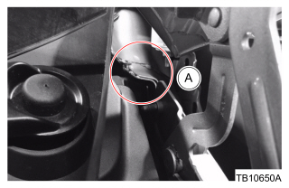

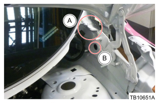

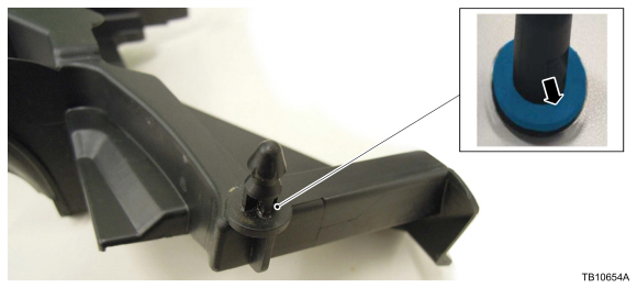

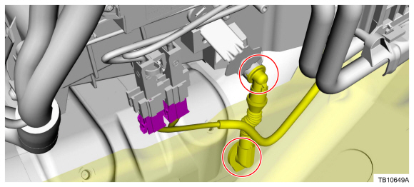

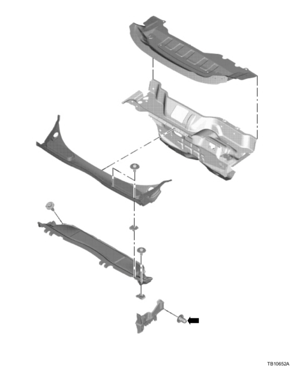

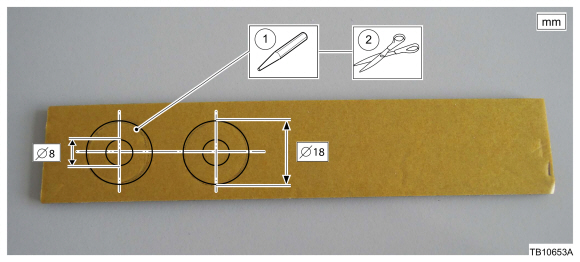

Eerily familiar??? TSB 15-0020 WATER LEAK INTO THE FOOTWELL Publication Date: February 20, 2015 FORD: 2014 Transit Connect ISSUE: Some 2014 Transit Connect vehicles may exhibit a water leak into the driver and/or passenger side footwell. ACTION: Follow the Service Procedure steps to correct the condition. SERVICE PROCEDURE 1.Is water leaking into the passenger footwell? a.Yes – check the evaporator core drain tube and reattach the evaporator core drain tube if loose. Proceed to Step 2. (Figure 1) evaporator core drain tube Figure 1 - 15-0020 b.No – proceed to Step 2. 2.Is water leaking into both the passenger and driver foot well? a.Yes – proceed to Step 3. b.No – this article does not apply. Refer to Workshop Manual (WSM), Section 501-00. 3.Open the hood. Refer to the circled areas. (Figures 2 and 3) Figure 2 - 15-0020 Figure 3 - 15-0020 4.Apply Motorcraft® Seam Sealer or equivalent to the gap between the fender apron panel outer reinforcement and the A-pillar on both sides. (Figures 2A and 3A) a.Allow the sealer to dry for two hours. 5.Seal the hole on the body by adding an O-ring to the instrument panel support assembly retainer, on both sides of the vehicle. (Figure 3B) a.Remove the cowl panel. Refer to WSM, Section 501-02. b.Remove the instrument panel support assembly, both sides. (Figure 4) instrument panel support assembly Figure 4 - 15-0020 c.Use a PVC foam strip to cut out and fit an O-ring onto the instrument panel support assembly retainers. Inner diameter 8 mm (0.3 inches). Outer diameter 18 mm (0.7 inches). (Figure 5) Figure 5 - 15-0020 d.Thoroughly clean the surface and attach foam to the retainer. (Figure 6) Figure 6 - 15-0020 e.Reinstall the instrument panel support assembly and cowl panel. Obtain Part Locally Part Number Part Name 164-R4901 PVC Soft Foam Strips PART NUMBER PART NAME TA-2-B Motorcraft® Seam Sealer OPERATION DESCRIPTION TIME 150020A 2014 Transit Connect: Inspect And Seal The Body Following The Service Procedure (Do Not Use With Any Other Labor Operations) 0.7 Hr. WARRANTY STATUS Eligible Under Provisions Of New Vehicle Limited Warranty Coverage. Warranty/ESP coverage limits/policies/prior approvals are not altered by a TSB. Warranty/ESP coverage limits are determined by the identified causal part and verified using the OASIS part coverage tool. DEALER CODING BASIC PART NO. CONDITION CODE 5801610 68- 480 replies
