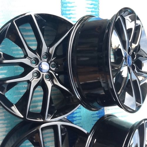

OK, I've changed my mind again (about using the black Interceptor wheels on my Edge)... only because I've now found a nice new set of black-powdercoated OEM alloy wheels that are a factory match to my vehicle... thereby eliminating any worries about using adapters, offset mismatches, etc. These babies should certainly "complete" the stealthy solution I was hunting for.
I have an appointment tomorrow, to have them swapped-out with my original 20" OEM rims. Will post pics after all is said and done, assuming everything goes to plan!
OK, I got my new rims on today, and they fit perfectly!
They were an exact match for the original OEM rims that came with the car, as far as diameter, width, hole pattern and offset, so there were no problems with fitment. I think they look pretty nice on there (and, ironically, my local UPS driver asked me about them when he came to deliver a package this afternoon... telling me he noticed the change when he first pulled up, and that the black look really looks great on the car).
Here's a first look...
