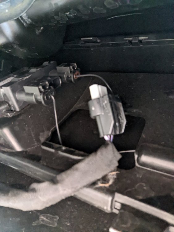

ed4pbay Report post Posted January 8 On 7/19/2016 at 9:29 AM, Waldo said: You can disable the liftgate through the settings menu in the left side of the instrument cluster. I realize this is an old thread, but on my 2016 SEL the settings menu for the power liftgate unfortunately doesn't disable the foot sensor. The door will still auto-lift but you have to manually close it. Rear exterior Latch button above the license plate seems to be the only thing deactivated. It will still power lift and close from interior dash switch. I want to disable the foot sensor when I use my trailer hitch bike rack attachment so the door doesn't bang into the vertical riser bar. It can get activated by a strap movement or your foot as you're moving around with the bikes. Anybody have experience disabling the foot sensor with the ForScan software and laptop? Share this post Link to post Share on other sites
