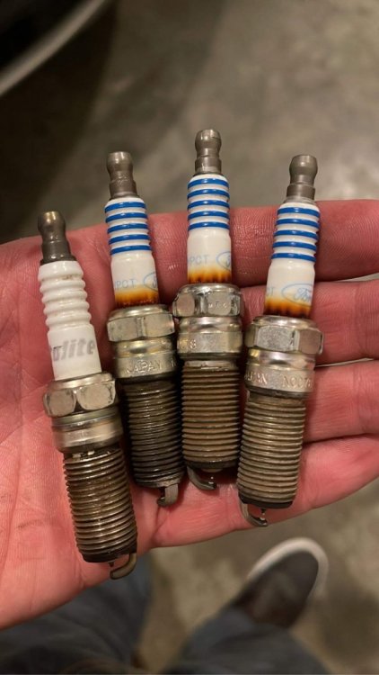

17Ville2.0 Posted October 1, 2021 Report Share Posted October 1, 2021 Just bought the car a week or two ago and had a couple small issues, the waterfall sound at startup and after a couple days’ driving it threw a P0301 misfire code on cylinder 1. Symptom was a rough shuddery idle the first ten seconds or so on a cold start then ran fine the rest of the time. Pulled the plugs and replaced with NGK Ruthenium’s, old plugs were pretty gross. Also cylinder one plug (far left facing the engine) was different than the others as you can see in the pic so someone saw the code before and just threw a single plug at it, no idea why you’d do that. Anyway installed the new plugs and cleared the code, also burped the coolant system and haven’t had the waterfall sound since. Car ran way better for a week or so then the same code came back so I’m thinking coil packs next, unless someone has anything else to try before I go to that. Thanks for any and all help! Quote Link to comment Share on other sites More sharing options...
handfiler Posted October 2, 2021 Report Share Posted October 2, 2021 Could be a faulty coil but I wouldn't rule out a faulty injector either. Quote Link to comment Share on other sites More sharing options...
17Ville2.0 Posted October 2, 2021 Report Share Posted October 2, 2021 Thanks a bunch for the reply. I’ll probably go ahead and replace all four coils anyway because why not at 70K, then if the issue persists we’ll go from there Quote Link to comment Share on other sites More sharing options...
1004ron Posted October 2, 2021 Report Share Posted October 2, 2021 35 minutes ago, 17Ville2.0 said: Thanks a bunch for the reply. I’ll probably go ahead and replace all four coils anyway because why not at 70K, then if the issue persists we’ll go from there Why? I have 71K miles on my Sport, and expect my ignition coils to last more than twice that - if the time comes, I'll only replace a component like that if testing confirms its failed. Quote Link to comment Share on other sites More sharing options...
1004ron Posted October 2, 2021 Report Share Posted October 2, 2021 55 minutes ago, handfiler said: Could be a faulty coil but I wouldn't rule out a faulty injector either. Correct, and some diagnostics should be able to identify it. Running a fuel system cleaner in a couple of tanks costs very little and can do no harm, and could clear a fouled injector. Seeing that one foreign incorrect spark plug makes me cringe, and conjurers up an image of a drunk redneck shade tree "mechanic" working on it - a clear sign that its been abused. 17Ville2.0 what's the mileage? Do you have the service record? Did you research its history on places like CarFax? Quote Link to comment Share on other sites More sharing options...
handfiler Posted October 2, 2021 Report Share Posted October 2, 2021 26 minutes ago, 1004ron said: Why? I have 71K miles on my Sport, and expect my ignition coils to last more than twice that - if the time comes, I'll only replace a component like that if testing confirms its failed. Good advice that I have followed for a long time. It's had a positive effect on my investment portfolio also. 1 Quote Link to comment Share on other sites More sharing options...
WWWPerfA_ZN0W Posted October 2, 2021 Report Share Posted October 2, 2021 as an aside, check to make sure the engine is not a 420 Cleveland engine. the label is on the passenger side of the valve cover. if it is, this may develop into a misfire/coolant loss/engine replacement scenario. 1 Quote Link to comment Share on other sites More sharing options...
17Ville2.0 Posted October 2, 2021 Report Share Posted October 2, 2021 (edited) It is indeed a 420 Cleveland engine. Didn’t know any of these issues until after we bought it of course. Also, it has lost a little coolant since I filled it up and burped it last. I’ve been doing some reading, are these engines prone to head gasket issues or something that leak coolant into a cylinder? I’ve bought many used cars before and did the same thing with this one that I’ve always done, checked the car fax beforehand which was clean, only two owners and lots of service records. Test drove just fine too of course, just really hoping this doesn’t turn into a major issue. Monday will be two weeks that we’ve had the car. Going to call the dealership on Monday and see what we can figure out. Edited October 2, 2021 by 17Ville2.0 1 Quote Link to comment Share on other sites More sharing options...
1004ron Posted October 3, 2021 Report Share Posted October 3, 2021 Do a forum search. If its the Cleveland engine with those symptoms the solution is not simply a gasket replacement, but an engine replacement. 1 Quote Link to comment Share on other sites More sharing options...
