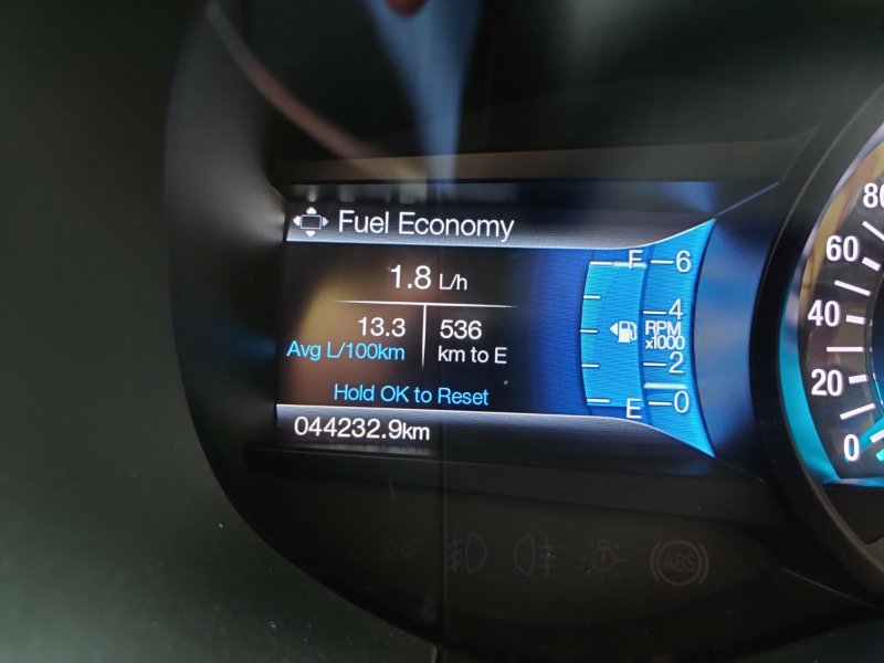

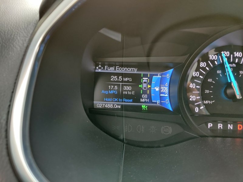

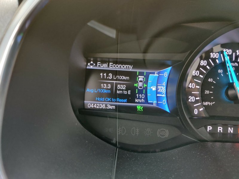

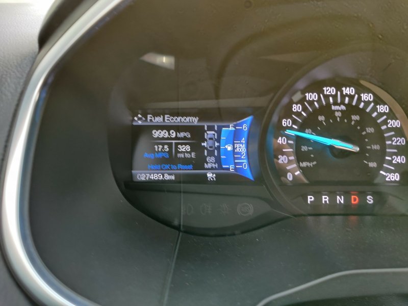

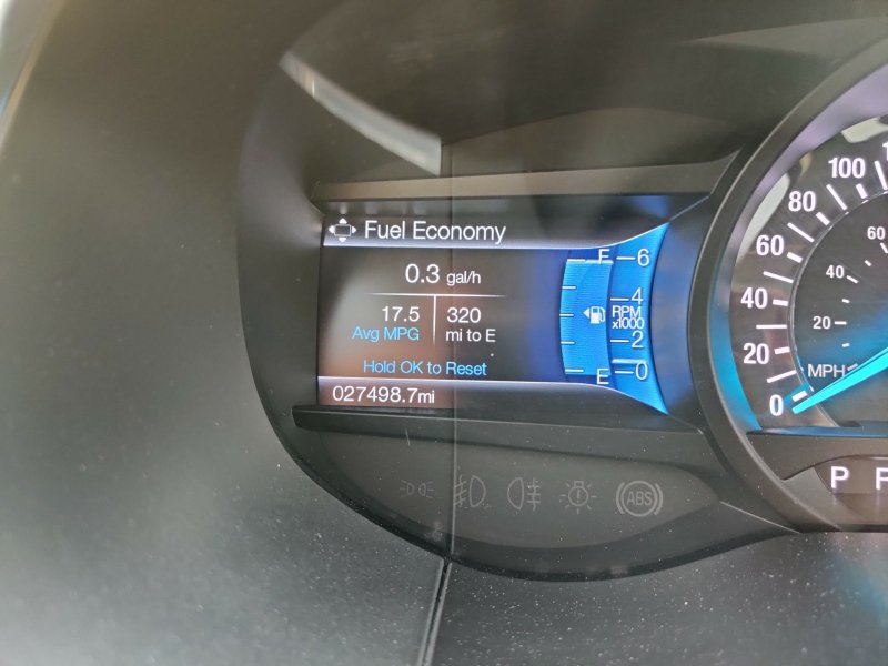

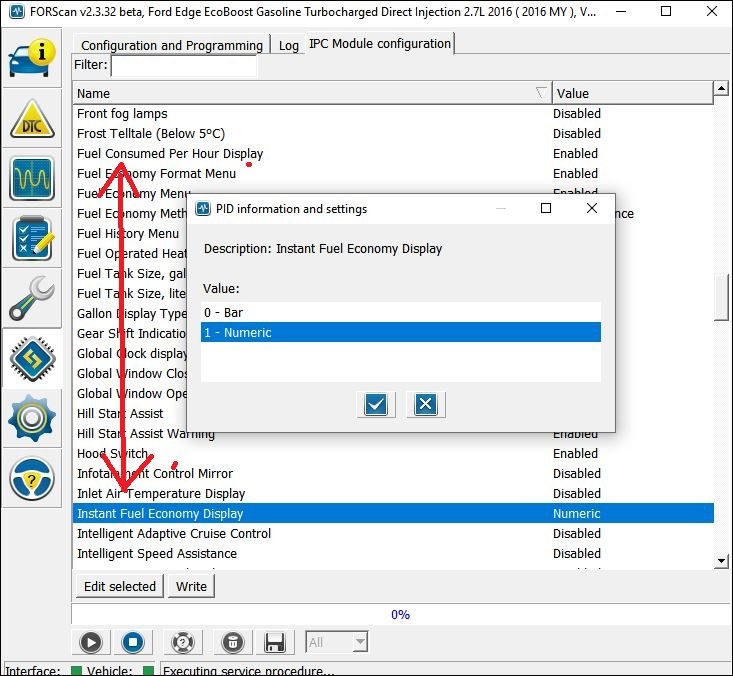

omar302 Posted June 8, 2021 Report Share Posted June 8, 2021 (edited) Found one more thing using the easy mode Instrument Panel Cluster (IPC) configuration, it will change the Low Fuel warning message. It is called "DTE Level Configuration", there are two settings: Distance Based algorithm, this will show the distance to empty km/miles with the low fuel warning, and (still not confirmed by testing edit June 12: confirmed) will show fuel warning based on the distance to empty (in my older Ford/Lincoln it used to be at exactly 80 km to empty). Edit June 12: Low Fuel warning will now come at 80km, 60km, 40km, 20km then turns red at 0. or Fuel Level (Volume) Based algorithm, this will NOT show the distance to empty km/miles with the low fuel warning and the low fuel warning comes at random distances to empty, usually at very low km. This was the stock in my 2016 Edge. Edited June 12, 2021 by omar302 Confirmed the distances. 2 1 Quote Link to comment Share on other sites More sharing options...
