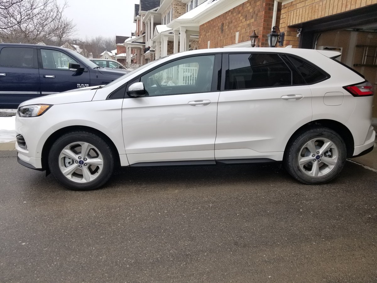

ST with regular brakes is good with the OEM SE rims & tire size. Picture posted in an earlier response on this thread. Been running on them all winter with no issues.
Upgraded brakes are same size with identical calipers so either way they should work fine.
