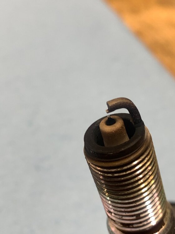

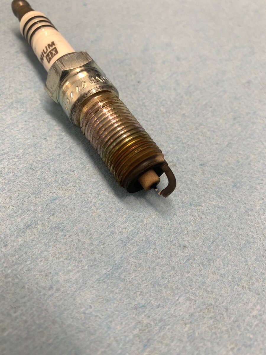

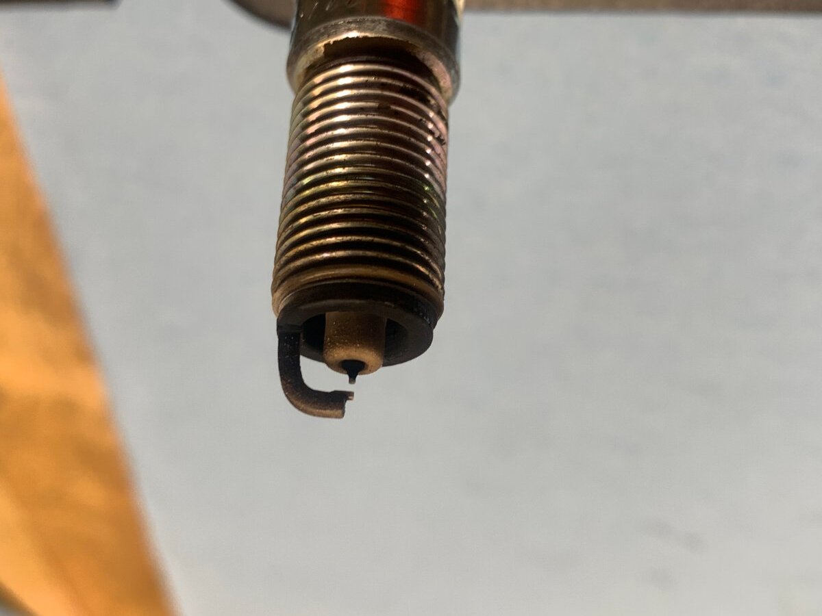

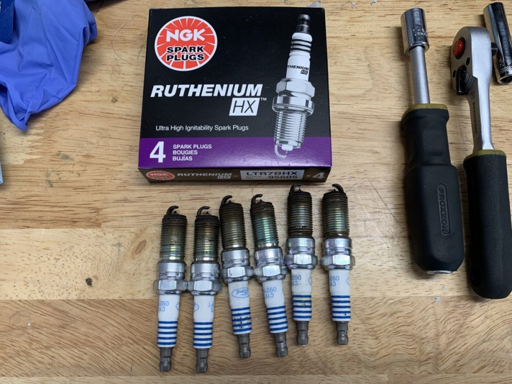

Today I decided to install the NGK 95605 Ruthenium HX plugs that I bought recently, .....not because they needed changing at 62K miles, but because I'm a tinkerer and and having the new plugs gave me itchy fingers.
Plugs bought from Rockauto.com for $53 shipped.
The original plugs would easily be good for 100+K  miles and all their gaps were a snug 32 thou.
With the plugs out looking down on top of the pistons they are so clean I could read the numbers on their crowns - my Edge only gets Costco Top Tier premium.

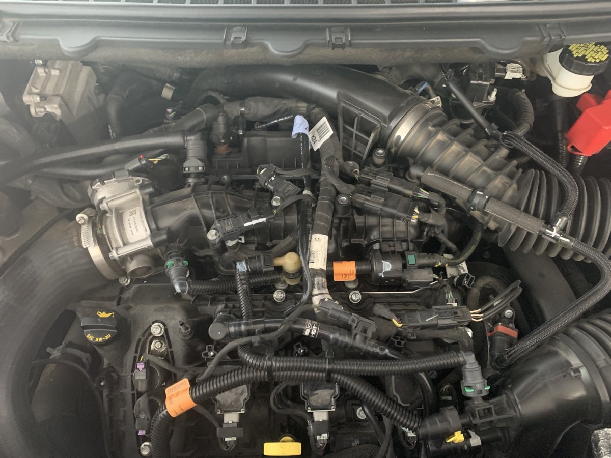

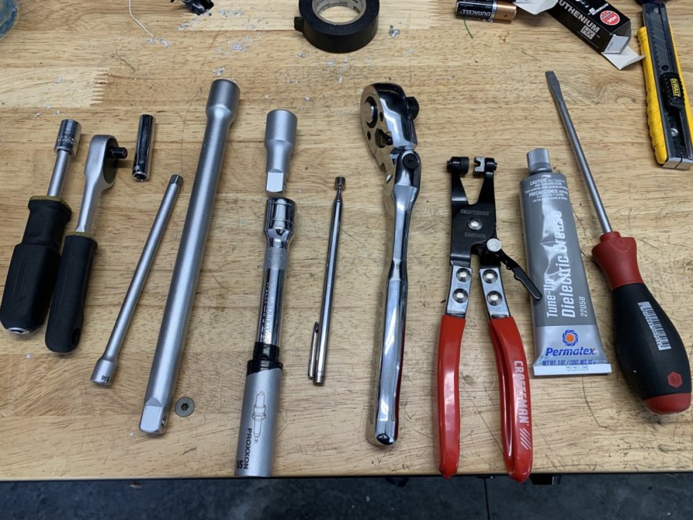

The job took just over 4 hours, which includes a trip to Lowe's to get additional 1/2" drive socket extensions.
The rear plugs are a challenge - I did not remove the air tube coming up from the rear turbo and it would be easier with that out of the way. I removed the flex rubber tube connecting it to the air filter housing and pulled it to left and right to get the two plugs that it obstructs.
For the rear plugs you need to secure the plug socket to a 5" extension and once inserted down the tube and onto the plug then place the 2" or 3" extension onto that, and then a ratchet with pivoting head - this is due to the restricted head clearance.
Added a little dielectric grease to the rubber ignition coils tubes to prevent them sticking to the plug porcelain part of the plug.
I'm not a good technical author, so feel free to ask questions if you plan on this DIY.
Excerpt from the service manual.
Ignition Coil-On-Plug.pdf
No anti-seize used on the plug threads as per the manufacturers recommendation.
https://ngksparkplugs.com/en/resources/5-things-you-should-know-about-spark-plugs
The pictures and links more than make up for it. A salute to tinkerers everywhere! ?
  • Like 4
12 hours ago, WWWPerfA_ZN0W said:
Did you gap the old/new plugs? Ecoboost plugs don't like much gap growth before starting to show signs of wear, compared to those for NA engines.
The old plugs gap was still spot on at 32 thou, and I checked the new NGK plugs and they were closer to 30 thou and I left them at that - no gapping done.
BTW, I also changed the plugs  in my wife's NA Mustang 3.7L V6 this weekend using the NGK Ruthenium HX plugs. It has 65K miles on the clock and I'd say that it was due for replacement plugs due the gap growth which is 50 thou to start with new - although it requires removal of the intake air plenum its a much easier job.
Edited by 1004ron
  • Like 3

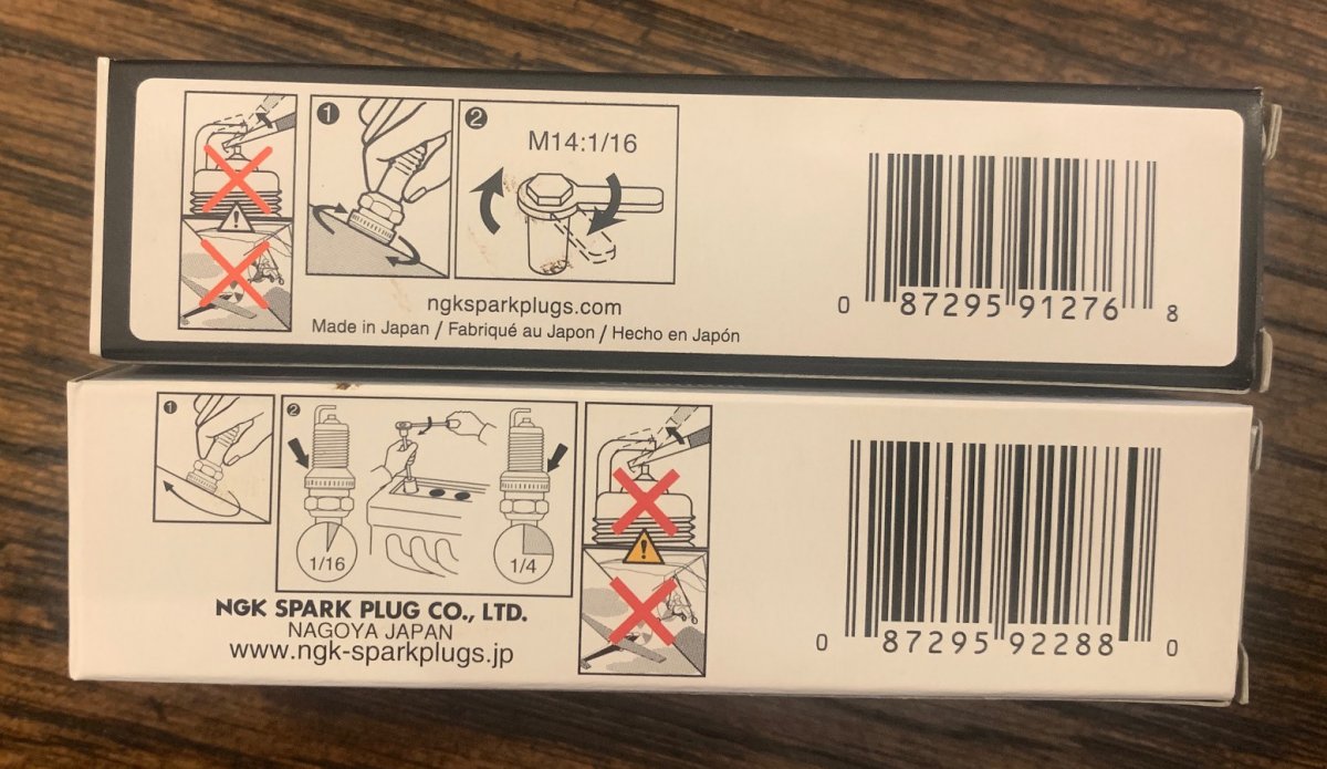

4 hours ago, Tlaner30 said:
What torque did you tighten the plugs to?
I don't use a torque wrench on spark plugs, but would advise following the tightening instructions on the NGK packaging, which is specific the the plug and its seal arrangement.
The top image is for the NGK 95605 Ruthenium HX plugs
Edited by 1004ron
Added image
  • Like 2
