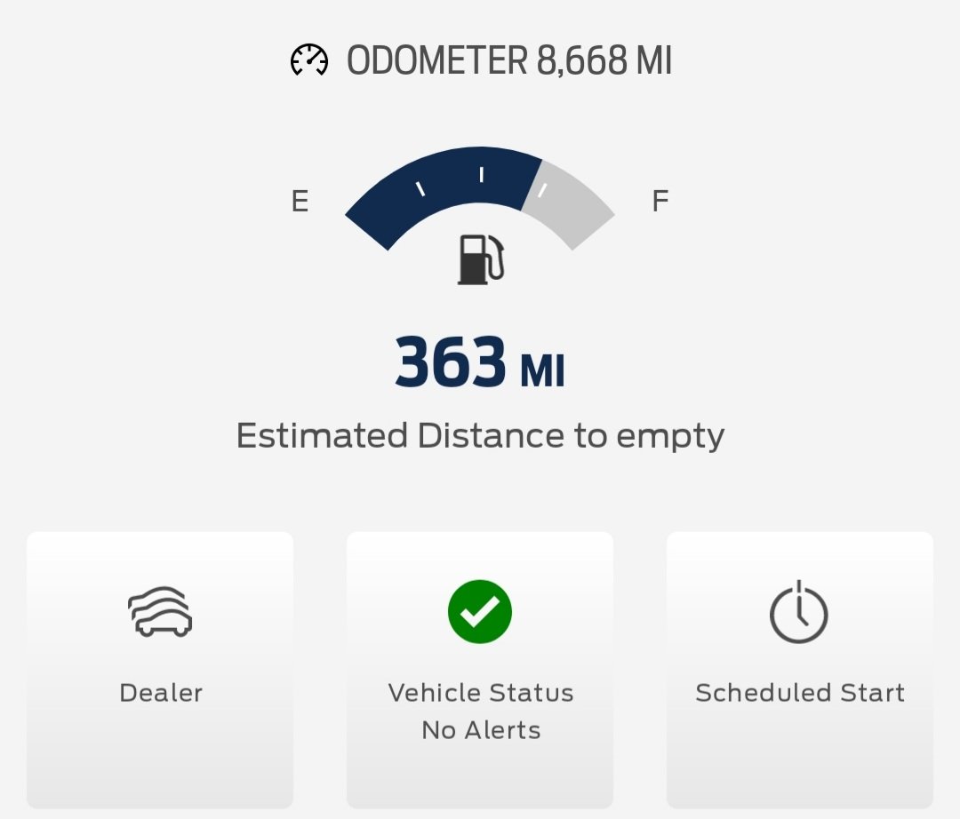

WWWPerfA_ZN0W
Need to do more Highway to get my tank average over 500 😏
When I was a kid they had what was called "The Mobile Gas Economy Run". It was a race (sort of) that the various automakers held the see who had the best gas milage. In an era where gas mileage averaged maybe 8 mpg certain cars, notably the Nash Rambler was posting in the mid 20's.
The drivers were taught to use certain tricks, such as maintaining a nearly constant throttle between 30-50 mph, avoid quick braking and rapid acceleration. (For the latter, they taught the divers by placing a raw egg between the bottom of their shoes and the accelerator pedal. They could not break the egg during acceleration and breaking.)
Same is still true today. To get great gas milage, slow, constant acceleration, anticipate breaking and maintaining a constant speed under 50. Boring I know, but you could try it as an experiment and see what your car can get above 500 miles.

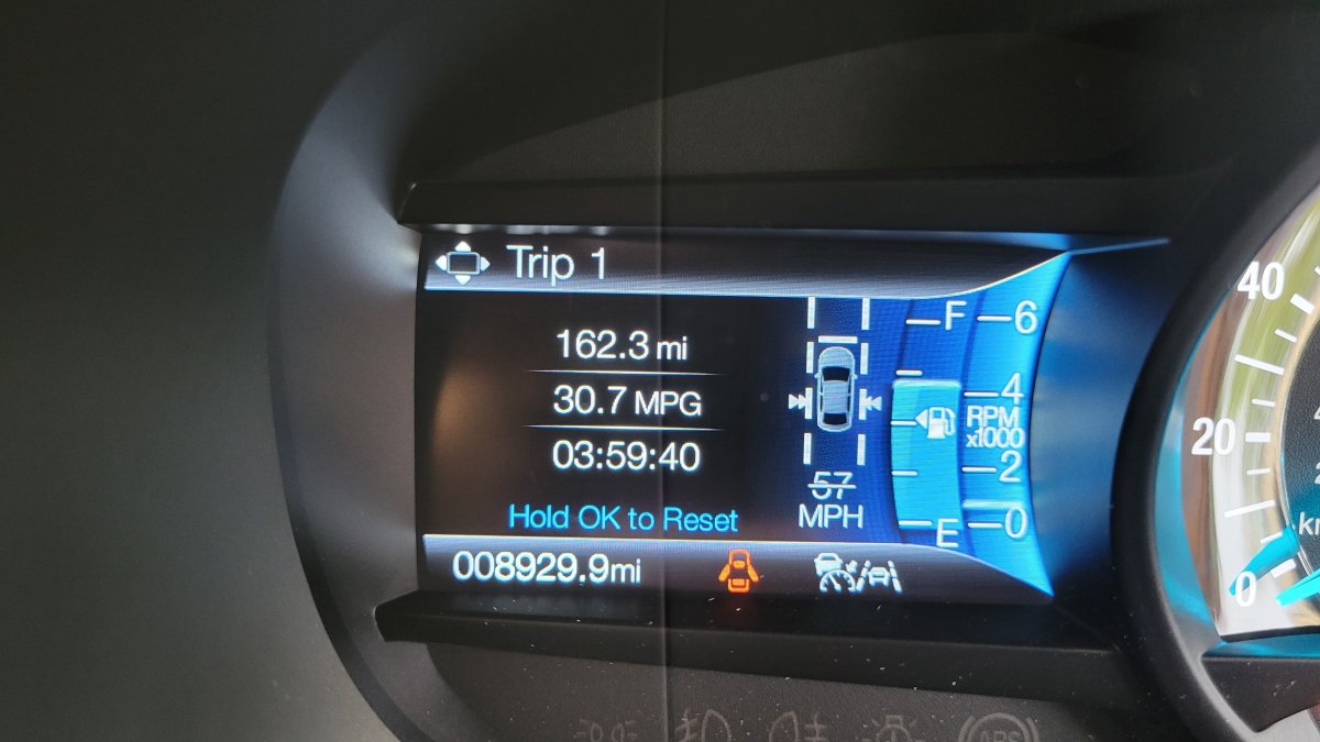

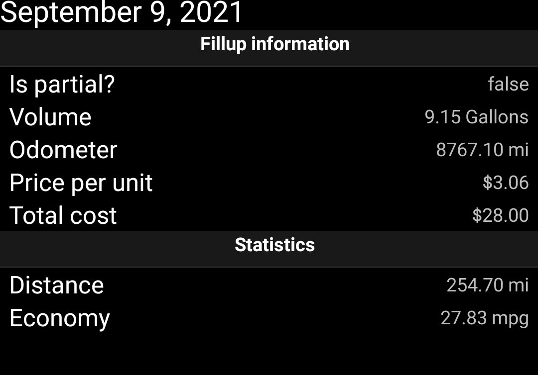

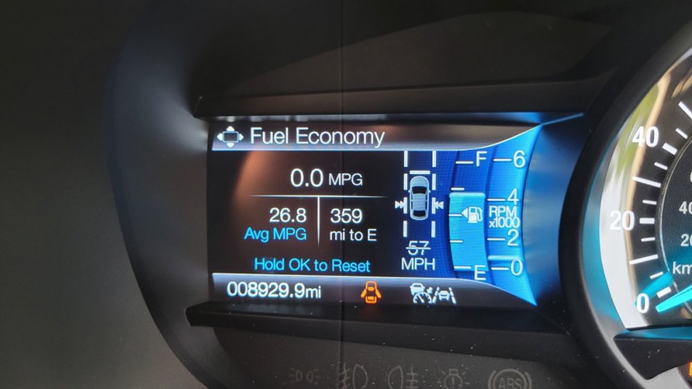

The sweet speed range seems to be around 50-60 mph (believe that it doesn't get into the last gear till 60). Highway runs above 70 seem to kill my mpg's to around ~26 (depends on headwind & hills) on a trip down to Florida I got 29mpg 😁
Currently around 156 miles on this tank. If I rode the tank around 60mph, I'd get over 500 miles on this one 🥳

Wife said that we're taking a mini road trip tomorrow so the latest tank got interrupted....
Pretty decent

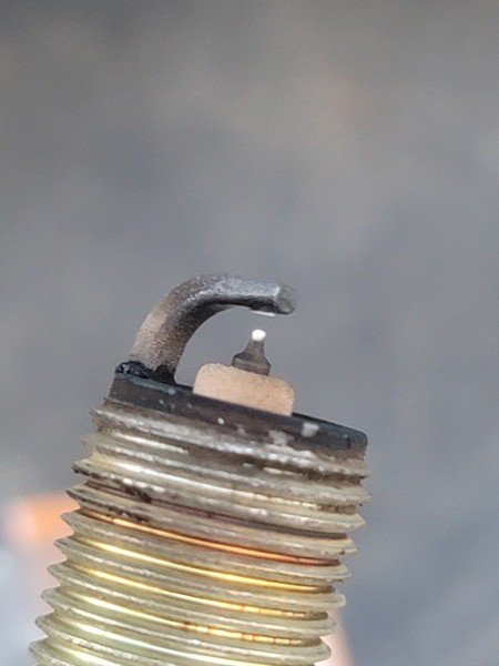

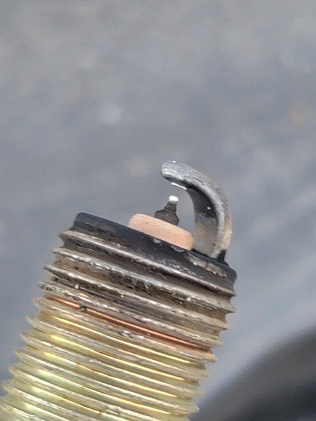

I I finally got around to changing Some of my sparkplugs.. lol
2 hours after driving home, the engine was still pretty warm and i was already losing daylight fast, so I just did the forward bank (#4, 5, & 6)
Lets just say i long for the day when the biggest problem was getting straight on an angled plug close to a header..
Holy spiderweb of wiring and vacuum / vapor pipes.. and this is the easy part.
The rear bank will be real fun
Anyway, 65K miles and the plugs I changed were at 30-34 thousandths, while the new NGK Rutheniums were gapped at .029ish right out of the box
