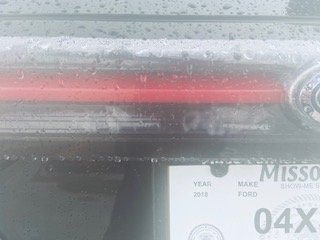

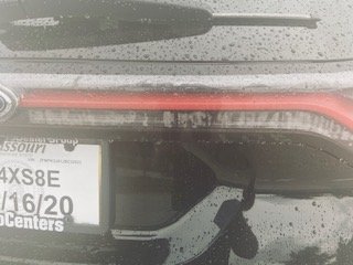

I just bought my 2018 Edge with 30,000 miles on it. I noticed there was some condensation in the tail light bar and asked the dealer to fix it. They said it was cosmetic and wasn't something they would fix. After a lot of research I have found it is very common. I attempted to remove the moisture over the weekend using the advice I had found online. The moisture came right back! I've been told it isn't covered under warranty and the Ford dealer told me they are aware of the problem and they can evaluate and document the issue for $200 and if a recall is every issued then I would be notified. My light bar is also not lighting up now. I assume it is supposed to? Any advice on getting the moisture issue resolved and why my light bar isn't lighting up?
Who did you buy it from?
You say that at the time of purchase you noticed the condensation and the seller said that they would not fix it - that was the time to stand your ground and insist it be fixed, or walk away.
You say you did some research - did that research include this forum?
What method did you attempt to remove the moisture?
It's still under warranty so call Ford Corp. and open a warranty claim with them, or try another dealership.
The light bar not lighting up - not all the models do, what model do you have?

You have a SEL. Your light bar will not light up because its not designed too. The only edge with the light bar is the Titanium and the Sport model.
