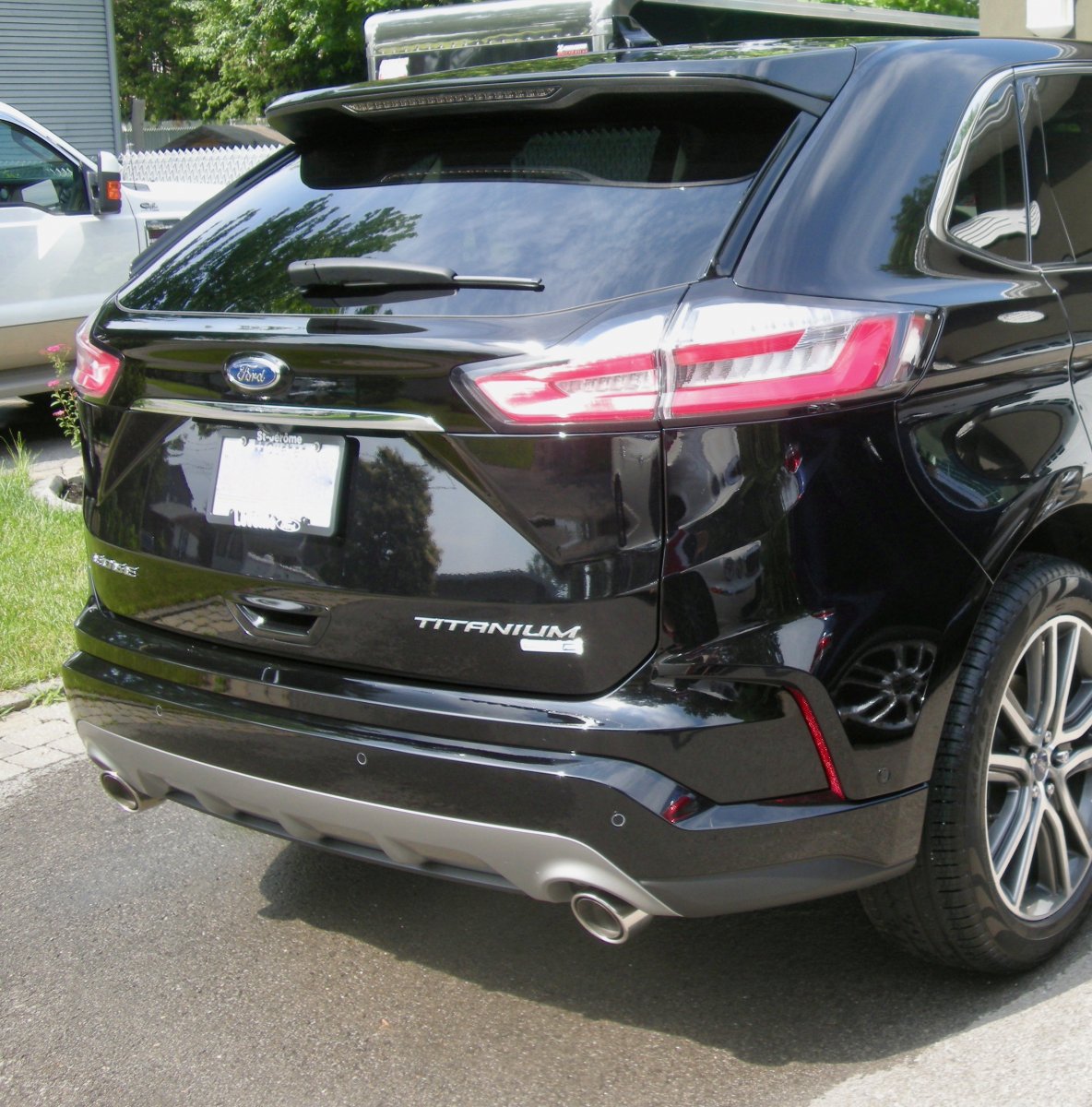

Maybe that's why they eliminated the full tail lights on 2019 ,now has a black plate across rear hatch.
Maybe...but you know what?... I had a '16 Titanium with the lighted full width taillights and when I sold it to buy my '19 Titanium, at first I was disappointed not to have them anymore but now, I wouldn't want to go back to the full width 'cause I now prefer the new taillights from '19 and up. Also my Edge is black so the "black plate" blends in very well and goes practically unnoticed and look like it's part of the body.:2thumbs:
