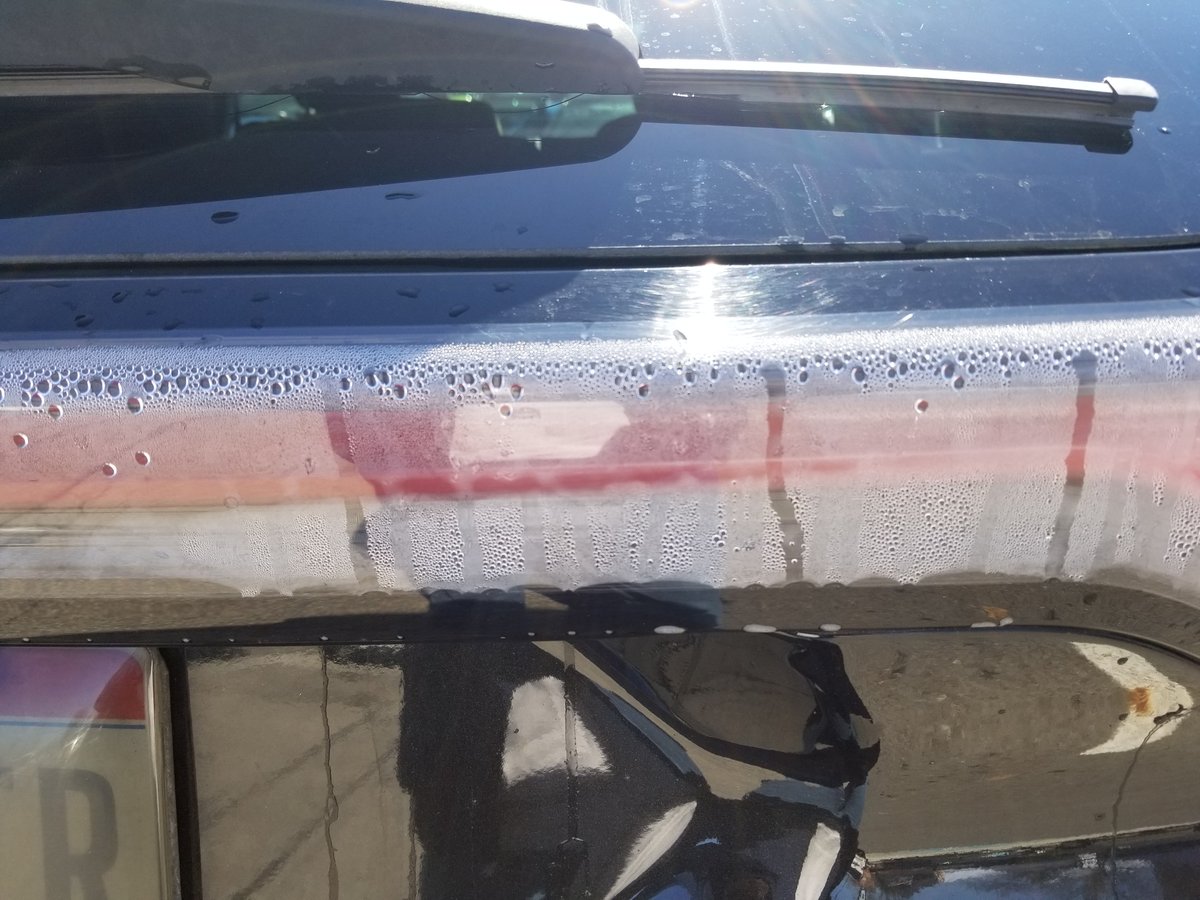

BTW - does anyone know a model year for the gen2 Edge where the lights were "fixed" i.e. didn't have the chance of this heavy kind of condensation? Or, did the Titanium lights (the full LED ones with the LED marker bars) not have this issue? Replacement parts for the bar housing are ranging from $750-980 (standard vs full LED) and $550-750 for the brake light housings. However if the full LED ones didn't have this issue, I'd be sorely tempted to buy those to eliminate this issue in the future.

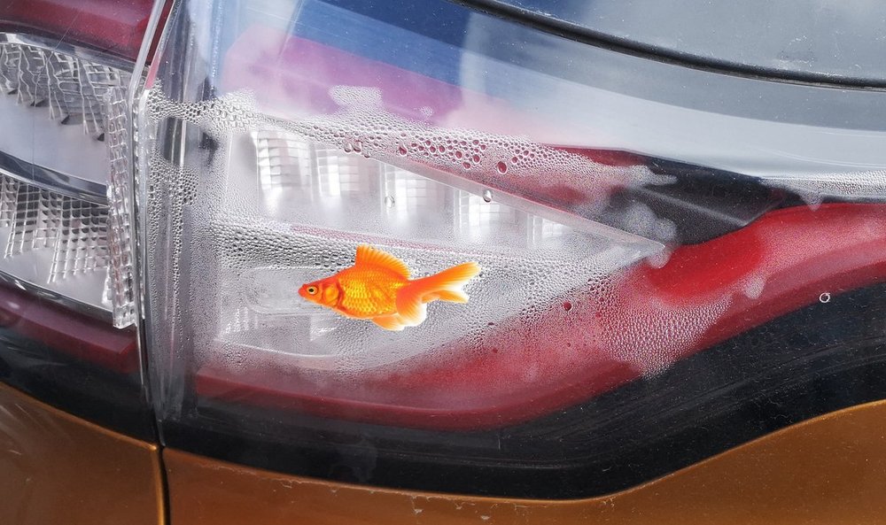

I am now having the same problem affecting my 2015 Edge Sport. I went to the dealer before the winter of 2018 and was given the condensation explanation for why there was mist/condensation in the taillights.  Now I'm 3 months out of the original 36 month manufactures warranty and of course, Ford does not want to recognize or admit to poor design which causes this problem.   I'm trying to enlist some help from my local news station to get Ford's attention.  If all else fails I will look into what it takes to file a class action suit.1587277060_FordEdge20190326_142353.thumb.jpg.4780308f084b371c5197fc468b008df2.jpg

I wish you lots of luck and hope someone will help you out.
I know the feeling all too well. You buy a new car and you want it to look nice.
Mine was a New 2016 Edge SEL, here is the light history.
Each time I had to fight tooth and nail and each time took around 2 months to complete.
In the course of 2 years, I had the signal lights changed under warranty (each side 3 times)! The light bar on the back of hatch which has the backup lights was replaced twice, once under warranty and the second time they said I would have to pay! When the job was done they waved the charges! I also had the headlights replace under warranty, they were not very bright and the lens looked dirty, they told it was spider cracks? Anyway, they were replaced when the car was about a year old. I'm done with Fords, the Edge will get traded off!

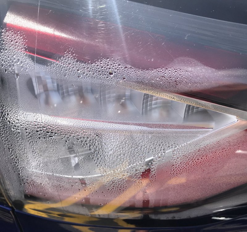

I bought a 2016 Ford Edge a couple of weeks ago, the condensation was there when I picked up the vehicle, I thought it would go away...2 weeks later the condensation is still there (see pics). When I contacted the dealership the manager said it wasn’t a ‘safety issue’ so they refuse to do anything about it. Do I have any recourse?
The owner's manual states what is acceptable. Drips of water are not acceptable if the vehicle is still under warranty it should be covered if, it is not it won't be. If the vehicle is still under manufacturers warranty the dealer should cover it if not call Ford. I was 3 months out of the manufactures warranty and had an extended warranty and it was still not covered.  Fortunately for me, the dealer recognizes that this is a problem and decided to cover half the replacement cost of the light and will install the replacement free of cost whenever I'm ready to deal with it.  I wouldn't be surprised if this problem results in a class action lawsuit because, in my opinion, this is a design problem that will eventually affect a lot of the Edges over time. Only time will tell.
